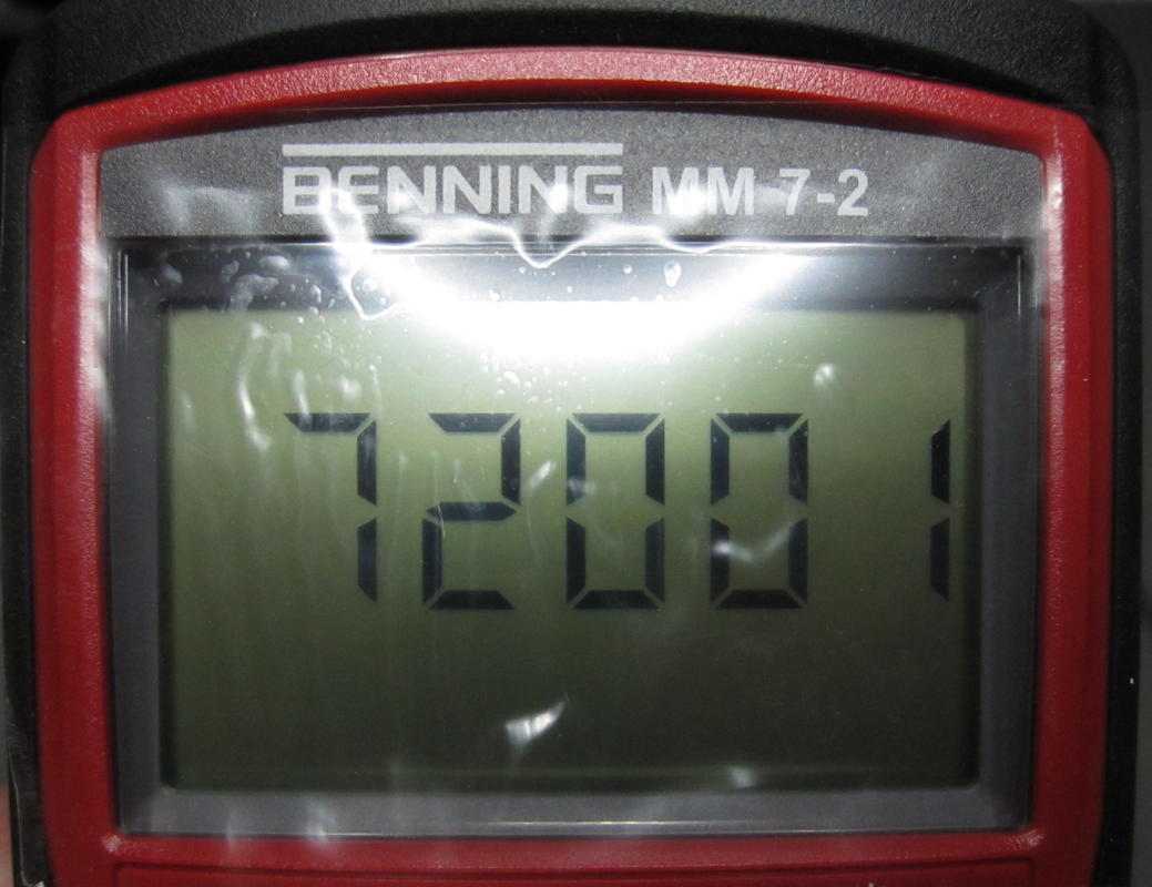

« Reply #305 on: August 10, 2022, 10:42:40 am »

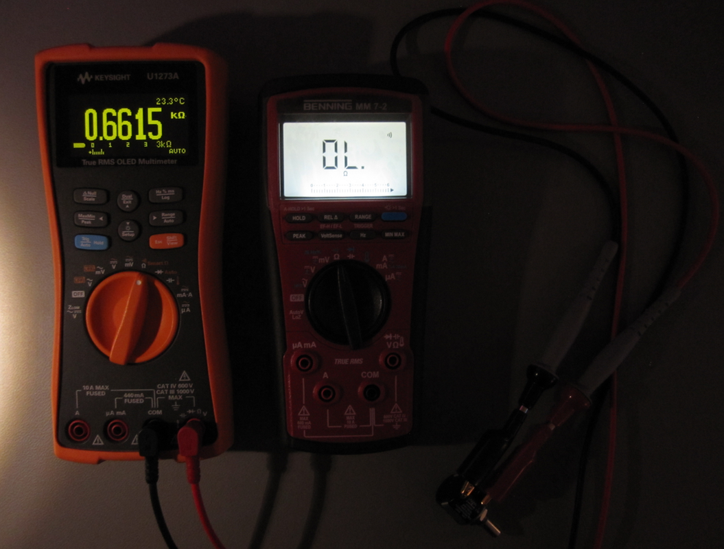

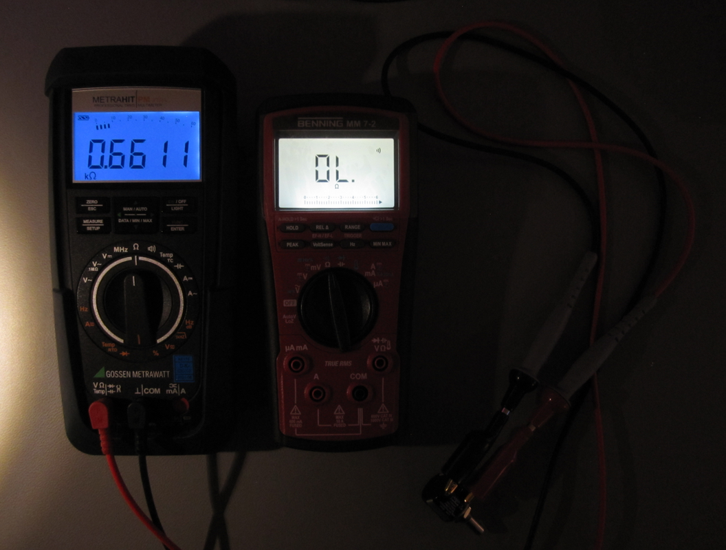

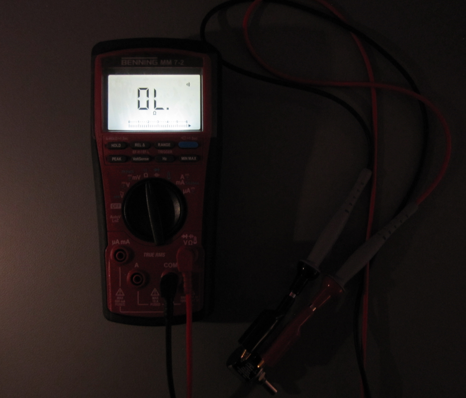

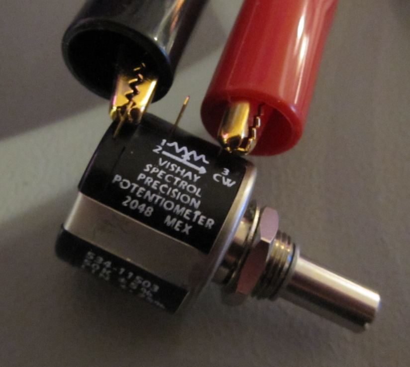

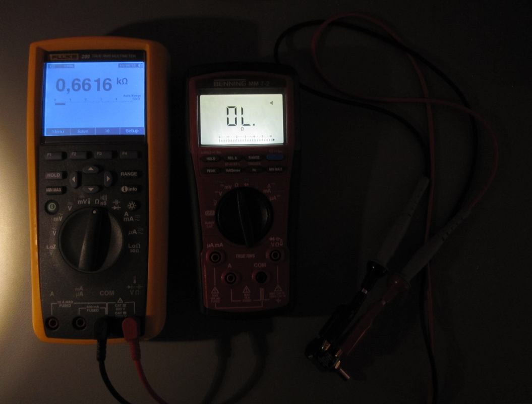

Unfortunately, the "new" Benning MM 7-2 with "FW 72001" has the same problem/bug:
I found the spot with my "Vishay Precision Potentiometer" immediately @ 661.x Ohm,....
....however, the MM 7-2 does not autorange for ever, but simply shows OL after autoranging (it is not as fast as the other DMMs).
When I pull the test leads out of the MM 7-2 and put them back in, it shows an interim value before going back straight to OL.
After that I only had to swap the test leads into the Fluke 289:
..., the Keysight U1273A...
foto fun kostenlos
...and the PM XTRA,...
...which have not any issue, showing the "right" resistance instantly depending on its precision.
...and back it goes...!  :popcorn:

« Reply #307 on: August 12, 2022, 10:18:23 am »
Seems like you were using the continuity function, not the resistance function instead ???

« Reply #309 on: August 12, 2022, 10:21:46 pm »
I am quite sure, that I was in Ohms mode, when I did my decisive measurement, as I saw different values, when I searched for the 660 Ohms region and have just forgotten to pay attention to the settings, when doing the photosession behind the other DMMs, after playing around with the buttons of the MM 7-2, which also keeps the last settings...
As I have already sent the Benning back home, I cannot repeat my measurement. However, as I don't want to ruin Bennings sellings, I hope that I was mistaken and quote the assumption of innocence for Benning with its MM 7-2 and their FW 72001, that they have paid attention to the mentioned bug, as they should know, which older Brymen-FW they use as their own first FW-Version "72001"...
Next time I will make a video for myself, having a better proof of concept, as I am also annoyed about my lousy documentation, but as I will not buy a Brymen/Benning again, maybe someone else is willing to repeat the test, because what I can definitely say is, that I am totally happy with my aleady bought handheld DMMs and don't see any reason to buy another one...  :)
