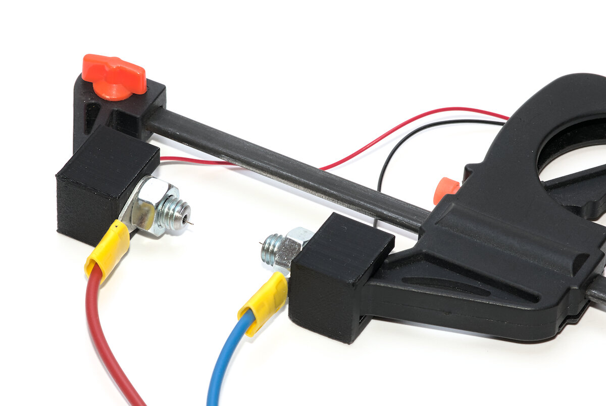

« Reply #566 on: June 12, 2026, 06:59:21 pm »
For better results you want each prong of the clips touch the battery individually to eliminate the contact resistance. Some time ago I made my own jig for this:
There are better alternatives on AliExpress for only $10-20, but they often don't take anything longer than 18650.
The following users thanked this post: mawyatt, Cyclotron, liutas

« Reply #567 on: June 12, 2026, 07:25:15 pm »
Brilliant!  Going to make one just to have on hand for the eventual need.

« Reply #568 on: June 12, 2026, 07:31:11 pm »
That' a nice DIY solution!!
Some time ago, we just took the easy path with an inexpensive Yaorea XS10-4. This can also serve as a SMD fixture for 4-wire Kelvin measurements with larger SMD components, altho somewhat clumsy. Here we are using an adapter for the Yaorea connector to a 4 banana jack for plugging into a standard 4 connection DMM input to measure the DCR of a SMD inductor.
Best

I had trouble finding these pogo pin contacts at AliExpress for a reasonable price, so I made my own by drilling through a bolt and inserting a pogo pin insulated with heat shrink tubing. Total cost: a few cents in parts and half an hour of work.

You should do a how-to video.  Sounds interesting.   :-+
