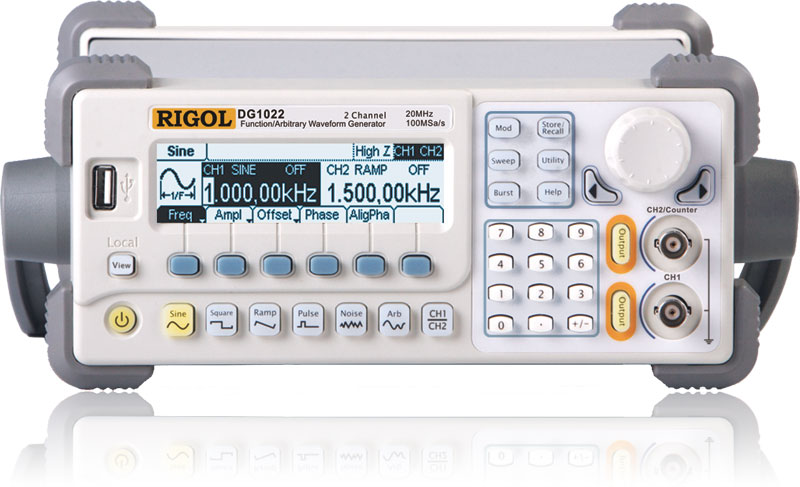

Attached are three pics of a BK Precision 4013b, a BK Precision BK4055, and an EM1656 I fond on Ebay
The one I found on Ebay is this one -
EM1656
The question is, are all these displays acting like substitute el-cheapo oscilloscopes for the internal signal, or are they just eye candy? All three have clearly labelled buttons that indicate what type of signal is being generated, so do they really have to show it again on the display? Does the BK display actually change the waveform as you change parameters. Is this just marketing candy to set them apart?
However, the EM1656 (of Chinese origin I think) is actually acting like a scope display. It says in the description -
It provides frequency sweep function and displays the output frequency, amplitude and waveform with a large screen LCD. It also can be used as a 10MHz frequency counter and a simple oscilloscope.
Is it really necessary to build-in a simple scope? Seems like a waste of money that just adds to the cost with little benefit. The scope in that thing can't be very useful.   :-//

AFAIK BK4055  is designed and manufactured by Siglent and Siglent model is SDG1050
It is also same as Teledyne LeCroy WaveStation 2052
(different colrs in menu and case)

I agree with rf-loop. The BK4055 looks identical to the Siglent SDG1000 series. I have a Siglent SDG1010. The waveform on the display changes with the settings (offsets, period, pulse width) but it is not an oscilloscope. However it does give a good grasp on what the generator is doing. I certainly wouldn't call it eyecandy.
yes its for eye candy. why to show it? because human visualize in graphics better they just look at their unit and they saw sine wave plot, in less than 1us, they know their unit generating sine. buttons they have to walk through them one by one to see which one is glowing, workable but a little bit harder, its ergonomics thing.

It's not really a "scope" as much as just a visual indicator of what's going on. I have an Agilent 33511B and it does change the graphic as you edit the waveform (e.g., shows pulses with width relative to the period, modulation if any, etc.). It's not in any way essential, but maybe just a little helpful.

At least one of them seems to have measurements marked, which is very intuitive and easy to read. It's also possible that they allow multiple saved arbitrary waveforms, in which case a visual indication of what's loaded is useful. The tek  arbgens I've used have done this, and updated the images to shoe things like symmetry and duty cycle.
If some do that, then I would agree it's a good use of the screen. But if they simply show a sine wave, when a button is already pressed that has a sine wave symbol on the button which is illuminated, then it seems to me it's just eye candy.  :-//

Stange: on the EM1656, the square wave seems to have some imperfections on the screen !?
Michel.
Offline mikerj
  • Posts: 3456
Re: Function generator displays that display the waveform being generated
« Reply #10 on: April 01, 2015, 08:08:14 am »
Michel.
The waveform generator appears to be running with none of the outputs terminated, so some ringing on the edges is very likely.  If the display really is a simple scope, then it's probably seeing part of these edge artefacts.
