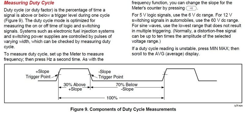

Below is from a Fluke 87V manual and the second is from a Fluke 120 scope looking at the pulsed 12V output from the 4WD module to the rear electro-mechanical clutch on Ford's UnIntelligent Four Wheel Drive System back in 2009.

« Reply #20 on: May 11, 2019, 01:09:03 pm »
So, to really understand..... When my DMM declares "% Duty Cycle Note: Duty Cycle measurements are AC only for this meter. Measurement signals must be ‘zero crossing’ and must reach ‐0.7V for the meter to properly display Duty Cycle %. " it means that alternating voltages between 0 and +5V are outranged from my DMM?

It sounds like that, Did not know any multimeters existed with such a poorly implemented duty cycle measurement mode, that implies its using a PNP transistor for a duty cycle buffer, and likely wont give any reading for a 0-5V signal with the ground lead referenced to ground,
Lucky for you, multimeter leads can easily be reversed, so move your ground lead to a 5V rail, and it will work, as the signal then falls atleast 0.7V under the "ground" or black multimeter lead.
This is fairly common, use two resistors and make a 2.5V point between 5V and gnd, then you can use that for your multimeter to measure duty-cycle.
There is also large difference between how good meters are at duty-cycle, some can show from 1% to 99% at 100kHz with 1Vpp, but there are many that cannot and the best meters are not the most expensive ones.
Can you give me a schematic example of how to do this? And why this solution works in my case?
