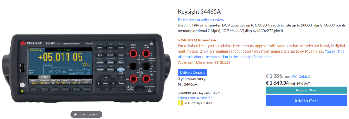

https://www.eleshop.nl/keysight-34465a.html
https://www.batronix.com/shop/multimeter/Keysight-34465A.html

I'm 100% sure that you will get service/repair from one of those company's:

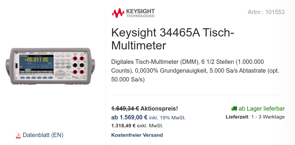

...and if you wanna save 80 Euro (also with 344DIGU) it is even better, to buy from Welectron:
Concerning my last request to Welectron, their stock only consists of the newer anthracite colour and they will change the picture in the near future:
Welectron: 1569 Euro
https://www.welectron.com/Keysight-34465A-Tisch-Multimeter
Batronix: 1649 Euro
