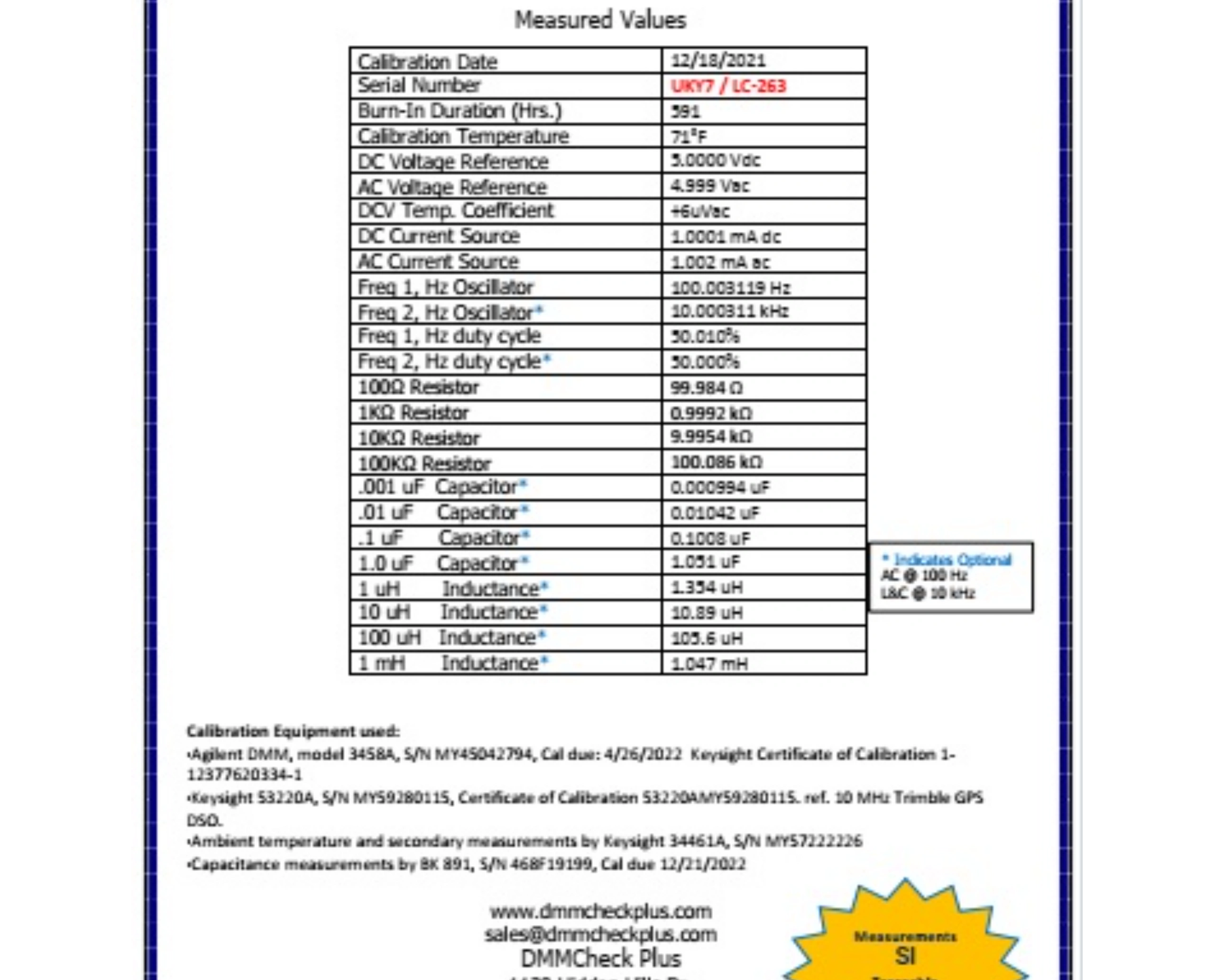

Could you share your calibration certificate that you receive with it?
I got mine long ago from voltagestandard.com and could not be happier. But after the project was sold to the new owner and since then my experience was not as good as with Doug. I added the LC option and I don't feel strong about it.

What is your concern with the L/C board?  One thing to note is that the values are taken at 10kHz.  Early printouts did not state that.
Here is a calibration sample from their website: https://img1.wsimg.com/isteam/ip/c544540f-524c-4b38-8d0c-cbfda88bf37a/blob.png
My printout from 2022 looks the same.

The "recalibration" of the DC voltage references from VoltageStandard.com is also the same.  All the references are tweaked to be as close to the desired value as possible before being sent back to the customer.
FWIW, Doug puts the as-received value on the certificate as well.
