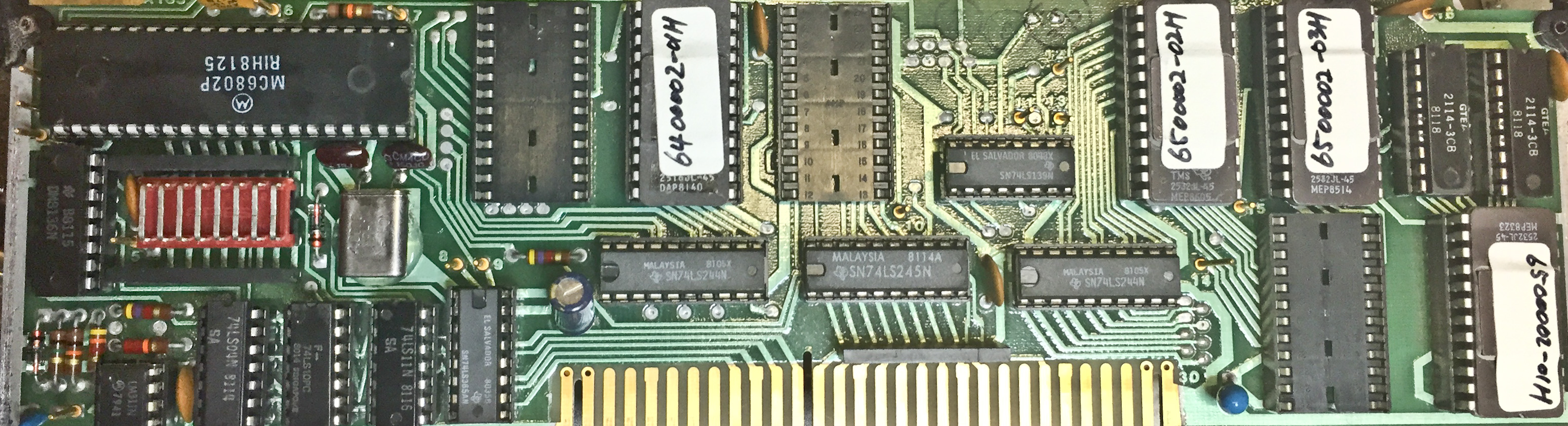

The good news is that now it is perfectly responsive whereas years ago,  when it last worked,  it was often difficult to drive, maybe the corrosion had already started to set in.
Attached is a photo of the Micro board with 3 chips missing !  But it works and I believe it has never been touched as I know the original purchaser.  BTW if you right click and copy the image it is 3K wide.

« Reply #80 on: December 29, 2018, 07:07:23 pm »
This board is the old type @1MHz clock and ancient EPROMs TMS2516/2532, empty sockets are for option firmware extensions, your Opt.02 Power-meter EPROM is located on A107 board.
New board is much different, see this link:
https://911components.myshopify.com/products/eip-micorwave-2020215-02-a-circuit-card-assembly
See my previous posts for more detailed explanations.
