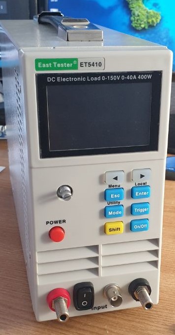

Hi, I'm the new owner and I made some adjustments. I placed the
1.USB port on the front panel
2. I added terminals for 4W measurement
3. I added a 2W / 4W switch
English is not my native language, I use a translator.

Post some more pictures of the board with focus on the area close to the metal bars.  Shine a light behind the board to  see the traces. Most likely the voltage measurement is in the area of the op amps close to the metal bars.  There are probably some tiny traces going away from the bars area to measure voltage.
Offline kawal
  • Posts: 275
Re: ET5410 Electronic Load mod: add external sense
« Reply #60 on: April 28, 2023, 06:33:50 pm »
Anyone want to do the remote on ET5410+ this is how:
Cut traces going to the terminal
Solder wires to resistor pads as shown . Other side will be your sense connections.
The following users thanked this post: edavid, andobovsayvkub

How I would do it, First cut the traces mentioned by kawal, now we have an open middle point (the place we cut) from the lef of the cut run 2 wires to the middle conection of a DPDT switch, then from one of the switch positons run wires back to the side going to the resistors (right of the cut) and another pair of wires (using the last contacts on the switch) towards an external connector. I would do it with a BNC.
Cost-effective and reliable.
Here is how my ET5410 looks:

Hello. I just made a connection for 4 wires on 5410A+. I cut the traces and simply added a 22 ohm resistor between +V and +SENSE. Setting more then 20 Ohm will lead to an measurement error with 2-wires, and low values will cause voltage drop with 4-wires.
This made it possible to use both a 2-wire connection and a 4-wire connection without adding a switch. The standard behavior of the device has not changed.
Yes, it is possible that a voltage error may occur with a 2-wire connection but no more than 1 in the last digit on the screen. Tested in the range of 5-60V, 0-25A. And it still measures absolutely accurately with 4-wires connection. Also thinking of diode protection, but later.
part of original
2076389-0
new one
2076383-1
appearance
2076371-22076377-3
And one more moment. The motherboards have been replaced due to a transistor that burned out on the first day. And I can't remember if the "software sense" function worked correctly when measuring the resistance of the wires connected to the battery or to other weak source.
The line resistance measurements are correct with a laboratory power supply. But when I try to measure the line resistance with the battery connected, I get incorrect data as the source voltage has a drawdown. Is it like this for everyone or is the new board also defective?
That was my the main reason to transfer it to 4-wires schema.
Hello,
So your mod does not need any switch to choose between 2-wires or 4-wires ?
I see this is a newer model than mine.
I have modded mine today, after so many years :-DD (fan mod previously)
Thanks to @cybermaus mod  ;)
The mod was not really hard, and the 3 holes positions were already spotted on the back.
I don't know why I have not made this before  |O
Here are some photos I have made, for my original ET5410  :-+
