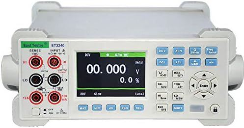

Or ET3240 in 182€ + 0€
https://es.aliexpress.com/item/4000251706618.html?spm=a2g0o.detail.1000014.7.270878eeUdRcD0&gps-id=pcDetailBottomMoreOtherSeller&scm=1007.13338.177933.0&scm_id=1007.13338.177933.0&scm-url=1007.13338.177933.0&pvid=36c45c8a-5acd-4306-ae76-d8f9a27c732b&_t=gps-id:pcDetailBottomMoreOtherSeller,scm-url:1007.13338.177933.0,pvid:36c45c8a-5acd-4306-ae76-d8f9a27c732b,tpp_buckets:668%230%23131923%230_668%23808%234094%23730_668%23888%233325%2310_3338%230%23177933%230_3338%233142%239890%2310_668%232846%238110%23364_668%232717%237559%2366_668%231000022185%231000066059%230_668%233422%2315392%23999
