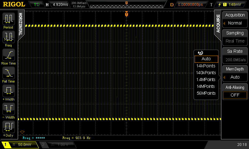

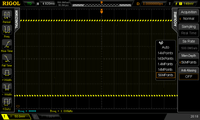

Offline WVL_KsZeN
  • Posts: 92
Re: REVIEW - Rigol DS2072 - First Impressions of the DS2000 series from Rigol
« Reply #1901 on: December 18, 2013, 07:12:52 pm »
ofcourse, but there's more than 100 oscillations on the display.. no need for >1% error.
And if it's only depending on the display, how does changing the mem depth make such a big difference? the displayed signal is exactly the same.
@ auto mem depth
@ 56mpts mem depth
« Last Edit: December 18, 2013, 07:22:05 pm by WVL_KsZeN »

Offline marmadTopic starter
  • Posts: 2979
  • Country: aq
    • DaysAlive
« Reply #1904 on: December 18, 2013, 07:42:26 pm »
The memory depth changes the amount that the DSO decimates to the display memory - either 13.8MB decimated to 700 bytes - or 56MB decimated to 700 bytes - in your images. You can imagine there will be changes in the frequency decimated to because of rounding errors.
Personally, I would NEVER use frequency from the measure menu (because of accuracy) - just the counter.
But it seems we have this discussion about the flaky measurements on DSO every few months. The truth of the matter is this:
Unless you have an expensive DSO which measures in sample memory, DSOs suck at measurements. All oscilloscopes, traditionally, have been crude measurement devices (on old analog scopes we counted graticule lines): they are, first and foremost,  VISUALIZATION devices. Now, DSO manufacturers have figured out a cheap, simple, and fast way to tack on measurements by using display memory - but honestly, if measurement accuracy is important - use an instrument designed for accurate measurement - or - capture/save the sample memory and measure using external software.
« Last Edit: December 18, 2013, 11:49:47 pm by marmad »
