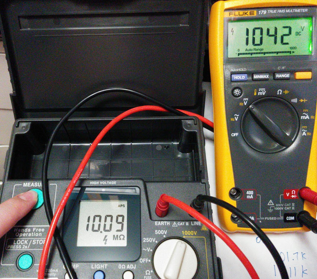

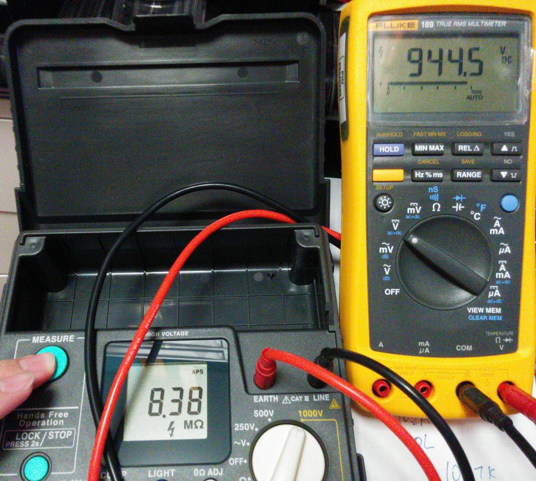

I decided to stress test my 189 with my megohmmeter to see if anything go wrongs with input resistance.
with 500V, having 10M input resistance, everything looks good.
But with 1000V...... it down to 8.38Mohm input resistance only. Somethings obvious not okay.  :palm:
I also tested my 179 and it remain 10M input resistance during 1000V stress test.
Which components is failed in my 189?? Is it the MOV or PTC ?

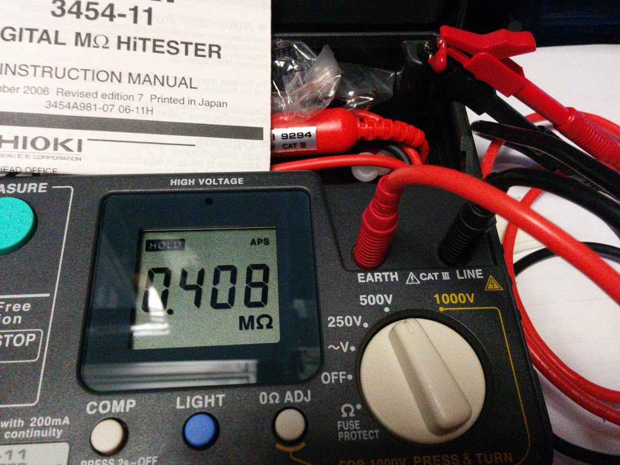

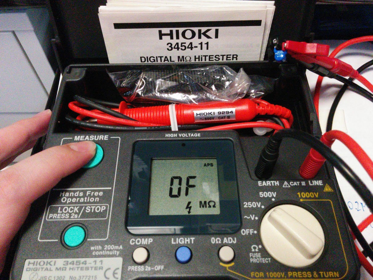

I just de-solder all those MOV and check them one by one. 8)
I am not sure about the red one (6838)? What's it spec ? Is it also able to sustain more than 500V too?  :-//
Both blue MOV check with 500V they are good
The red MOV is fine when testing with 250V, it got OF.  But when I test it with 500V, the reading drop down to 0.408M.
