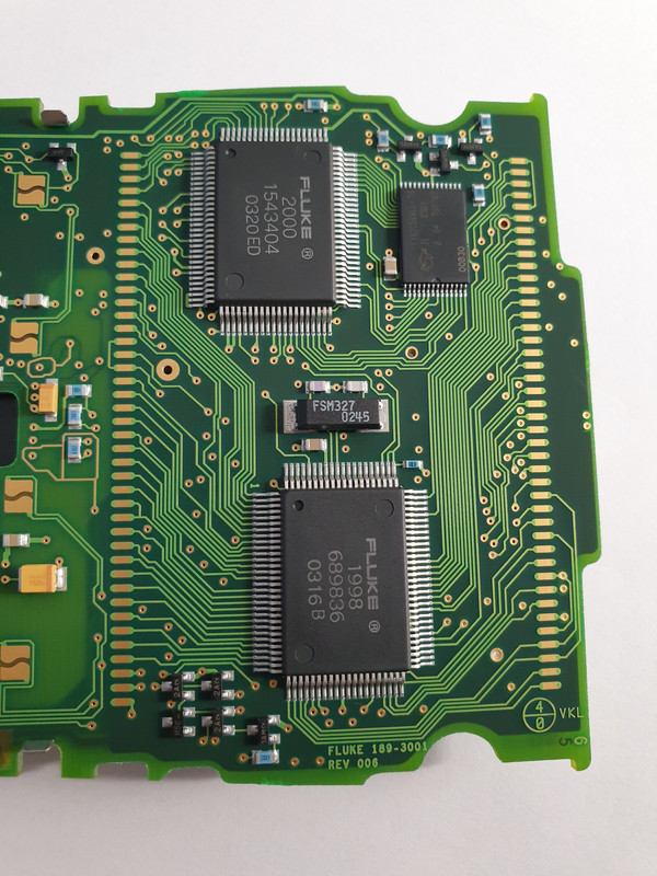

Hi, I know it's an old meter but anyone having same ghosting effect? Also the contrast is way worse than the 87V.
Is there any way to get rid of the ghosting?

Pull it apart and clean the rubber connector that goes between the PCB and the screen, aka. "Zebra strip". It's usually pink.
Many people use isopropyl alcohol but just rub it with something lint-free.
Also clean the PCB contacts.

Tried that already. The PCB is very clean. I've seen someone on YouTube using silver conductive grease. I haven't touched the zebra with IPA as I'm afraid of burning it.

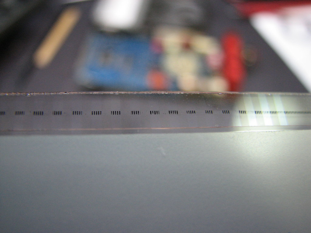

The strips on the LCD side are stuck on it, and I'm afraid of damaging them while pealing them off. Do you guys recommend me to clean the glass on the LCD too? Where the strips make contact?
As you see here (not my picture), the strips leave some residue on the LCD, but that residue means less material on the strip itself and a loss of material (higher pressure needed for the strips). It's just my theory. The whole idea is not to create a worse contrast on the LCD. Thank you!
I forgot to mention that for almost every Fluke meter I've seen, I've never peeled the elastomeric connector from an LCD.  I just leave it "attached" and clean the PCB and the other side.   Maybe once in about 100 or so meters have I had to peel one off to replace the connectors when that didn't work.   I've never seen any other model have the problem shown in the photo, EXCEPT the model 10,11 and 12 (and similar variants)  The contacts on those LCDs are VERY fragile.   I've cleaned the LCD contacts on other meters with no problem (but I don't recommend it, this was a meter with another ghosting problem that never went away, even with a new LCD and connectors)  but I've damaged a model 10 LCD contact by looking at at it crosswise.
