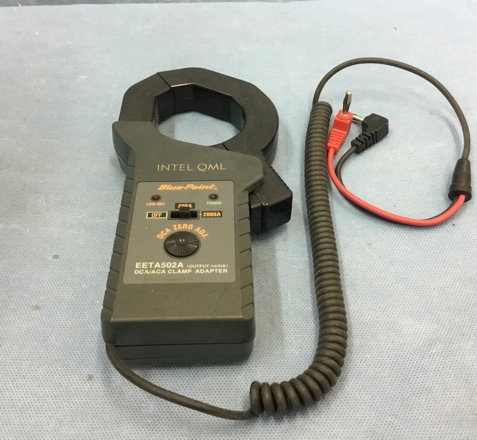

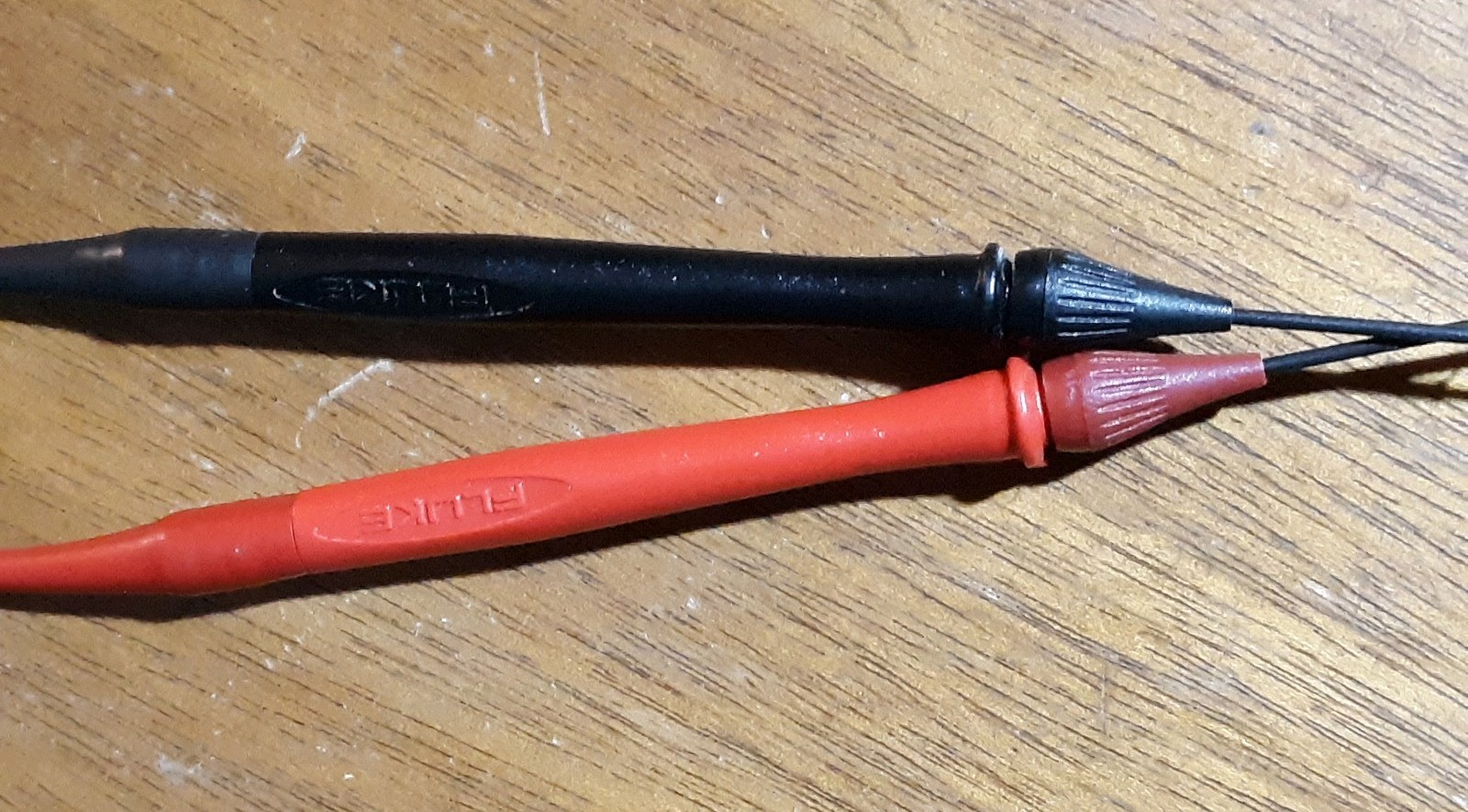

I have some other test leads. A pair of  Fluke 1000V Cat III 600V Cat III, the banana  jacks are concealed  and  90 degrees. I also have an pair of Agilent 1000V in storage only used a few time the jacks are also concealed and straight. An  older set of leads that are braided, with alligator clips I'm not certain what decade these are from I don't think you can find them new any more. Haven't seen them around. There more flexible than the more modern rubber  leads.
And another set included  with the Fluke 87 V.
Also found a Blue Point EETA502A AC/DC Clamp Adapter
