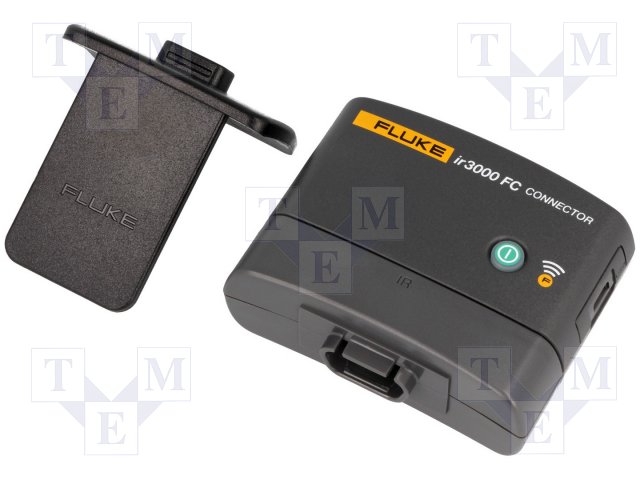

    I've been considering getting myself a Fluke IR3000FC for a while, but I find two completely different prices for what seems to be exactly the same thing. Most prices seem to be around the €150 mark such as here:
http://www.messgeraete-chemnitz.de/Fluke-Zubehoer/Fluke-IR3000FC-WIFI-Connect-Adapter-fuer-187-189-287-289-787-789-IR-3000-FC?gclid=CObfxL3LvMgCFUafGwodXKoBlg
But I've also found a few places selling it at a third of the price such as here:
http://www.eibtron.com/epages/eibtron.sf/?ObjectPath=/Shops/eibtron/Products/811-1385&utm_source=Portalexport&utm_medium=CPC&utm_term=Produktaktion&utm_campaign=GoogleShopping_DE&gclid=CMzS-MPLvMgCFYydGwodTfkI0Q
Is this really the same device? Has the price suddenly dropped, or is the second link some further adapter connector that I don't know about?
McBryce.

There are 2 different adapters with the same name. You have to dig a bit into Fluke's website to find this info. Have a look at the quick ref guide here:
http://media.fluke.com/documents/ir3000fcqreng0000.pdf
Then, look at Distrelec's web site:
http://www.distrelec.biz/search?q=ir3000
The cheap one is for the 155x devices.

I decided to take a chance (knowing that there's always the option to return it if it's wrong) and ordered this adapter: http://www.eibtron.com/epages/eibtron.sf/?ObjectPath=/Shops/eibtron/Products/811-1385&utm_source=Portalexport&utm_medium=CPC&utm_term=Produktaktion&utm_campaign=GoogleShopping_DE&gclid=CMzS-MPLvMgCFYydGwodTfkI0Q
The part arrived this morning, and I'm very happy to say that it really is a real Fluke IR-3000FC for the 289 that is being sold elsewhere for 3 times the price. The adapter looks exactly like this, ie: curved to fit the 289 shape: http://sigma.octopart.com/34277404/image/Fluke-FLUKE-IR3000FC.jpg and includes that piece of plastic which is required for 189 and 789 according to the documentation. McBryce = Very Happy :)
WVL_KsZeN / Groucho2005: The documentation confirms compatibility with: 187/189/287/289/789

Just wanted to confirm McBryce's findings. It comes with the plastic part for the 187/189. You need the 'other' rubber thingy also though, which is normally used for the cabled connection.
By rubber thingy I mean the black rubber part on the back. http://mrmodemhead.com/blog/wp-content/gallery/f189_00/F189_003.JPG
Can't get Fluke connect to work on my 2013 nexus 7 with android 6. The tablet sees the ir3000 fc, but Fluke connect doesn't. It works with my s4 mini though...

According to http://en-us.fluke.com/products/all-accessories/fluke-ir3000-fc-connector.html#features, you can upgrade the IR3000FC with the USB port :
Fluke Connect ir3000 FC Connector allows you to wirelessly transfer data from your existing Fluke Tools to your smart phone.
Fits over the IR port of your existing Fluke Tools
Upgradeable by USB
Immediately enables you to graph, save and share the tool's reading with your team from your smart phone
« Last Edit: August 02, 2017, 09:11:02 pm by WVL_KsZeN »
