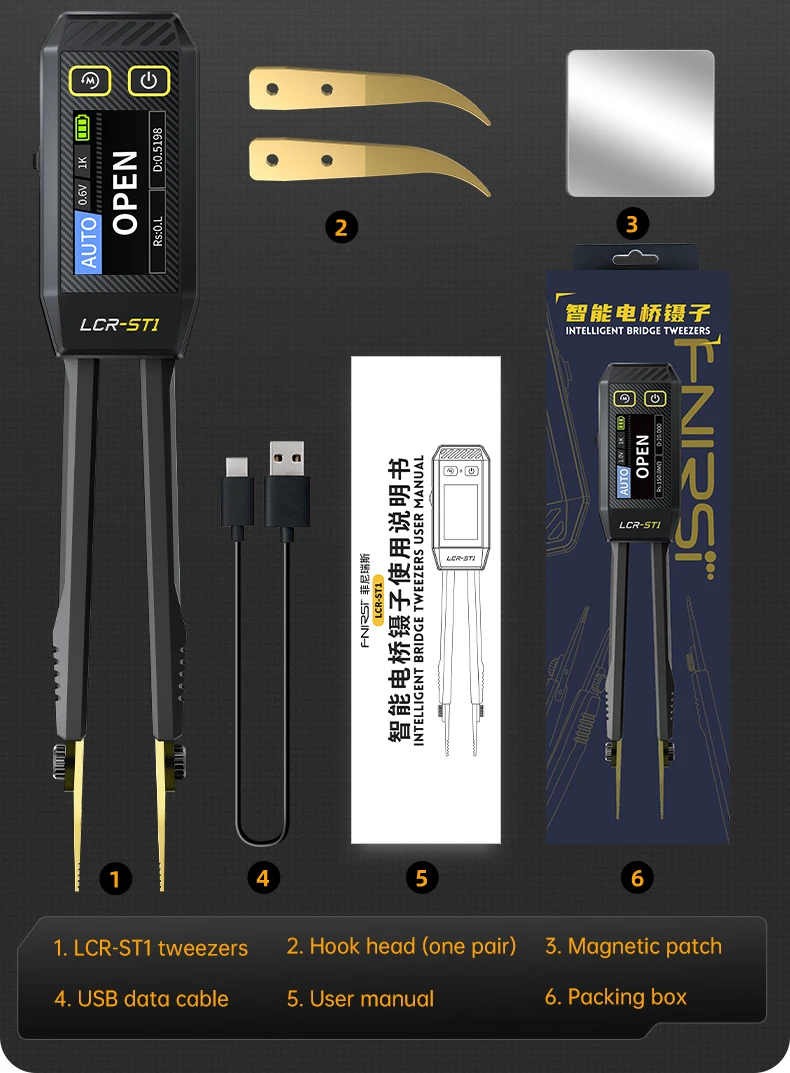

Looks like there isn't a thread about these yet. 30EUR-ish LCR tweezers. Some more info on AliExpress / fnirsi.co. Can't find a review. They seem really neat, but knowing FNIRSI there are likely some bugs and issues :D Anybody try these yet?
1.Product Model: LCR-ST1
2.Capacitance range: 1pF-22mF
3.Inductance range: 1μh-10H
4.Resistance range: 10mΩ-10MΩ
5.Diode: On voltage 0.7V
6.Frequency test: 100Hz, 1kHz, 10KHz
7.Level test: 0.3V, 0.6V RMS
8.Parameter display: ESR, D value, Q value, Z value, X value
9.Display: 1.14'' color screen
10.Charging Interface: Type-C, 5V/A
11.Power Supply: 250mAh lithium battery
12.Auto recognition measurement: Support
13.Replaceable tweezer head: Support
14.Auto shutdown: Support
15.Data hold: Support
16.History record: Connect to PC to view and export
17.Language: Chinese, English
18.Size: 28×19×150mm
19.Weight: 41g

I was curious and ordered one on ebay. Found a seller listing at 26$US with free shipping  :o  can't really beat that price.
I received the package today.
Come in a nice storage case with extra tips, manual and usb cable.
