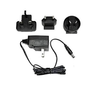

Don't understand the logic of a 15Vdc power supply, especially with what looks like a 12Vdc connector.
I am really looking forward to all my low voltage stuff being USB-C and getting rid of all these weird non-standard connectors, cables and supplies.  Many USB-C power supplies will do 15V @ 2A, way more than you need and probably way more efficient and possibly cheaper.
If they are using a linear regulator, then 12V might be tight for an output of 9V. Especially if there's some ripple on the power supply output.
For a reference like this I would be concerned with common mode and normal mode noise. So I'd ideally want a linear power supply. A phone charger or laptop would be the last thing I'd want to use. So I think an USB-C connector would be worse. Never mind the logic necessary to actually be compliant.
Pretty sure the supplied wallwart is a switcher, so internal filtering in it and in the DMMCheck must be fine:

As a test I powered my original DMMCheck Plus with a function gen and threw all kinds of evil at it aaand....nothing really.  Worst I saw was about 5uV on my K2010 depending on the evilness of the waveform on top of the 9V offset.  This isn't much in comparison to the maybe 25uV that I believe the reference is out currently (about 9 months since last cal) and which still far exceeds the spec of 0.007%.
So my opinion is the choice of AC adapter doesn't matter.

We provide a 15VDC external supply that is compatible with domestic and international AC line voltages and frequencies.  As an alternative, we have connectors available for customers that prefer to provide their own 15VDC supply, I'll put a link to the connector on our web page.
