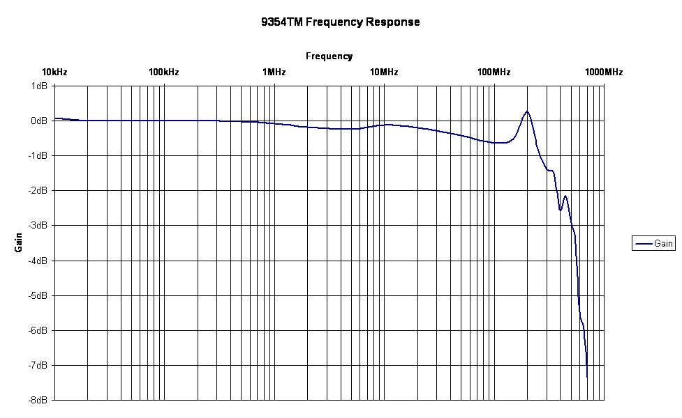

Hi Group,
Here is the frequency response of my Tektronix TDS 754A 500 MHz scope.
A HP8657B RF generator was used. The cable was a very quality Goreflex.
I have also attached a zip file of the raw data if anybody wants you manipulate the data.

Finally had chance to graph out the Lecroy 9354TM - this is specified as 500Mhz bandwidth with the internal 50ohm terminator.
Signal generator was a Marconi 2024, 1m RG58 coax, 0dBm signal level, internal 50ohm termination. The signal generator is supposed to be flat to 1dB or so but I don't really have anything accurate enough to check much past 10kHz so I'm rather trusting it blindly.
Almost spooky that the graph shows the -3dB point as exactly 500MHz - though as previously discussed the cable & BNCs are probably contributing about half a dB by 500MHz. Interesting peak at 200Mhz - not sure why that is unless the front end has been artificially tweaked to hit the 500MHz bandwidth. Could be the Marconi, of course.
« Last Edit: February 14, 2013, 08:58:06 pm by grumpydoc »

« Reply #40 on: February 14, 2013, 09:36:30 pm »
1m of RG58 has a propagation delay of 5nS, which happens to be the period of a 200MHz signal. The peak may indicate a mismatch at the scope input and/or Marconi output. Note there's also a dip at 100MHz. The Marconi probably has 10dB of attenuation inserted in its output path at 0dBm output level setting, which should provide a fairly accurate source impedance (unless it's damaged). I would bet the mismatch is at the scope. This wouldn't be surprising since the 50 ohm terminations in most scopes don't have great return loss specs.
OK, hadn't thought of that, interesting.
Not sure whether I should be pleased that I found it or miffed that it's there. It's all within ±0.5dB though up to about 225MHz so not the end of the world.
I'd assumed that the dip at 100MHz was the start of being able to demonstrate the roll-off, if you ignore the 200MHz peak it looks like it would roll smoothly from 0.5dB down at 100 to 1dB down at about 250 and 2dB down at 350MHz.
I might map out the other inputs and also the other Lecroy that I have (a 9354T). It could also be useful to try with a 50ohm terminator on a BNC-T piece and compare with the 'scope's termination.
I confess that, although I have a sort of basic grasp of what's going on as soon as we get into the detail or the maths it goes over my head.

If you have a 10dB BNC attenuator pad, it would be very interesting to bump the Marconi up to +10dBm, insert the pad directly at the scope input, and do the same plot. If the peak doesn't go away, move the pad to the Marconi's output instead, and repeat the test. If the peak goes away in either condition, it was due to impedance mismatch/reflections. If not, it's part of the scope's response.
I don't but think I might keep my eye out for one.
The Marconi has the high (+25dBm, I think) output option BTW so the 0dBm output might be more than a 10dB attenuator.

I'd be surprised of the mismatch was at the Marconi end - particularly since its range is much higher than the scope's BW. I only included that possibility in case it happened to be damaged. If its output level is correct, then its attenuator is probably OK.

AFAIK this kind of peaking is pretty normal (it is well within 1dB BTW). If they add a filter which peaks a little bit they can squeeze an extra 10% bandwidth out of the same hardware.
I have no reason to suspect a problem with the Marconi attenuator - certainly at lower frequencies it appears to be spot on. The graph 0dB line is pretty close to 0dBm - I chose the 50kHz reading as the reference point. The 'scope reading for that was 221.8mV rms which is about -0.07dBm (unless both are off by the same amount, of course).
I do have a Marconi 2305 which I bought to adjust a 2022 which had lost it's RF level cal due to an EEPROM failure - not got round to that project yet so I've not fired up the 2305 but it was bought as working. I might use its RF level meter to check the Marconi output although I think the accuracy is only supposed to be +/- 1dB - maybe not enough to confirm that peak but it should show whether the Marconi is broadly flat in the 100MHz-500Mhz band.

Took a little longer than anticipated but here is the frequency response of My MSO-X 3104A.
Signal generator used is an HP8648B, supposedly not calibrated in magnitude and unknown flatness/ripple (the frequency is verified to be accurate with a good counter)
Each magnitude value is a mean value over at least 40 samples, from 1 MHz to 1500 MHz in steps of 1 MHz.
Also, another shot with the Tek284, with just a GR874 to BNC adapter. I can't seem to lose the significant overshoot so maybe the unit itself is faulty. I have another Tek284 I could try at some point but it got damaged during transport and I don't have the time to fix it right now.
« Last Edit: April 19, 2014, 03:08:41 am by Neganur »
I did the test with my MSO-X 3104A and HP8648C and got the same results.

« Reply #86 on: April 19, 2014, 02:37:53 am »
I needed some time to think and also re-read some application notes regarding the results I was getting with the Agilent scope.
My Tek 284 might actually not have an issue after all, but my perception of flat roll-off oscilloscopes does.
In fact, I'm a bit irritated that I wasn't quite aware of the fact that the 1 GHz 3000X isn't Gaussian. This changes a few things for me:
  • The Oscilloscope Vendor needs to specify system bandwidth for me (specific probe+scope), since the inverse RMS formula* for Gaussian scopes does not apply to Flat systems!
    *: BW(system) = SQRT((1/BW_probe)^2 + (1/BW_scope)^2)
  • I am able to measure rise time down to about 500 ps more precise than with a Gaussian scope of same bandwidth.
    Any faster than 500 ps and the Gaussian scope will be more accurate, although both types will have greater than 15% error at that point.
  • I will have rather massive overshoot and ripple when it comes to transient behaviour such as a step response.
  • If my signal rise time is significantly faster than my system rise time (scope+probe), I can estimate the signal rise time by solving for t_r(signal) in
    t_r(measured)=SQRT(t_r(signal)^2+r_t(system)^2)
    But is this valid for the Flat response scope too?
  • The Flat scope has less sampling alias errors, and also requires a less minimum sampling rate than a Gaussian response scope to reconstruct a signal for the same bandwidth
  • I will be able to measure and capture complex waveforms that consist of frequencies with maximum practical components of 714 MHz or less (i.e. up to 700 ps rise times) accurately, i.e. 3% accuracy.
    For a 1 GHz Gaussian scope it is 526 MHz (950 ps rise times) at 3% accuracy.
This is my first flat response scope, so I'm wondering how much of those gotchas I will run into still. It also makes me wish I had not sold the Tek7104 after all, it would be good to have something to compare against.
I'm really worried by the fact that I will see overshoot where a Gaussian scope would not.
Mainly because I am not sure I have fully understood what that will mean for me.
Like, is this signal really looking like this? How do I know it is my circuit and not the scope behaving differently from what I would expect.
What if I am specifically interested in measuring overshoot, I guess I better make sure my signals aren't too fast?
Other than that, I think this means that for in-band signals, this scope will serve me extremely well.
References: Agilent Application Note 1420
« Last Edit: April 19, 2014, 04:01:04 am by Neganur »

« Reply #87 on: April 19, 2014, 06:57:39 am »
Yes, picture 2 in this application note explains the over shoot of your scope. Probably I have seen this note but did not remember it any more.

Here is the plotted frequency response of my Tektronix 2232 in DSO mode using an SG503 leveled sine wave generator up to 260 MHz with 2 nanoseconds of RG-400 cable and a 50 ohm feedthrough termination that is suppose to be good to at least 1 GHz.
One curve is with the 2232 alone and the other includes the cheap 100 MHz x10 probe that I normally use with a coaxial probe tip to BNC adapter.  The measured bandwidth is 104 MHz for the oscilloscope alone and 106 MHz with the oscilloscope and probe.  The probe measurement was done using a different input level and attenuator setting which may have affected the results slightly.
Up to about 20 MHz, the oscilloscope absolute level measurement agreed with the output indicator on the signal generator to within 1%.
