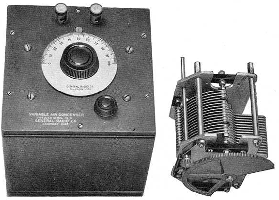

Offline trobbins
  • Posts: 839
Re: GenRadmodel 722 Mystery Capacitor
« Reply #6 on: October 15, 2022, 05:43:26 am »
Thanks for the photos - certainly an improvement on the adjustment resolution and internal trimming than my mid-1920's GR239E which spans 30pF to 1025pF with a simple linear 0 to 100 dial.  As far as I can measure the original 1025pF FS cal has changed to 1033pF +/- about 2pF.
