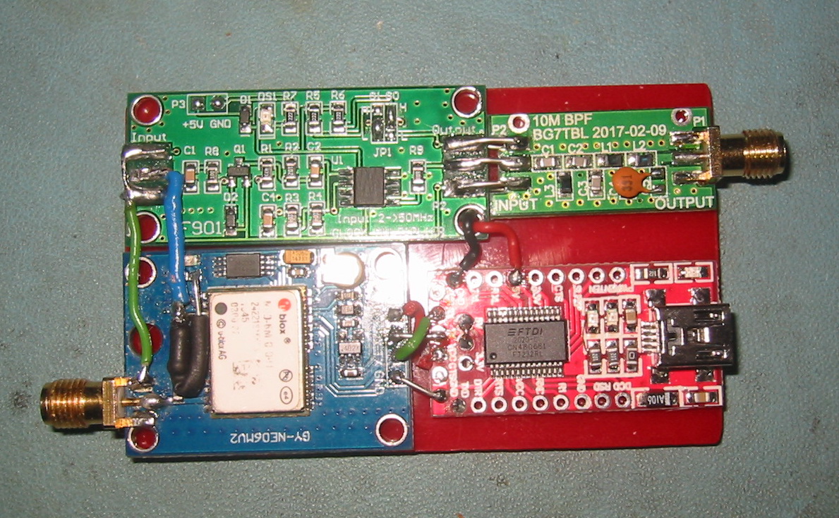

« Reply #25 on: January 25, 2021, 01:28:53 pm »
Justanothername,
That resistor is going to the led. I lost the smd part in the carpet!
I just separated the pcbs, powering the multiplier with its own supply and things are looking as they were.
I'll work on a pcb layout and share if it improves things.

Offline purposeTopic starter
  • Posts: 282
Re: Ghetto 10MHz GPSDO
« Reply #32 on: January 25, 2021, 07:26:49 pm »
C'est vrai.
  • Posts: 282
« Reply #33 on: January 25, 2021, 07:41:06 pm »
justanothername,
Battery power was my first thought. Leaving off the ftdi and putting on a programming header for it, was another, but my ftdi has just given up, so might have to get another type in to try.
cheers

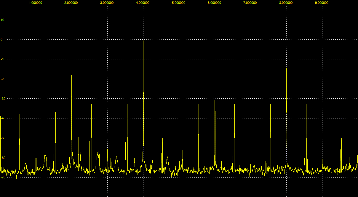

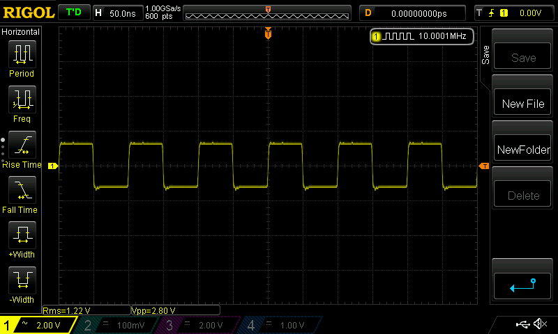

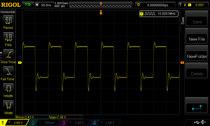

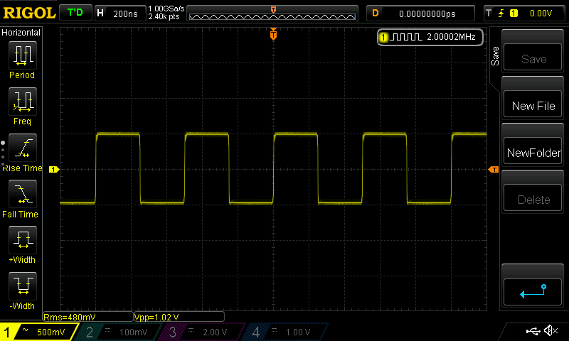

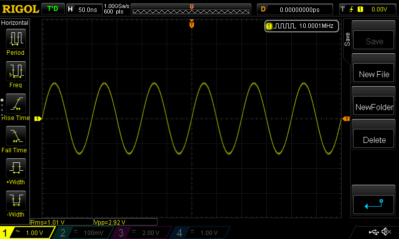

  • Posts: 282
« Reply #43 on: January 26, 2021, 02:12:05 pm »
CJay's slideshow.
2MHz out of ublox into 50R. Ignore Rigol's counter. Trust me.
Same on the spectrum.
2MHz X5 no load.
2MHz X5 into 50R
10MHz sine post BPF
« Last Edit: January 26, 2021, 02:26:16 pm by purpose »
  • Posts: 282
« Reply #46 on: January 27, 2021, 12:35:40 pm »
CJay,
The one thing you asked for (I think), I omitted. So ere ya go.
Post 5X multiplier, no band pass.
Your hint of filtering pre multiplier has just sunk in.
« Last Edit: January 27, 2021, 12:38:15 pm by purpose »
