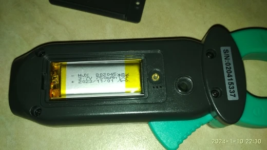

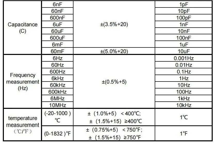

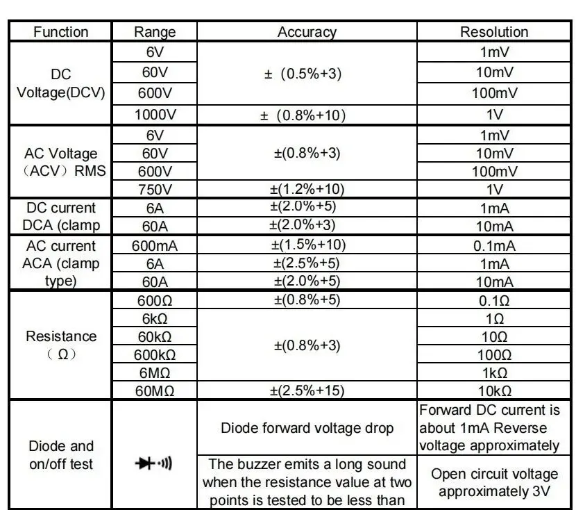

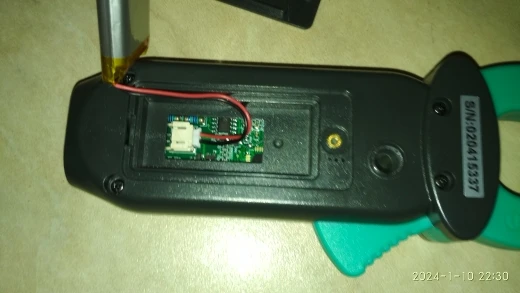

A relatively cheap AC+DC clamp meter I have been puzzling about for the last ½ year is the Winapex 268B
- as it seems to have the current tolerances from Unit-T211B on the clamp with 0.1mA in AC and 1mA in DC while costing around 1/3 of the UnitT- UT211B.
Anybody tried one of these 268B ? - the price seems to be around 35€ [incl. VAT & delivery]
built-in battery (750mAh)  https://ae01.alicdn.com/kf/A1e8c66d9c3e34135b4e6c7ac5177fd0c2.jpg   & https://ae01.alicdn.com/kf/A40b01b1364e84150a4aaf693002f709f9.jpg

I consider only 2% tolerance in the 60A range to be unbelievable.
As a rule, current clamps of this type are less accurate with increasing current.
In addition, there is this strange "roller coaster" of tolerances in the ACA range.
1.5%, then 2.5%, then back down to 2%.
It's tempting to buy and test them. ;)
I just ordered one from Banggood for €36. Just to see....
