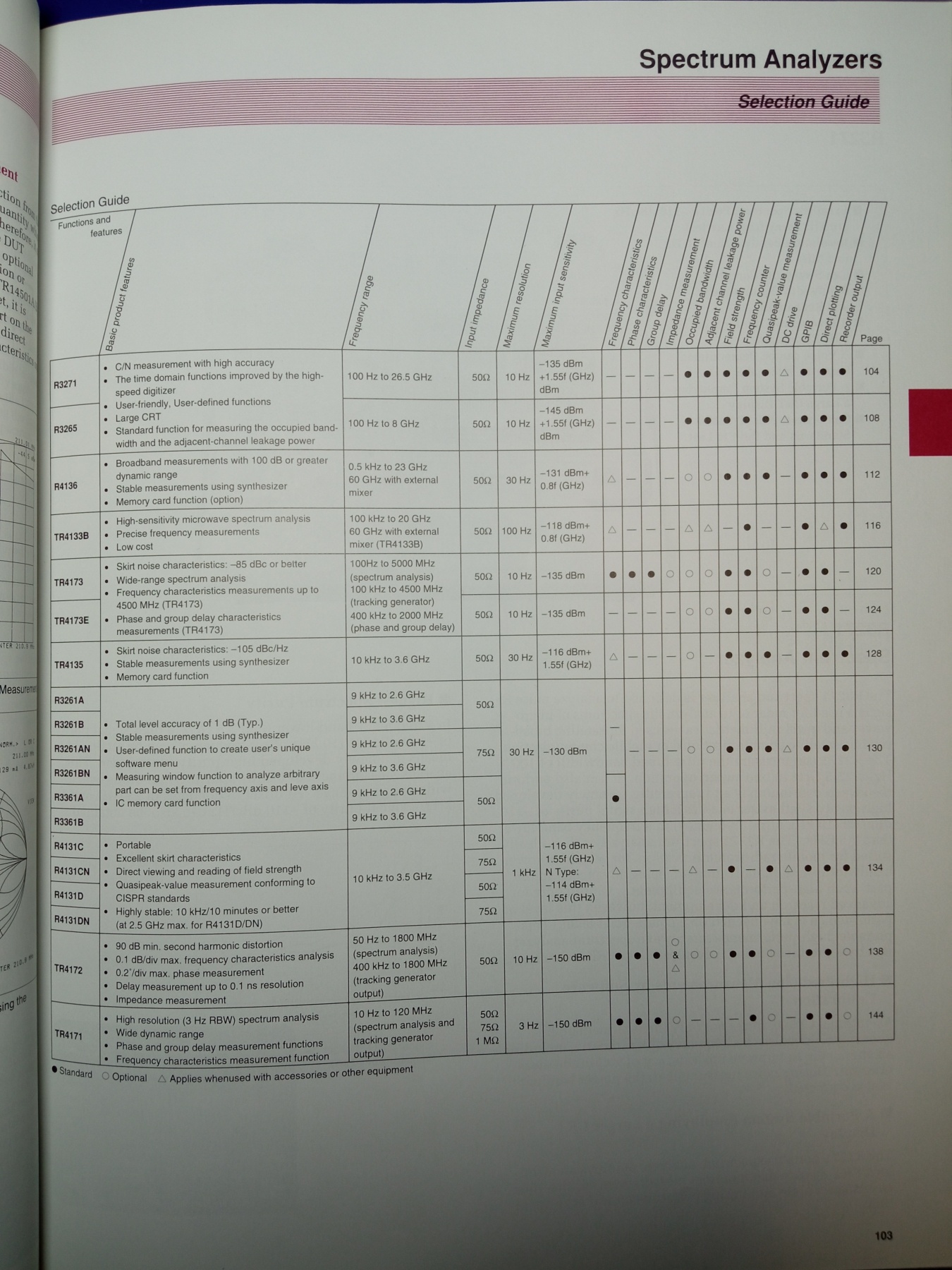

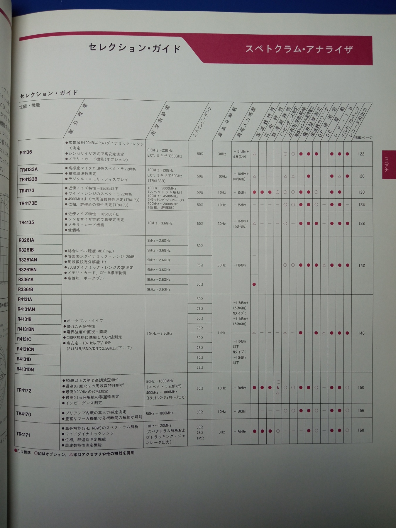

The difference from version C and D is as follows:
(1)   Frequency can be set by specifying the channel number of the television.
(2)   Programs in the memory card can be executed easily.
(3)   Audio can be monitored through the built-in speaker.
(4)   Good visual recognition in the outdoors is provided by adopting the high brightness green CRT.
User manual R3261_3361_C_D_K :
https://cloud.mail.ru/public/b4bn/umJexn7hE
