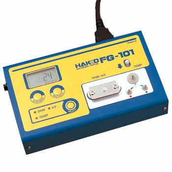

Hakko FG-100
« on: May 05, 2014, 02:28:29 pm »
anyone used one before?
they seem to be on ebay/china for $15 or less, yet the real unit, if bought via amazon (for example) is well over $200.
if anyone has a real one, I'd love to see what's inside.  I ordered one of the ebay versions and I'll do a teardown as soon as mine gets here.
it seems like its just a thermocouple and some simple controller, so I'm not at all sure what could demand a $200 price tag for this, other than market demand.
anyway, for $15 I added one to an order I was placing anyway, so I'll see what that $15 buys me.  it comes with those triangle flux capacitor looking things (lol) and I'm not sure why there are 3 leads on a thermocouple, but I'll soon find out.

IIRC, the Red and Blue legs are what's measured, the third leg is just for mechanical stabilization so it doesn't rock/swing when you put the soldering tip to it in order to get good contact.
As per cost of the real thing, it seems you're paying dearly for the name in this case IMHO. Weller's even worse (~$700 for theirs).

ah, just found the eevblog threads on this (did not come up on search but did come up on google search).
what I'd like to find out, once I get mine, is if there is a simple jumper to change C to F or if its hardcoded per model.  there is a C and an F orderable model and they are not the same model #.
yeah, after reading a bit more, the 3 terms are just a 2 term K tcouple with a 3rd support wire.
I would not spend a lot on this.  never would I think to spend $200 on it!  but for $15, ok, I'll see what its about.
otoh, I already have a few tcouples and dmm's that read type-K's directly.  this was more an impulse buy from a vendor I already was placing an order with.  but might be an interesting tear-down.  I have not seen any schematics for this online and no high res photos of its insides, either, so I'll shoot some when I get it.

Seem to recall a thread somewhere that showed how to change it from C to F, but not sure if this works on the copies or not. Also had tear down photos IIRC, so might be worth a search (might need to try some other names they're sold under, such as Lodestar).  ;

C* and F* swap, doesn't look like it, unless there's pins to short on the processor
to your dismay, you'll find that it works (for $200, Hakko removes the flux residue for you, for $15, you do it yourself)

Found a pic of how to change the temp scale displayed. Also, search "tip thermometer", and a bunch come up, some with links to external sites such as adafruit, where I found the photo.

Here's the thread I found it in. Unfortunately, I jumped the gun, as it appears to be for changing the displayed temp scale on the FX-888D rather than the FG-100.  :-[
Regarding temp scale on genuine FG-100's from Hakko, you have to order the correct model, so it seems it's hardwired (C is the FG100-01, Farenheit FG100-02), and I'm not seeing any jumpers in photos posted in another thread. Seems the copies are doing the same, and may not even be producing units in the Farenheit scale at all (not seeing any other than one genuine Hakko listed on eBay).

I bought one the other week.  There was a thread here where someone had screwed up the temperature settings on their FX888D and their iron tip was discoloring.  I was having the same problem so bought one of these and calibrated my iron.  It was more than 100F out!  The FG-100 was Celsius onl, so I had to switch the iron into Celsius mode to calibrate it. I can't comment on its accuracy, but my iron is a lot better now.

On the pictures posted, the pinout on the COB exactly matches the ICL7116, a variant of that infamous multimeter ADC. So it should be pretty hackable if you want to switch temperature ranges/recalibrate it/etc. You'd just need to reverse-engineer the analog front-end, which doesn't look too difficult; there's a HEF4013B dual D flip-flop and an LM385-1.2 voltage reference.

I'm assuming the 2 blue pots are for cal, also.  I'll find out when I get it.
it might be worth playing with.  didn't know it was a chip with a spec sheet I could even get ;)

According to this the authentic one can be switched from C to F on the PCB inside.
http://kb.hakkousa.com/KnowledgebaseArticle10273.aspx

this is a newer device. No FR4 but cheap pertinax. No external Opamp to see. No adjustment trimmers, but a place for one. No LCD soldered in. Quite low contrast. Only one contact row for LCD.
