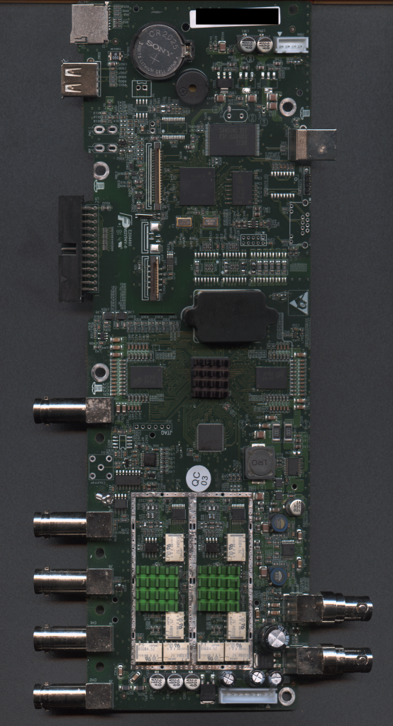

Offline tinhead
  • Posts: 1918
    • If you like my hacks, send me a donation
Re: Hantek HDG2002B AWG: 5Mhz or 100MHz? Let's see!
« Reply #279 on: September 25, 2014, 07:31:13 pm »
marabut,
it would be great to see high res picturs of your board

Offline marabut
  • Posts: 24
« Reply #282 on: September 25, 2014, 09:48:16 pm »
@Cyber7: I know it is possible to order large quantity of LMX's - but it is not viable option (for me at least).  And I think that engineering eval board would have all parts populated, so probably it's rather an example of budget driven engineering.
@tinhead: how could I refuse the man who started it all... :)
Links to full sized pictures (warning: about 40 MB each!)
Top:
http://i1309.photobucket.com/albums/s629/lionhorse5/top_zps764ba714.png~original
Bottom:
http://i1309.photobucket.com/albums/s629/lionhorse5/bottom_zps7f9b67e3.png~original
Previews attached below:

Offline tinhead
  • Posts: 1918
« Reply #284 on: September 26, 2014, 07:18:51 am »
hehe, at average, one of my wives is always "refusing"  :)
-tcxo (or maybe OCXO?) is covered with cap / thermal insulation box
i think there is tcxo and not ocxo soldered (one can see on bottom, these 4 pins from ocxo pinout not soldered).
But if so, that box is of couse still nice to have.

Offline Cyber7
  • Posts: 58
« Reply #285 on: September 26, 2014, 08:09:07 am »
@marabut: Good News! I have qty 5 LMX5080M coming from China in 3 weeks. $12USD shipped :-+
You can order from WWW.UTSOURCE.NET ...hopefully, this broker sells real, non-remarked parts....
Thanks for the pics. Interesting that VRegs U1 & U15 are missing, but they left the Vo filter caps behind :o weird.
Tinhead is right..through-holes for the OCXO source are unpopulated. Must be a TXCO under the shield cap. OCXO's may have greater stability (ppb), but don't you have to then wait for the entire unit to reach temperature equilibrium before trusting the OCXO output...
Also, an OCXO source would require a temperature stable reference voltage. Likely the missing U16 device immediately beneath it + assorted Res/Cap/diode. Probably something like a MAX6195/MAX6198. The foot print is right, but I don't think it's the right pinout as per your image & DS. Using an external 10Mhz rubidium timebase may be a better route, anyway.
