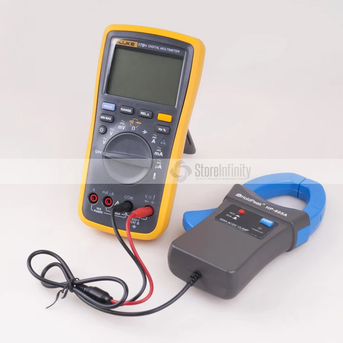

Looking for DC current clamp probes for my meter and oscilloscope, I came across these unknown (at least for me) probes:
HoldPeak HP-605A (600A AC/DC) ~USD 17 on Aliexpress
HoldPeak HP-605C (40A/6A AC/DC)    ~USD 33 on Aliexpress
There is almost no technical information on these probes. Furthermore, the smaller probe specifies 2 different output ratios, but I see no way of selecting them (Switch, button, etc)
Anyone ever heard or reviewed any of these probes ? I will appreciate any comment. TIA.

Caution, Quality control at HoldPeak is no existent, I bought 100 multimeters for resale from then and all of them are  not working, and they refused a return, Caution is necessary, you will get what you paid for

Yes, already seen those. But never heard of these new HoldPeak ones. There's a review on a russian site, and besides some error, I worked good after some recalibration.
Google translation is a PITA, but here it goes:
https://translate.google.com/translate?sl=auto&tl=en&js=y&prev=_t&hl=en&ie=UTF-8&u=https%3A%2F%2Fmysku.ru%2Fblog%2Faliexpress%2F55820.html&edit-text=

I've got an HoldPeak HP-605A some time ago. But it never worked.
They are also a very strange clamp meter.
According to the manual they output is in ampere not in volt.
So they are not the best to be used with an oscilloscope.
Look the picture of the instructions here:
https://it.aliexpress.com/store/product/Clamp-Meter-Amperometro-HoldPeak-600A-DC-AC-Pinza-di-Corrente-Adattatore-Clamp-On-Adattatore-Meter-con/3194051_32902518771.html
I've also the Hantek CC-65 and they are not bad at all for the price.

For $20 I went ahead and picked one of these up (605A).  My main reason was to measure the cranking current on starters for cars and motorcycles.
It works fine and is fairly accurate (+/- 3%).
The instructions are a complete mystery.  Ignore them.
It needs to be used with a meter that has relative capability in it's mV range.  It outputs 1mV/A
1) Set your meter to uVmV DC.
2) Connect the clamp and turn it on.
3) REL out the reading.
4) Place the clamp around the wire to be measured then read of the amperage in mV.
Seems well constructed and has a nicely implemented PCB inside with off the self components.
I have not tried to determine the BW as I have no way to modulate a high current at anything beyond 60 Hz.  For what I use it for, it will do fine and for $20 it was a bargain.
