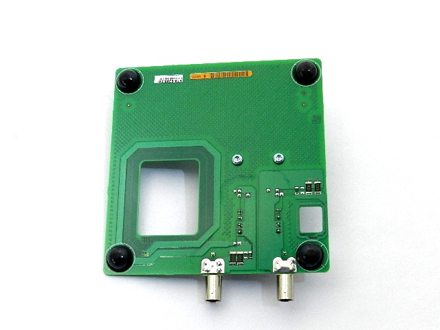

I have seen that tektronix sell a calibration fixture 067-1686-00. Here is the pictures
it looks like a simple pcb with a track used as multiple turn and 2 100ohm load resistor.
Furthermore, there is this useful answer of joeqsmith in March 06 2015 from https://www.eevblog.com/forum/repair/tektronix-p6240-current-probe-repair/25/. Here is shown some diy test jigs.
