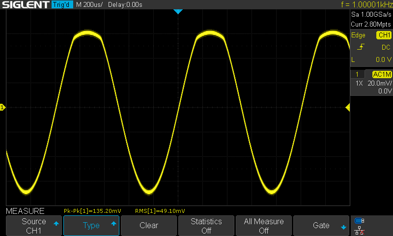

HP 3325A:
errors on self test  2, 3 (seems misleading )
Output on display: 29mV P-P:
NOTE:  Output not terminated to 50 Ohm
scope CH1  AC , and DC are present from  generator output  at lower peak of waves  ( like DC offset , but it OFF)

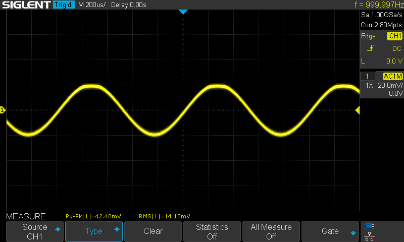

output on display:  30mV P-P:
same DC offset "0" at bottom of sineway
Then I shorted ACD ,
all tests pass ,   1V P-P , became 2.1V P-P  unterminated ,  and everything works , but

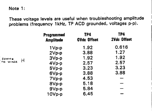

no DC offset regulation
this test pass with +20mV off:
and im lost  a bit ,  looking for direction ....
Found -   LM311 , A14 board
Fixed , now it need adjustment ...  calibration , at the level i can do ....
