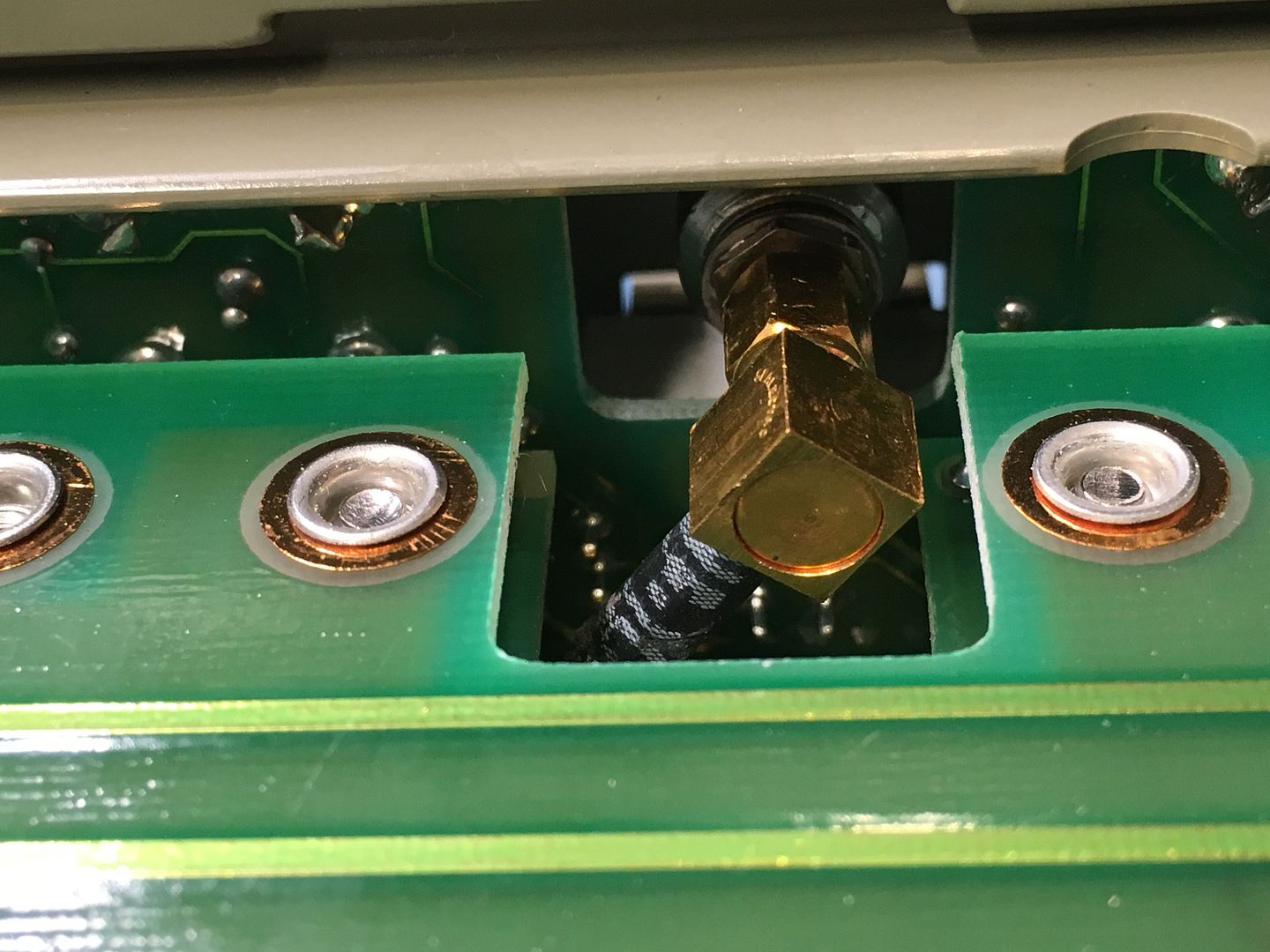

I received a questing from someone about the TCXO board install in my counter and thought I'd repost here for all:
"I have a question about  mounting and using the OXCO board in the HP 5316B. Many of the users of the board were using them in a 5316A. There are significant differences in that earlier model. I know you have a "B" model too, and your posted photo is in that unit. Apparently the "A" model had an external factory oscillator, so it was a matter of removing that board, and plugging in the replacement. In my unit, (and I assume yours) there is a crystal oscillator soldered on to the main board that supplies the 10MHZ reference sinewave. I don't know if the replacement board will mount over that factory crystal, or if I need to desolder it from the main board prior to installing the new board in the socket. I'm not sure if the firmware detects the oscillator and switches to it, ignoring the on board oscillator?
My on board crystal actually has a zip tie holding it down tightly to the main board , in addition to the fact it is soldered to the PC board. Did you desolder your factory crystal prior to installing the OXCO board, or is yours mounted over the on board crystal?"
My answer to this is; nope, nothing desoldered! I did however remove an oscillator board from my counter. A photo of the board I removed is attached. During the process I also replaced the two large electrolytic power supply caps. Nothing else was changed.
The following users thanked this post: pinpassion

Offline Luthor2k
  • Posts: 7
Re: HP 5316A Teardown and Frequency Standard
« Reply #69 on: June 24, 2020, 05:25:45 am »
Hey Pinpassion, attached is a photo of my counter, no 10mhz crystal to be found. Perhaps chase the trace? Those 4-pin XOs have low Z outputs IIRC...
