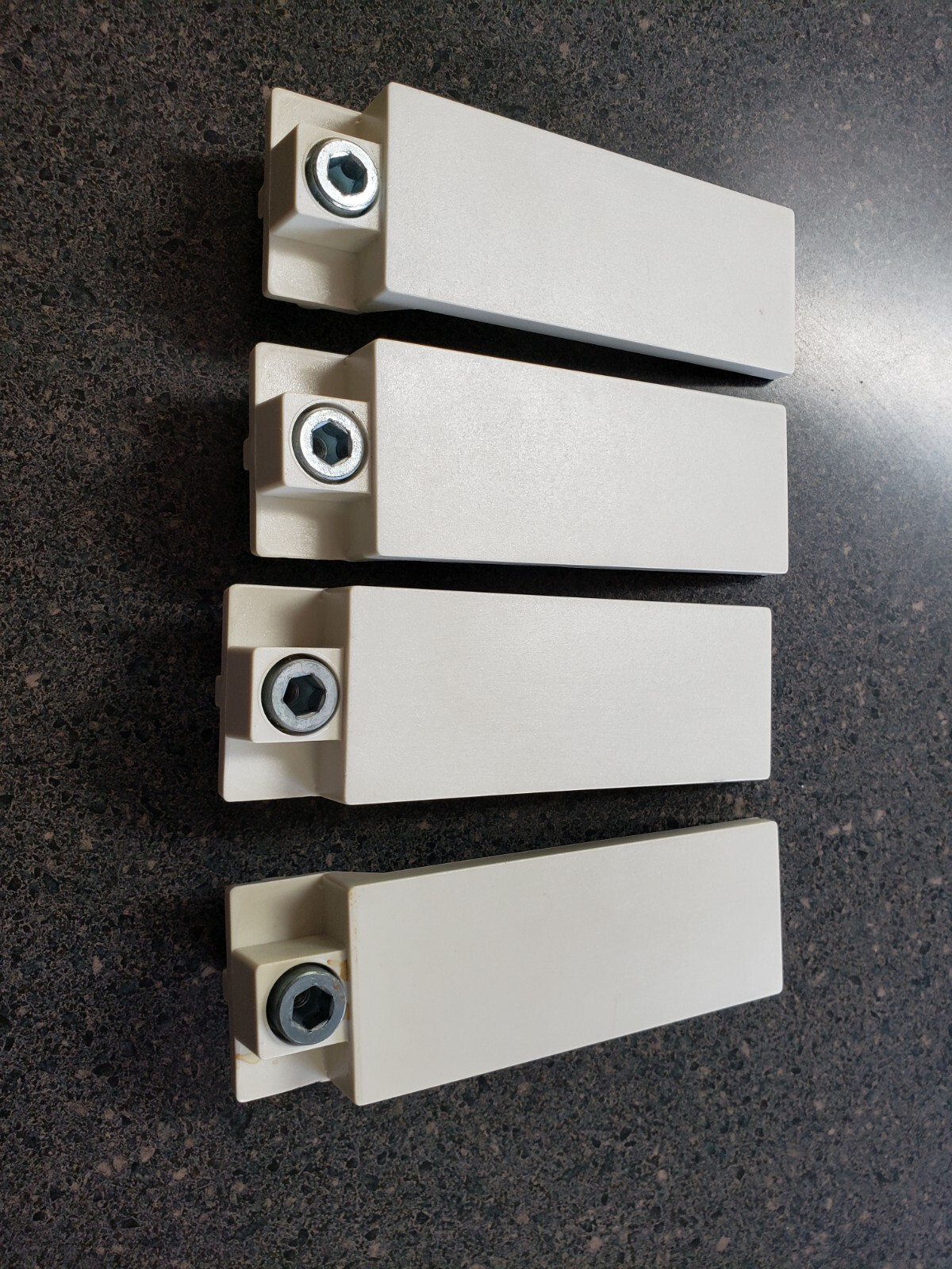

Possibly, I may have caught the HP 70000 MMS bug. Catching covid in March wasn't a problem, but I think the MMS bug may be quite harmful. Myo-wallet-itis, or even SADS. (Sudden Affordability Death Syndroms)
Just arrived: a 70001A Mainframe with 70841B Pattern Generator and 70311A 3.3GHz Clock Source.
Heavy thing, 70lb.  Naturally the US seller's packing was laughably inadequate and it got some dinged corners in the USA leg of its journey. After it reached the reshipper in LA I had it repacked in foam-in-place, so no more damage on the way to Sydney.
Most physical damage is minor and already fixed, except for one thing. The modules are held in place by diecast metal screw retainers. Some box-drop impact sheared one of these retainers in half.
These have an 8mm hex socket on the front and some unidentified thread internally. The mating screws are 5.8mm OD, 24 teeth/inch.   Thanks HP, for not using a standard thread like M6 or 1/4" Whit.
Well where am I going to find a replacement retainer? Any ideas?
If someone has a broken HP 70000 system module they'd sell for spares, please let me know.
