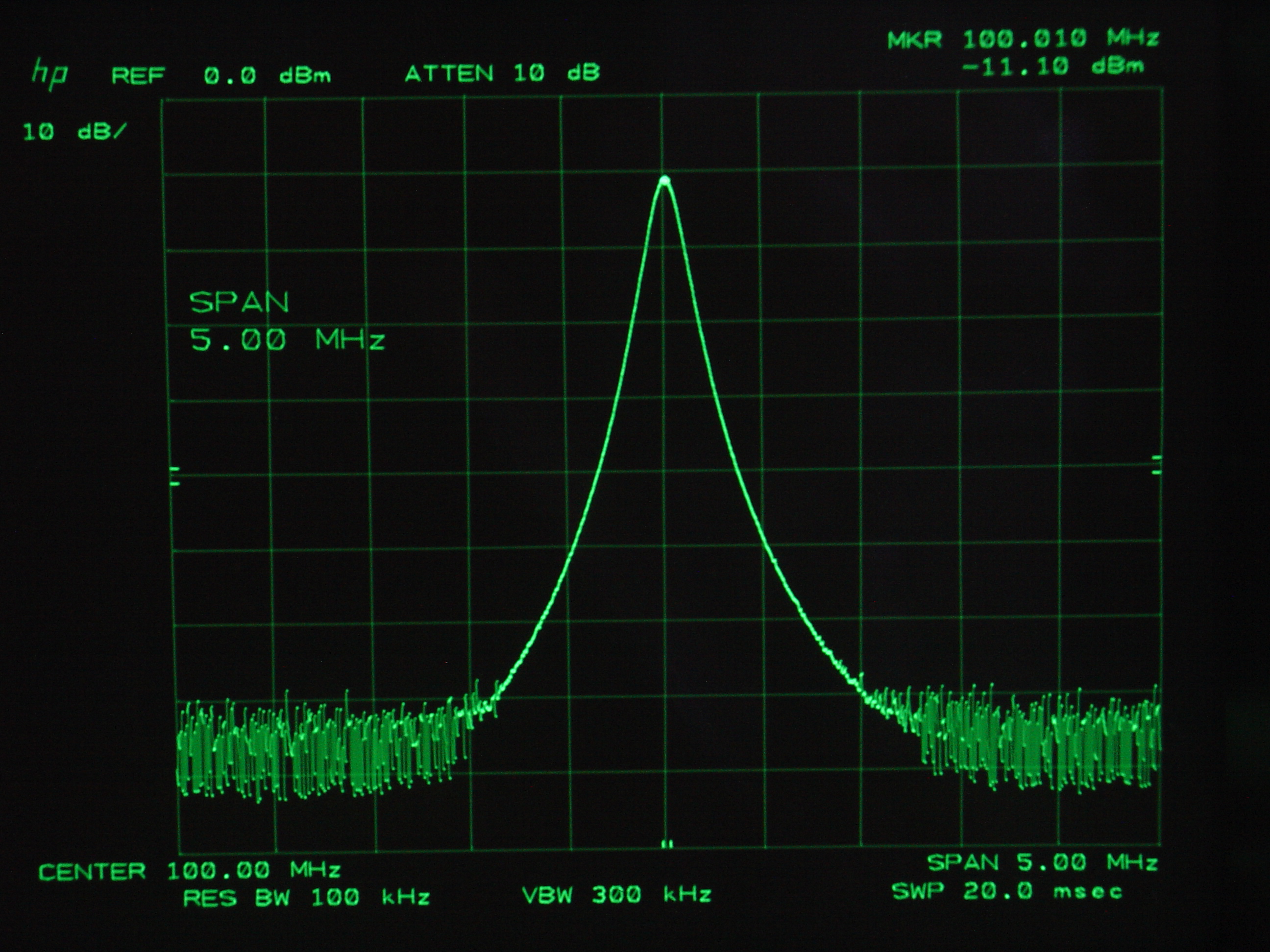

Hoping for a quick answer. Looking at an 8566B, condition unknown. Is this screen bad? Or is this normal for one powered on but with nothing attached?
I would expect just a straight line of static on the noise floor, but perhaps this is normal?

Normal.

Yes, I agree that that stepped response in the noise floor is normal.
Also have a look on a 5MHz and 10MHz span to see how much wobble there is on a signal fed into it at the centre frequency (eg 70MHz CF and 5MHz span)
Some units can be very wobbly when tested like this although a small amout of wobble is normal I think. The wobble should stop on spans less than 5MHz.
My only other comment about the display is that the CRT needs adjusting. The graticule is blooming (fuzzy) compared to the signal trace. Mine was like this (horrible) and I replaced a resistor in the Z board and also readjusted it for a nicer display.
I've linked to a hi res image of it below. This shows how nice the display can be if it is adjusted properly. I did this about 10 or 11 years ago so I can't remember what I replaced on the Z board but the CRT changed from a gloomy fuzzy mess to what you see below. It actually looks nicer than this when viewed with the naked eye as the camera makes it look a bit flat and dull.

Bring a BNC cable and a BNC to N adaptor with you and connect the main RF input to the 100MHz cal output on the front panel. Then press the blue SHIFT key followed by FREQUENCY SPAN. It will then do a series of automated correction tests which it should pass. Also check the attenuator works on all settings. The chances are you will have to deal with Yig related issues at some point. Only buy one of these if you are prepared to take it apart and replace tired caps and deal with intermittent issues caused by the plug in cards.
Make sure it works OK above range 0. The higher ranges use a different and very exotic mixer above 2.5GHz.

If you switch it on from cold, it will report OVEN and REF UNLOCK issues onscreen. This is normal as you are supposed to leave it powered in standby for maybe 10 minutes to allow parts of the RF section to warm up in standby first. However, l’d recommend turning it on from cold just to see how it copes with a cold start.
