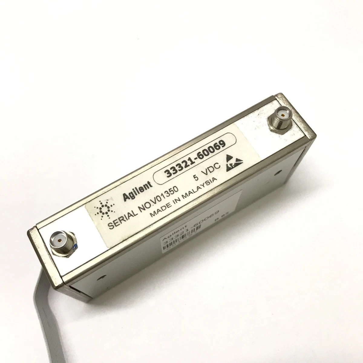

You definitely should have 24V, or the switches won't work, just check how the attenuator clearly says 24V, if missing it would explain it all.
Once you have the 24V tested working, if the signal keeps failing:
The attenuator block has four elements (-5, -10, -20, -40dB) and makes a combination of them in series and/or bypassed.
If one of them is burned, you'll get an open circuit.
So try finding a signal by manually setting attenuation to -5, -10, -20 and -40dB.
It's pretty easy to disassemble, but there're a lot of screws behind the cover, where the sma connectors are.
This is it:
One 8592 had that one burned, other had a burned transistor array which activated a rf switch, whose coil was completely roasted, can't remember what it was for.
It was a latching switch, so it only needed a small pulse to change, but the switch contact had fallen (Plastic rivets...), so my guessing is the system did not detect it switching and kept energyzing the coil until it overheated, then everything burned down in a chain.

The label means the coils in the attenuator are meant for 24V, thus the logic tells it'll be powered at that voltage.
These are also available in 5 and 15V versions IIRC.
Or maybe someone replaced the attenuator block with a wrong one?
There're also 5 and 15V versions, so it's strange HP mounted a 24V part there.
Wether HP used them like this, I don't know.

HP8594E, 8595E... etc  Attenuator is 24V version ( 33321-60036 ) It have dc bloc, 10, 20 and 40dB attenuator chips
A long time ago I repaired many of these spectrum analyzer attenuators. When it's done well, renovated equals new. But then it is not even opened on a dusty table. Namely, you can't get dust out of there if it gets there or least it is difficult. The dust-sensitive area is the coaxial attenuator tunnel. The outside where the relays are is a normal dirty area.
 Nylon pins and contact strips are very easily damaged, especially the end that is in the attenuator tunnel moving contacts. (the glue on the contact strips may also break and repositioning is the work of a "watchmaker" if you intend to get it in such condition that it has the same specs as new) Most common problems have been burned  attenuator chip (some burned atten chip also visible in @DavidAlfa image) ( and/or) O-rings crumbled broken. The size and material must be correct. I myself have used some Seiko O-rings (spare parts for watches) which in the end cost... yes, quality costs.. The attenuator have 16 0-rings.
For change O-rings work is best to do in right order what is most safe.
In all cases keep all kind of oil far away from these low pressure contact surfaces. They must be absolutely dry and clean. Material is such that it does not require lubrication, even though the surfaces slide just a little bit when contact is made. Instead, there must be a microscopic amount of lubrication at the end of the nylon pin, which must not spread to the contact surfaces under any circumstances, not even when the attenuator changes at a high rate without pause 24/7/365 in some automatic production test line.

You can easily check the attenuator without fully disassemblying it, only remove the coax connections and measure resistance with the DMM between input and output.
Adjust the attenuation level with the knob, from 0dB all the way to -75 or the max. it allows, if it measures open circuit at some point it's very likely you have a bad element.
That's how I got the definitive hint before opening it, the module either bypasses (shorts) or leaves the elements in series, there's no way to create an open circuit except by broken elements.
« Last Edit: December 12, 2023, 09:53:35 am by DavidAlfa »

Hello guys, thank you for the valuable advice you've been giving me. I would like to update you on the test you recommended (especially from @MarkL), which involves directly connecting the attenuator output to a second analyzer and injecting a well known amplitude signal from an external generator. I injected 300MHz at +15dB and here are the results below and in the video:
Att 10dB
-43dBm
Att 20dB
-52dBm
Att 30dB
-60dBm
Att 40dB
-33dBm
Att 50dB
-43dBm
Att 60dB
-53dBm
Att 70dB
-60dBm
https://youtu.be/8tmC3t8NghE?si=OeWIvvGoLs2DWhDO
With attenuation at 40dB, I get the highest reading (-33dBm from +15dBm).
It seems clear that there is something wrong with the attenuator. If I want to exclude the rigid connection and the N connector upstream of the attenuator I would just have to proceed to disassemble the attenuator and try to get my hands on it  :-\
« Last Edit: December 16, 2023, 09:24:17 pm by auato »

Once the attenuator is removed and it is on your desk.
Carefully remove the second end piece (4 screws)
Don't open anything else yet!
There is a metal mesh between the end piece and the frame. Note its positioning. also be careful that no dirty / dust of any kind gets into the exposed attenuator cavity.
After the end piece is removed, pull out the aluminum protective case. You can then fasten the end piece back in place (even if only with a couple of screws, just a light finger-tightness) It is also good to be in its place if repair work go forward to next step after detect O rings condition.
Now that the side of the relays is exposed, you can see the nylon pins that control the attenuator contacts. Each one is on the moving plate of the relay and there are black O-rings. Check carefully whether all O-rings are completely intact. At this stage, you can also move each relay by hand and it will stay in the position you press because of the magnet. In this case, you can see better that all the O rings are in order and that the pins move through their full range of motion. Move every relay and check every single O-ring when nylon pin moves when you turn relay in and out.
I have a 50% prediction that the 40dB attenuator bypass position will not work.
Let's hope problem is O-rings... and nothing else.
Do not disassemble or proceed further until this is resolved.
If the O-rings have a typical defect, next you need the right O-rings and information on how to change them so that the risk of further damage is minimal. It requires the skills and precision of a fine mechanic work. Those nylon pins and contact strips inside attenuator cavity and their fastenings in the attenuator cavity are quite easily damaged, as are the attenuator chips. There are also screws that should not be turned if you want the attenuator's properties to remain correct throughout its frequency range (and those things are not compensated by selfcalibration). Before you get there, you have to do a few things in the right order.
The following users thanked this post: auato
