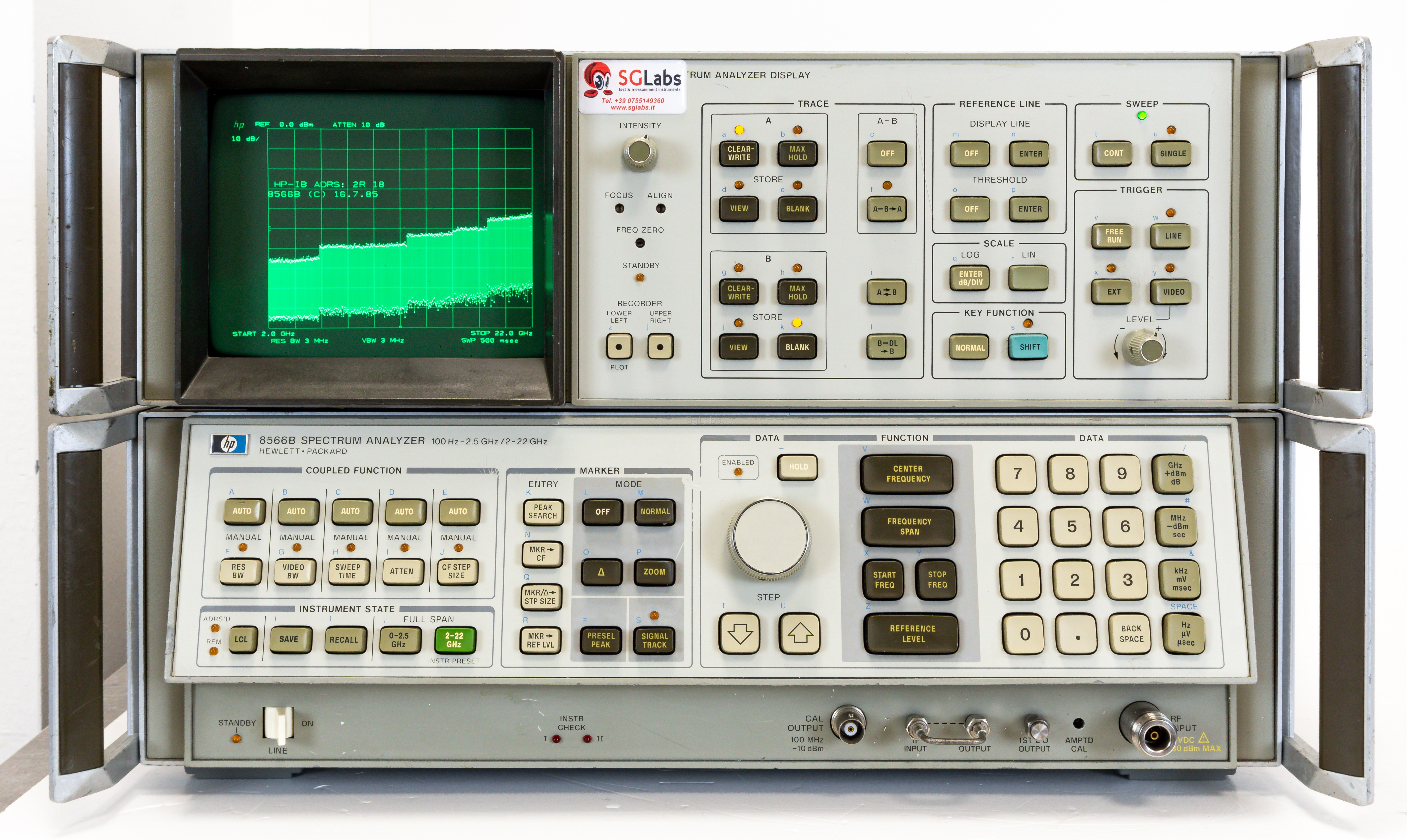

Harmonic mixer in action. I'm not exactly sure why that happens, but I think it's because the higher harmonics have less power than fundamental, so less mixer driving signal => more noise. The 1th mixer sees fundamental and all harmonics at once, since the frequency selection only happens in the front end (YIG tuned filter).
Anyway it's usually a sign that the SA works as it should. See 8566 as example, it uses baseband, 2th, 3th and 4th harmonic, thereby 4 steps in 2-22GHz sweep:
http://www.sglabs.it/public/SgLabs_HP_8566B_1.JPG
Yes, I noticed it is fairly pronounced in various photos of the 8566 - that made me feel better since I think that is like the Daddy or Grand-Daddy of the 856XE series :)
