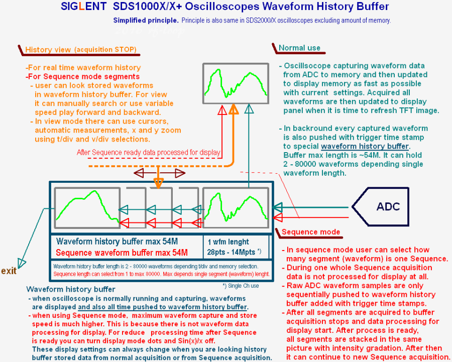

Due to lack of time only this.
I have not SDS2000X at this time for test.
But functionally  SDS1000X+ (SDS1000X  with 16ch LA + AWG)
is very near SDS2000X (with much lower processing power and only two analog channels etc)
Fast Sequence mode can not use if LA is on.
But, now need understand how it works because there is two kind of "segmented memory"
1. Normal run (always with history buffer) (with current wfm/s speed, (in SDS1000X/X+ series max 60kwfm/s for analog channels only on)
If LA on, maximum wfm/s is far more low than 60kwfm/s.  But MSO (analog + LA together) but wfm history buffer store LA and Analog together.  In practice this is just as segmented memory acquisition but it run always backround. Only difference is that this run with current wfm speed with normal live screen.
2. Sequence mode, in SDS1000X/X+ specified over 400kwfm/s (ksegment/s) (in my tests, explained in some thread here) measured quaranteed max 485ksegm/s)  This mode available only for analog channels.
In this fast sequence mode during sequence capture it do not update display or do any other post processing during one sequence acquisition (if run in continuous mode. Afteer sequence is ready it process all segments for display so that  all wfms (segments) overlayed on the screen at once and then continue next sequence). This give all possible resources for acquistion with minimized trigger rearm.
Mask test can not run for history buffer, independent of history buffer acquisition method (fast sequence segments acquisition or normal speed wfm/s (segments) acquisition) (this buffer maximum length is 54M in SDS1000X but length is not simply fixed, so all 54M is not always in use) SDS2000X memory is very different. Measurements and math can run also for history/sequence segment buffer.
(SDS1000X but principle is same in SDS2000X)
I think it is same in SDS2000X exept that it have much more memory and much more processing power.

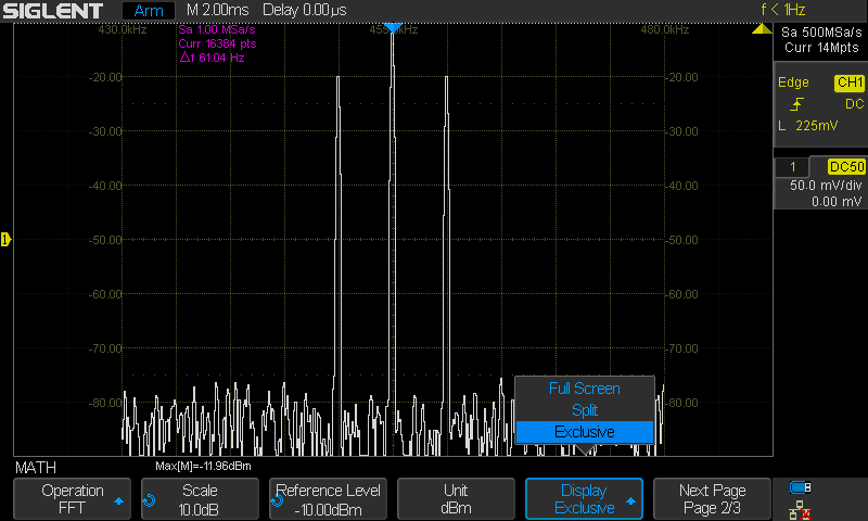

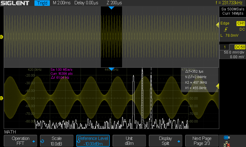

There is no any doubt that GoodWill 2000E FFT is far better than  Siglent SDS2000X or  SDS1000X FFT.
But, still I can use it for IF filter fast adjustment without any difficulties from update speed or any other thing.
These are SDS1102X  (SDS2000X is functionally same but it have bit more processing power.
(note freq counter. It is Trig counter and as can see triger is not continuous carrier (look trig level)
Carrier is < -10dBm 455kHz. Modulation 2.8kHz
Same 455kHz but full window and modulation 5kHz  Watching mod peaks is easy to tune filter. (even better if use dual or triple tone mod)
