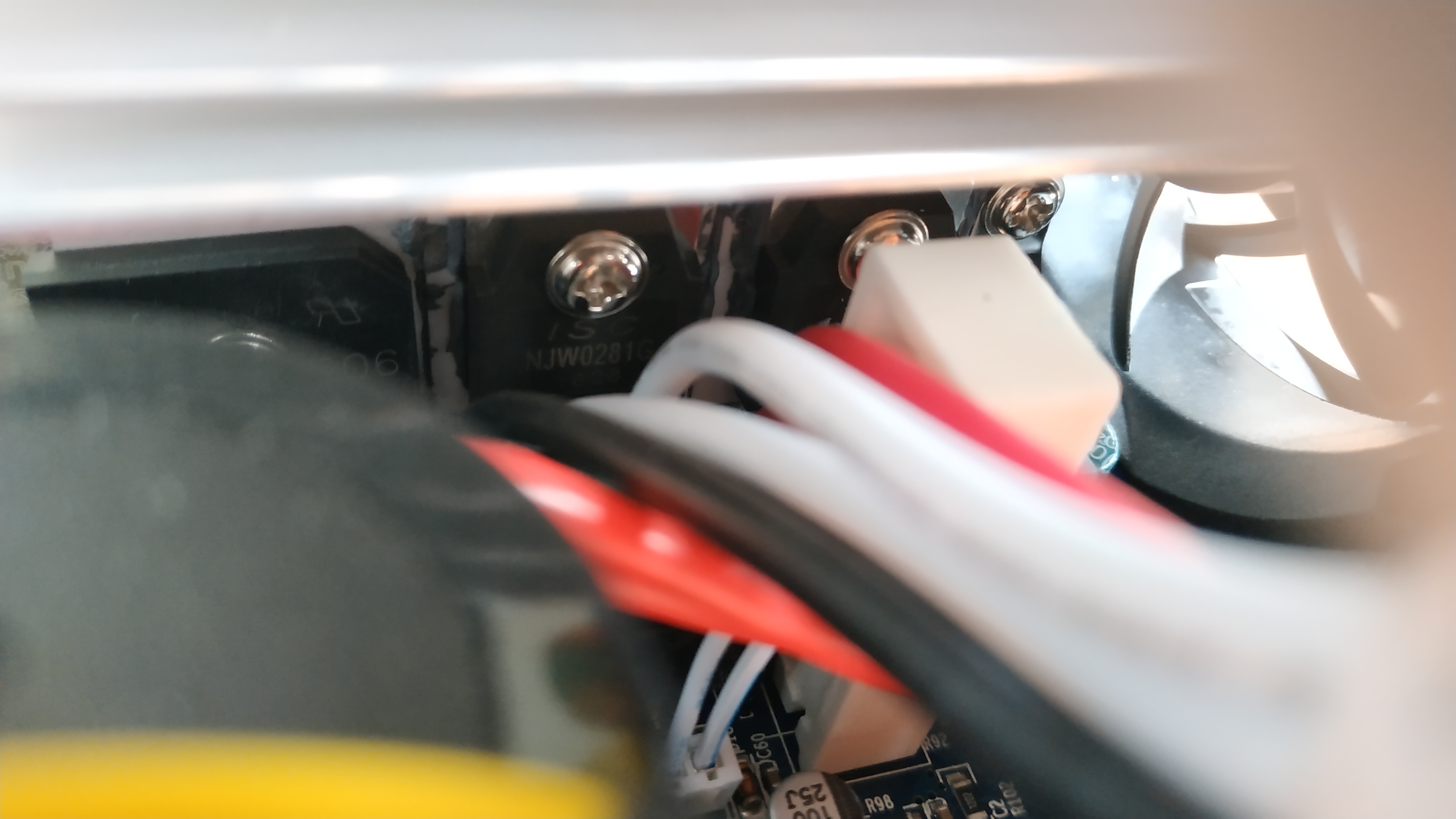

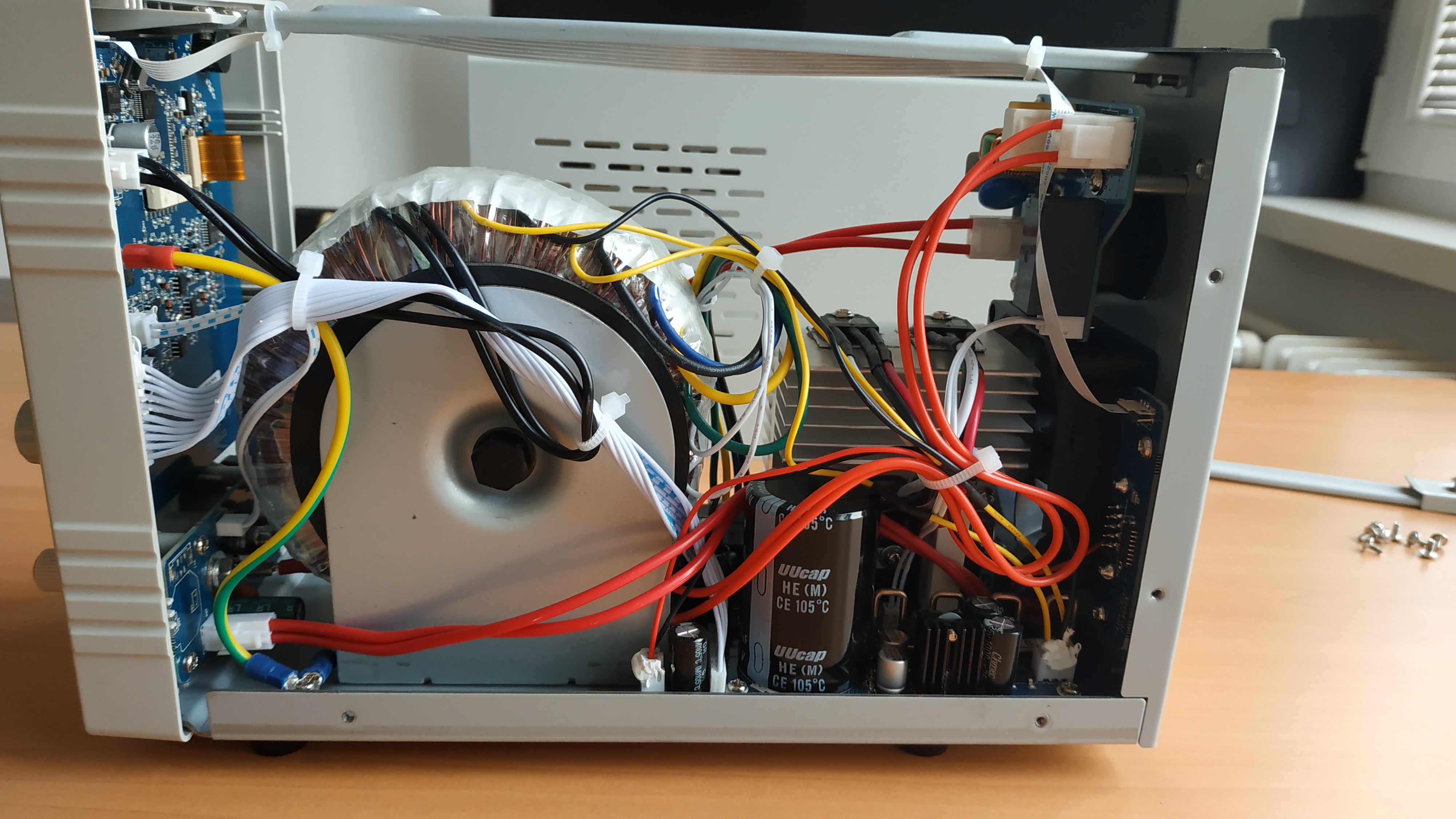

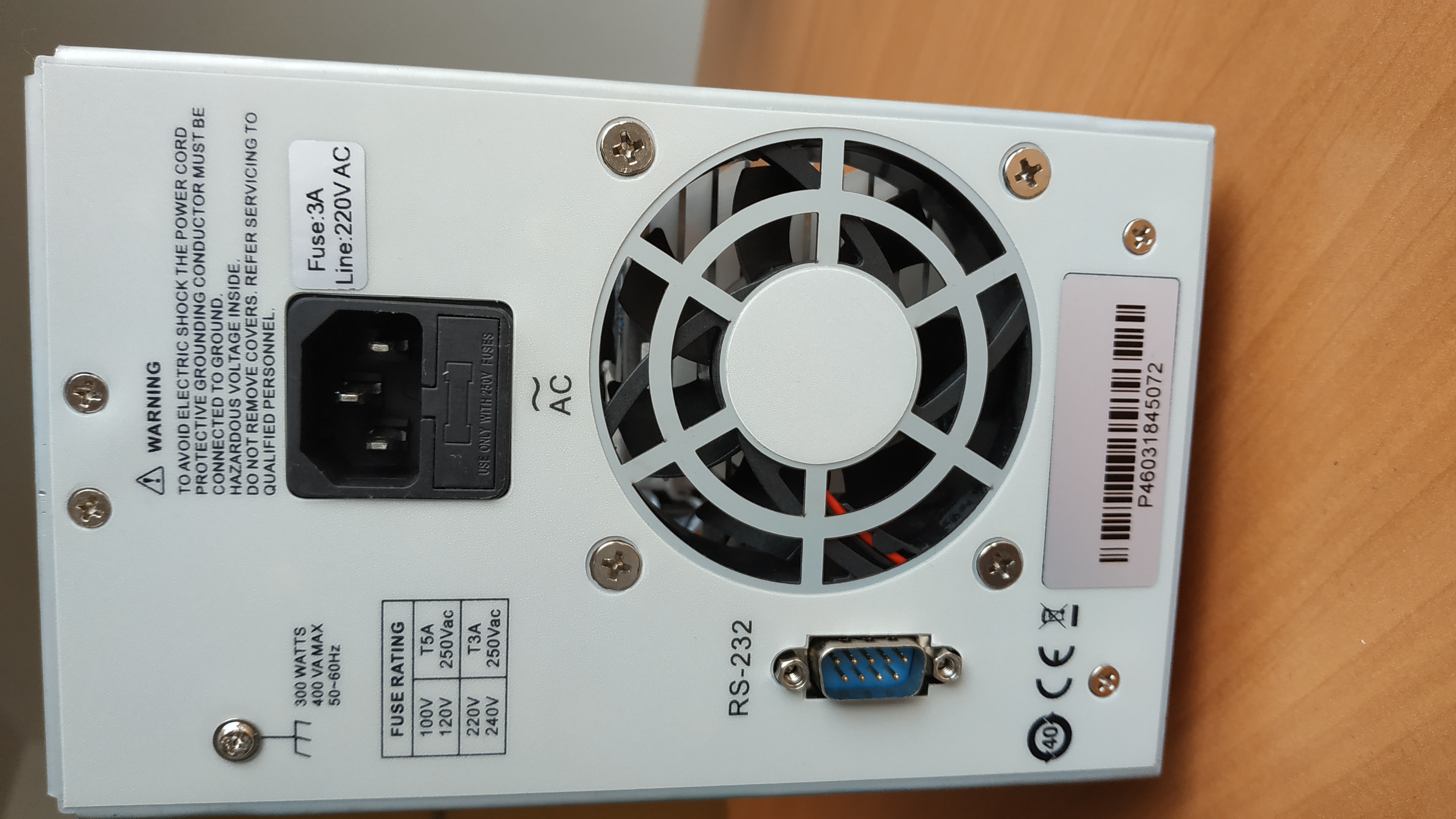

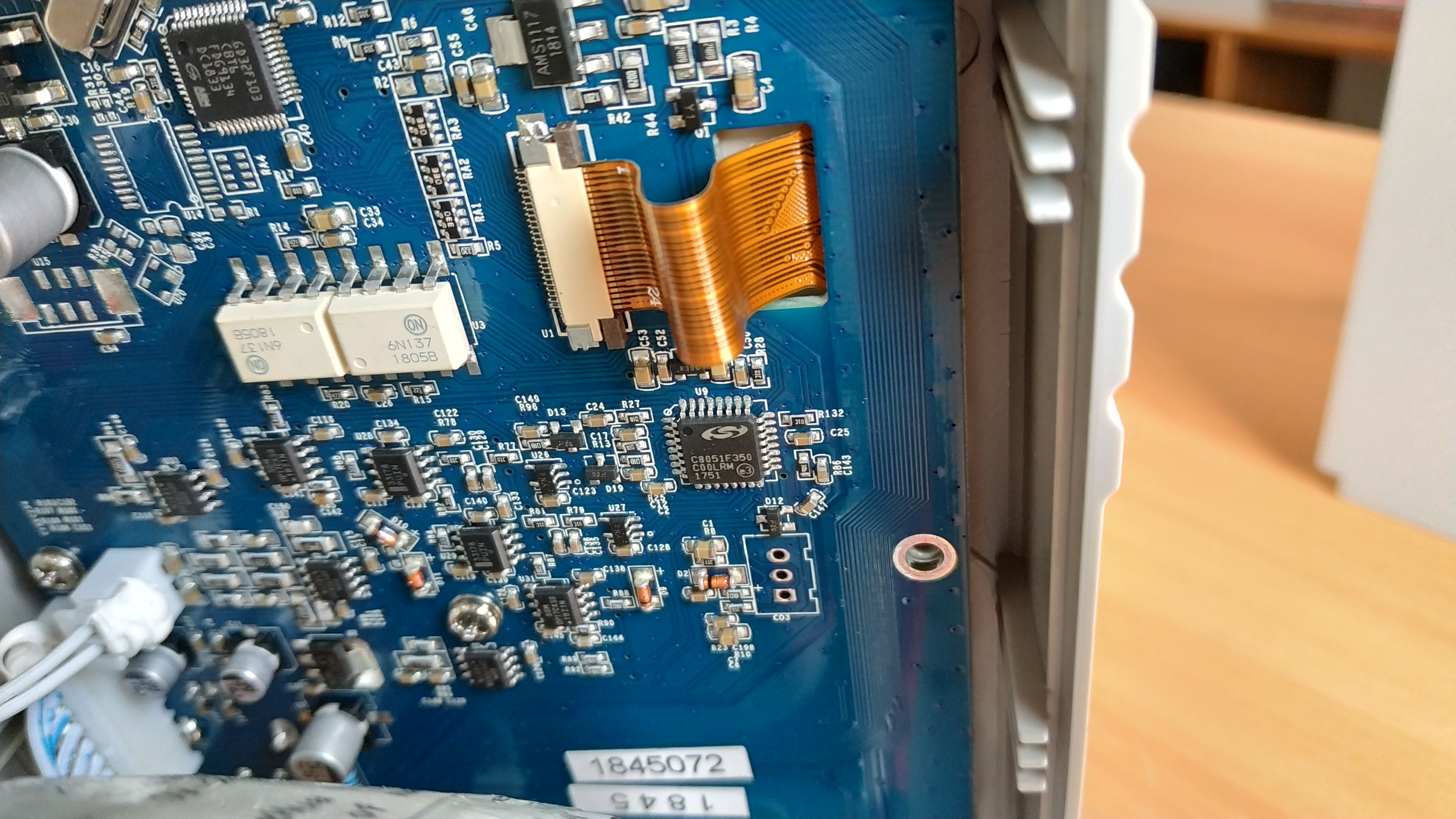

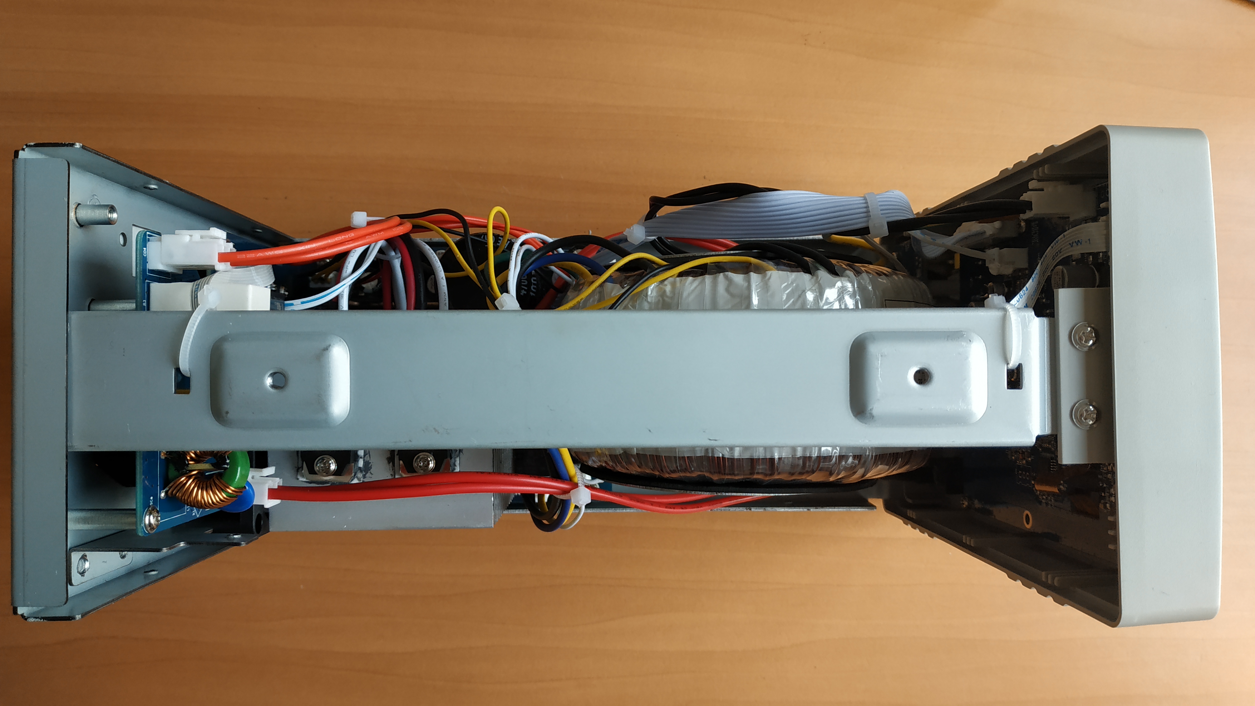

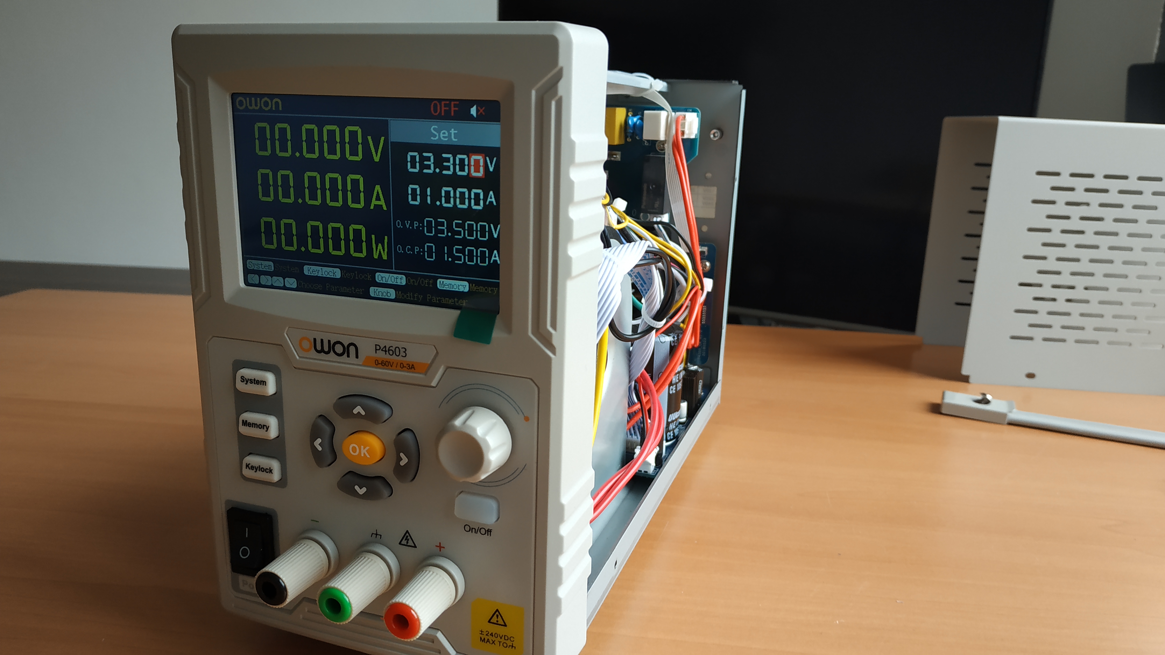

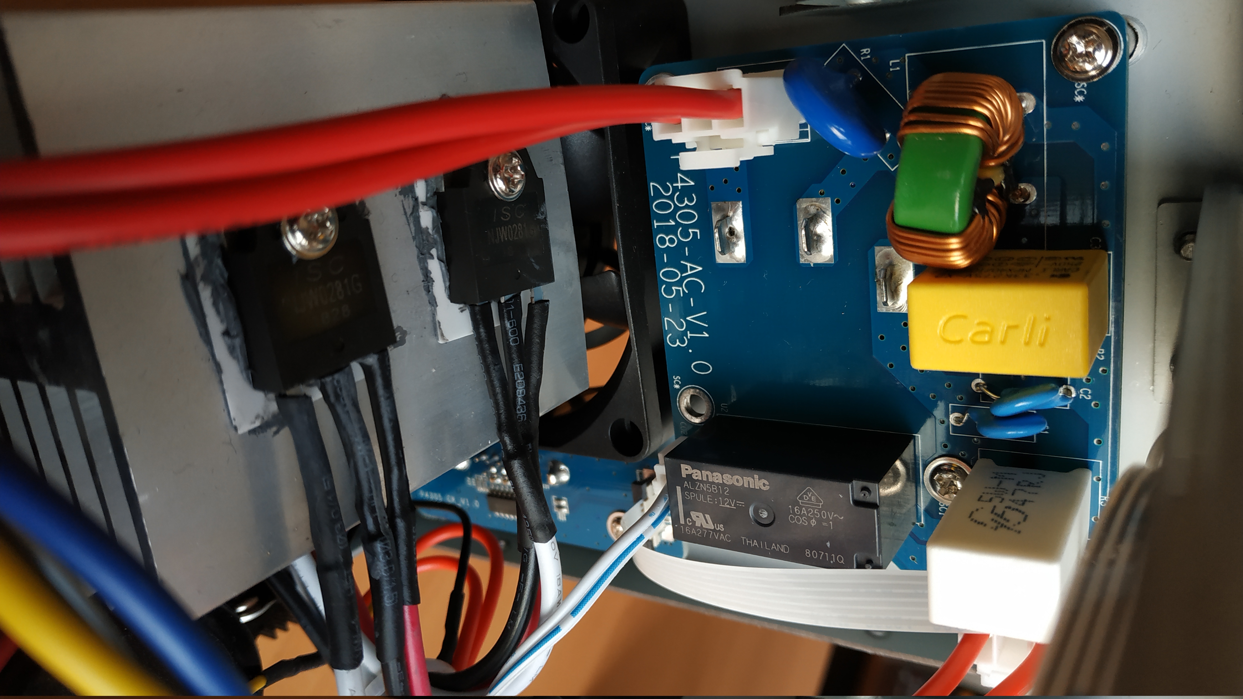

Today I bought a new power supply Owon P4603 60V/3A, 180W, resolution 1mV/1mA, 3.7 inch TFT LCD display, RS232 - 137.55€ (My version does not have USB and Voltage/Current Curve)
Some components:

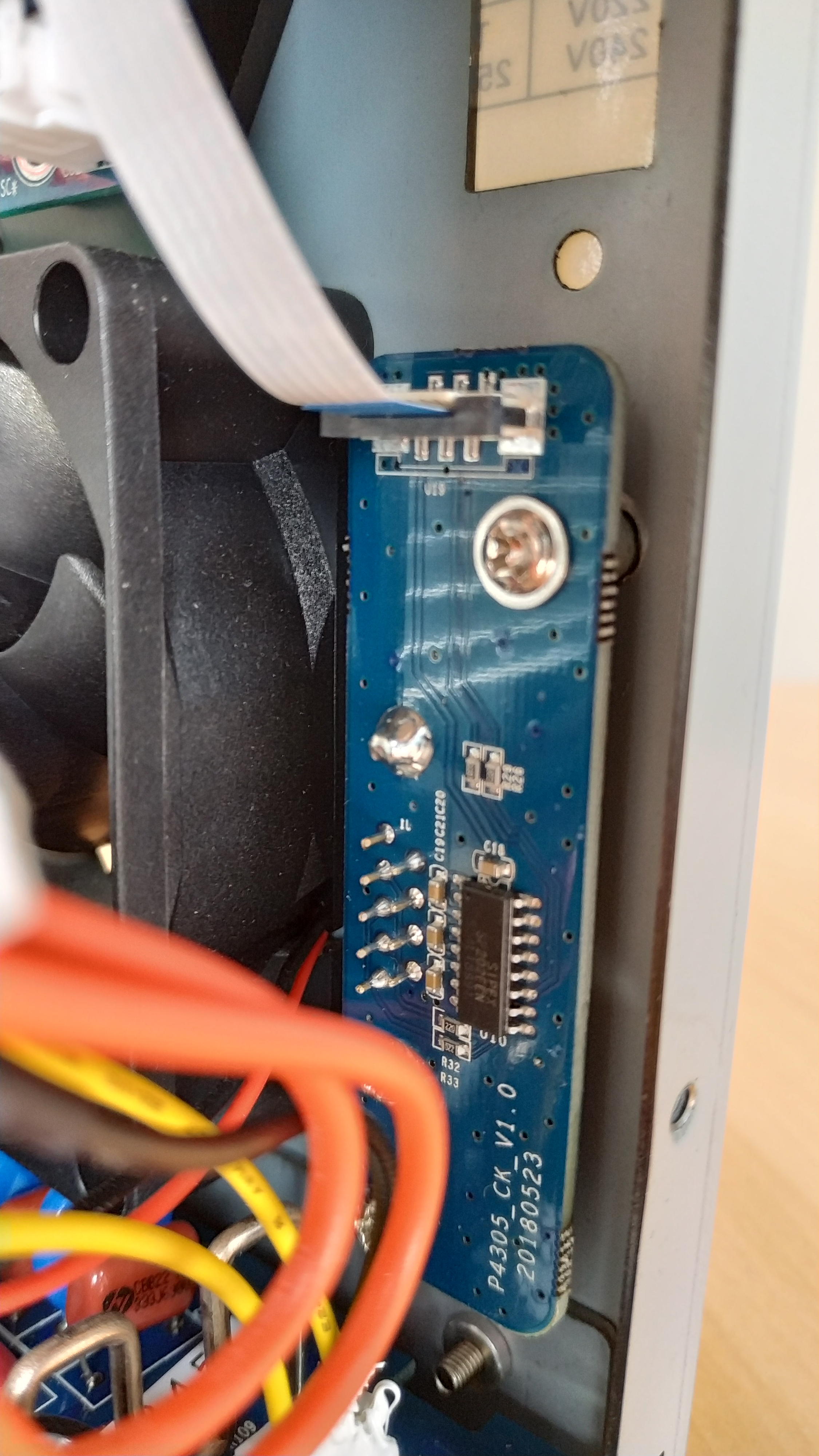

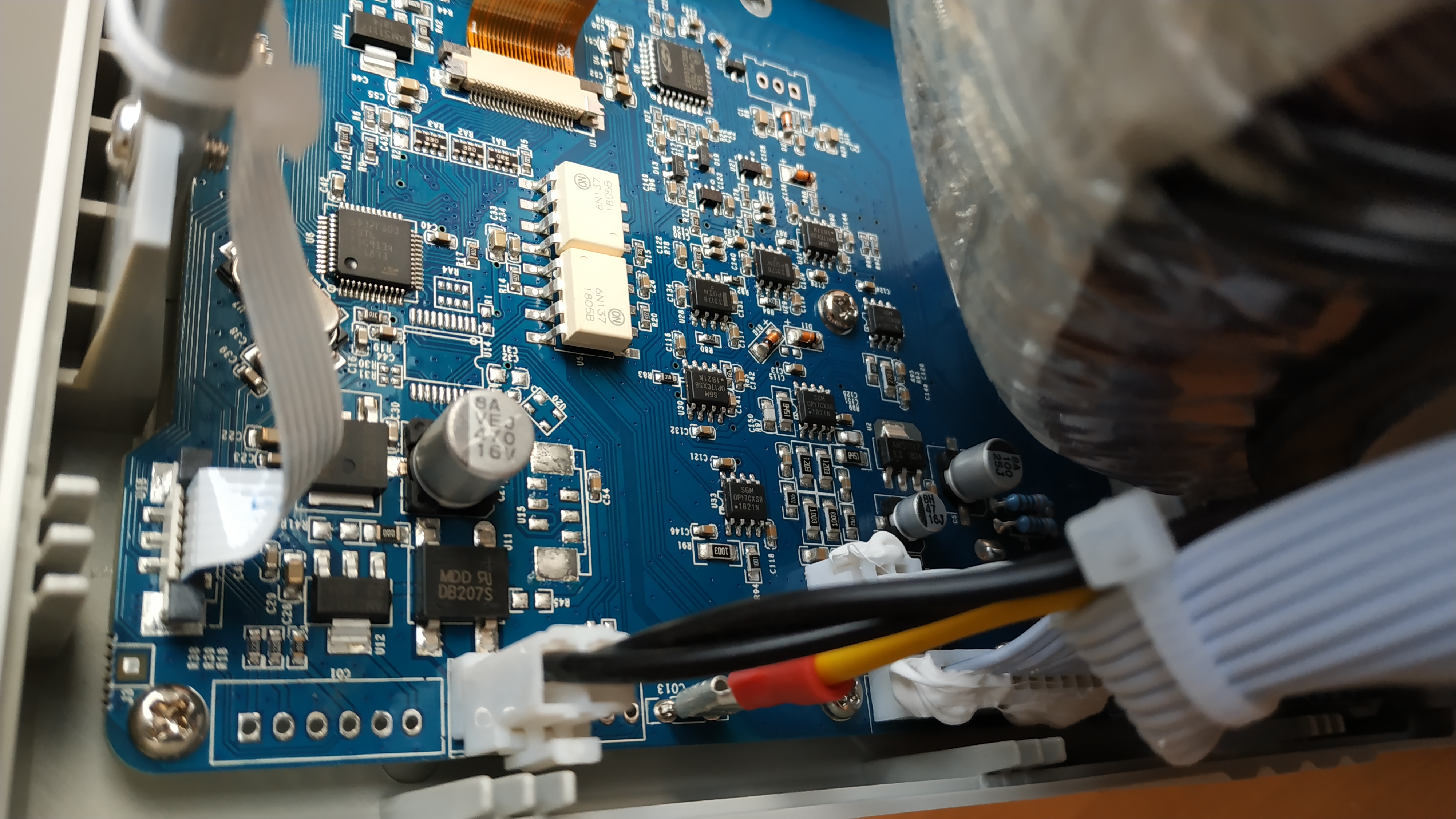

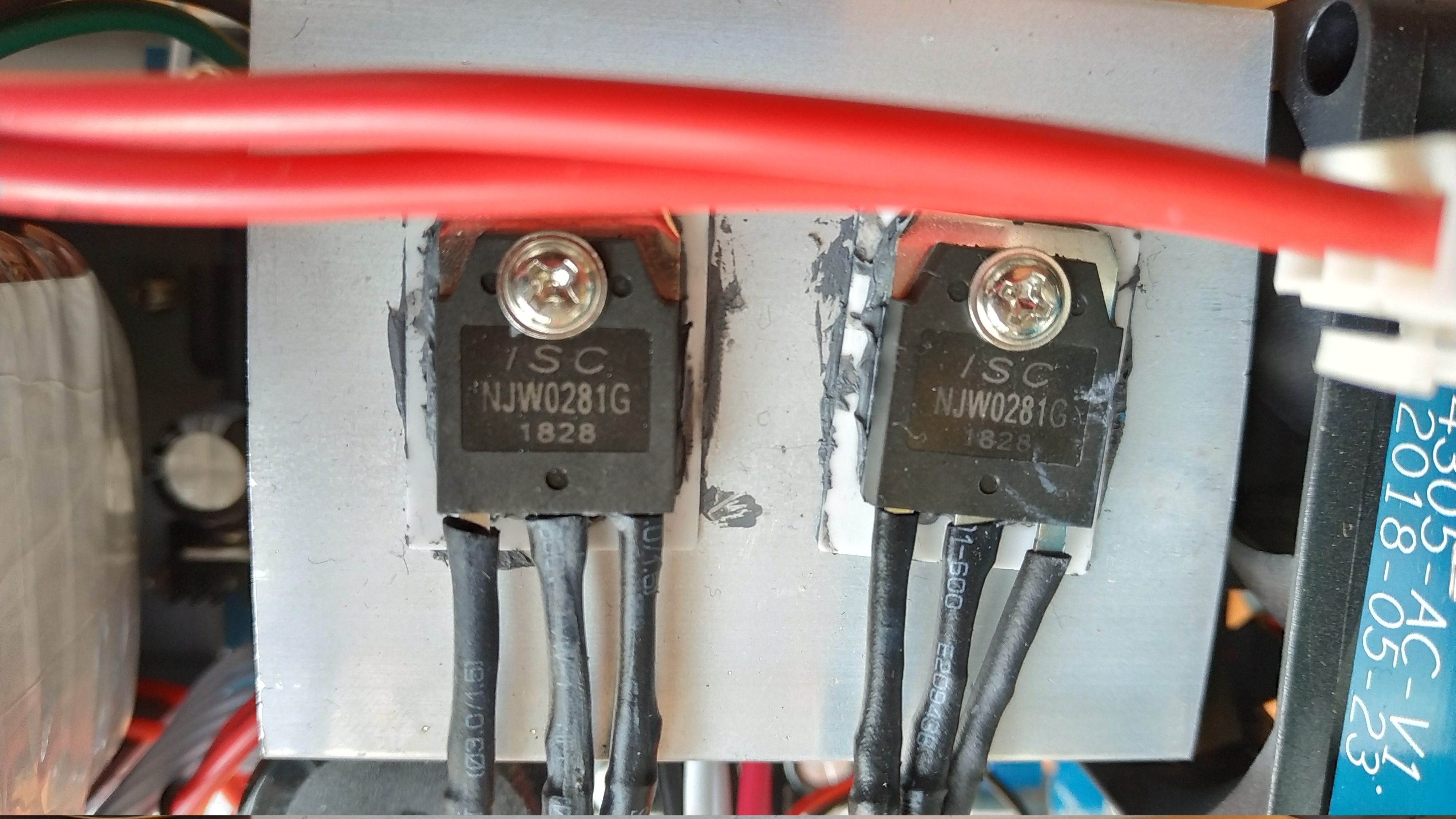

4xNPN - NJW0281G
CPU - GD32F103 + C8051F350 (ADC,DAC?)
Op-amp - SGMOP17C ?

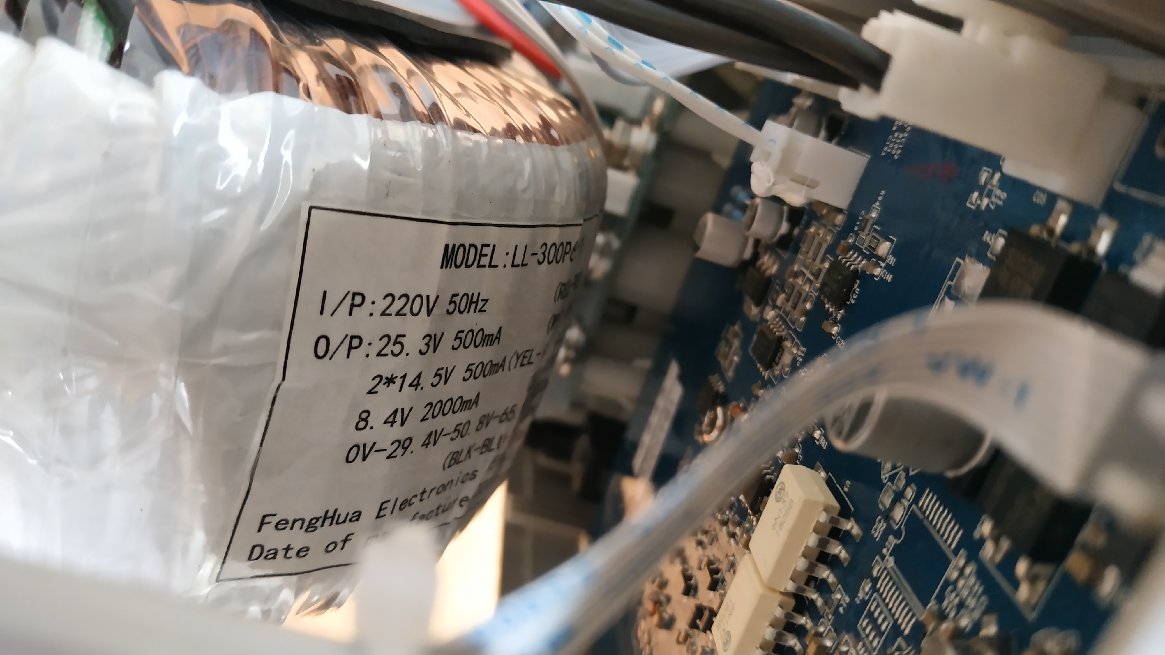

Toroid 250VA ?
Pros:
60V/3A (P4603), 30V/5A (P4305)
Linear PSU
Nice, clear display shows all the necessary information
Simple, intuitive control
Response time <100uS (I can't verify it!)
Adjustment accuracy 1mV/1mA
Power measurement
Backlit button (Output On/Off)
Cons:
The Keylock button must be held for at least 10 seconds
Unable to switch off OVP, OCP (maximum set value 3.1A / 61V)
The changed settings are not saved immediately (system settings, stored values), the PSU must be left on for some time
It is noisy at maximum load
It does not have a USB only RS232

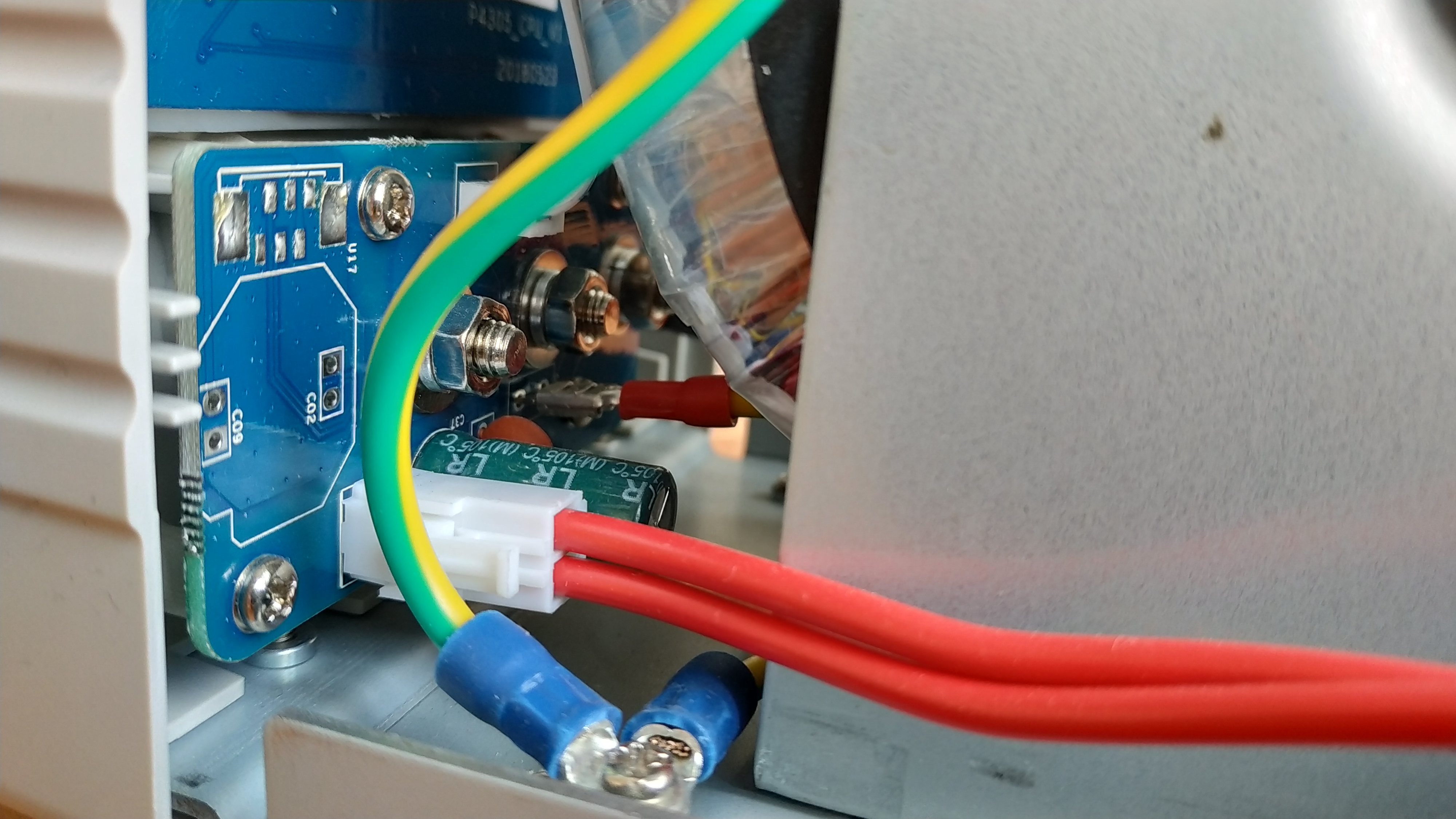

Few photos:

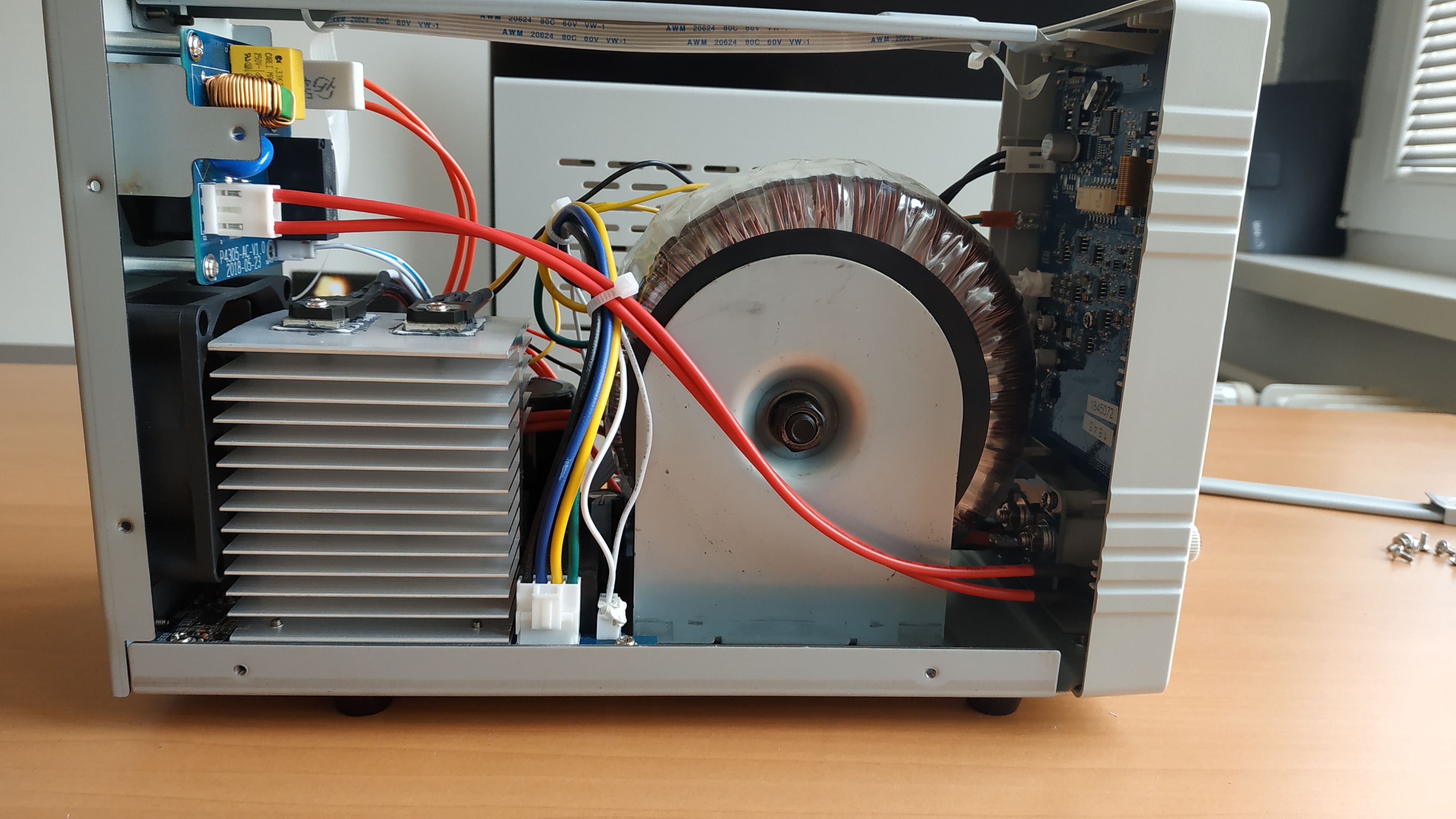

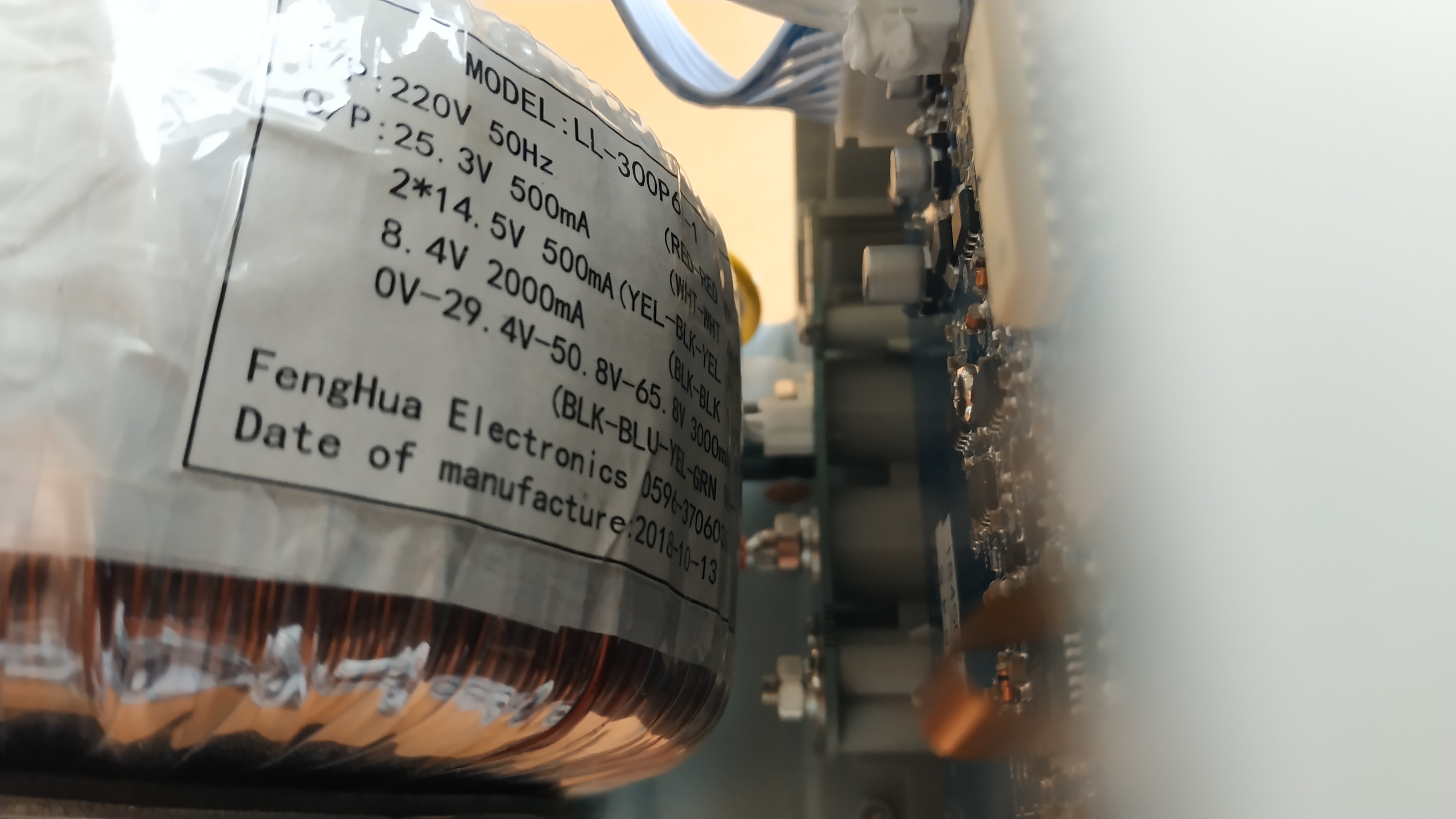

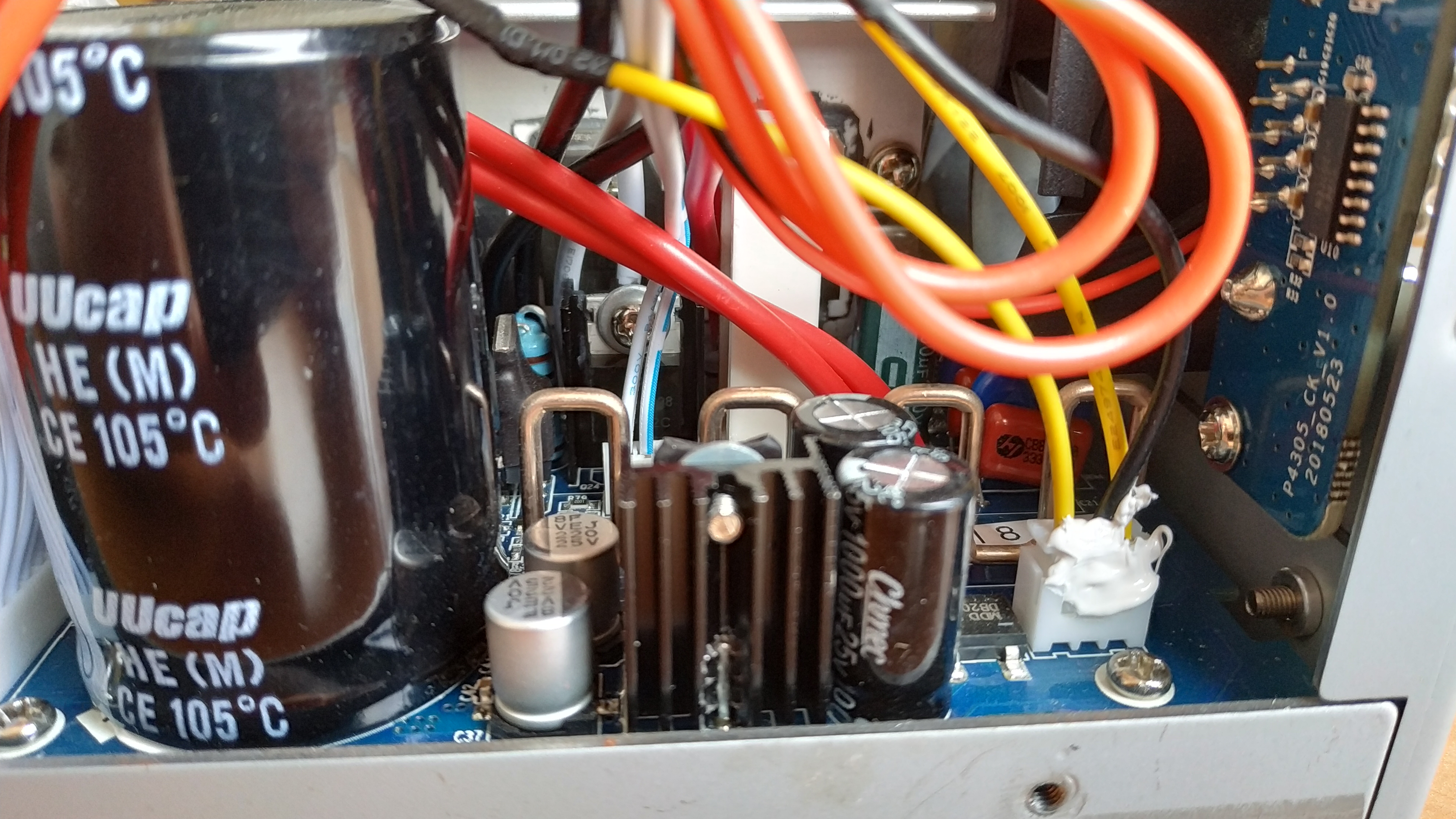

The shunt and the power transistors look good. However the current rating on the transformer is somewhat suspicious, as I don't see a switched mode part. Normally a 3 A transformer is good for some 1.8-2 A of DC current (if the filter cap is no too large). So I would be a little careful using the full 3 A current for an extended time, especially at higher voltage.
The ratings on the transformer could be about 220-250 VA: 3 A at some 65 V + some smaller windings.
The 65 V value is rather high - lots of spare voltage for ripple.
THE C8051F350 sound like a µC with integrated high resolution ADC.

A weak transformer is a problem for most cheap power supplies. :-[
Behind the cooler are two relays for connecting the transformer winding.
I made a video review, you can find it in the first post. (I don't have an oscilloscope for a more accurate review...)

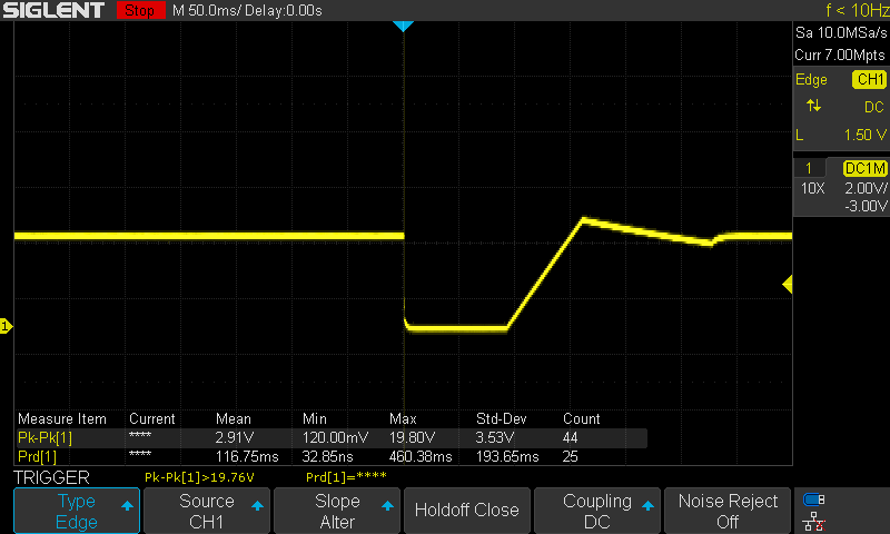

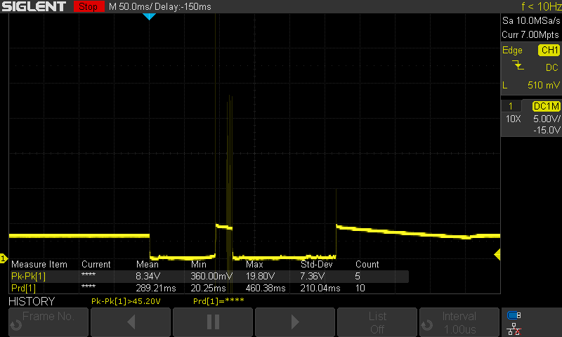

Here are some images from oscilloscope. I'll do a more thorough test later.
Set voltage is 3.3V.
Power On (Main Power 230V)
Short (CV -> CC):
The following users thanked this post: mushthaqgtr, paulbt

It must go some time on to save it. Probably the changes are stored in the EEPROM through the task at regular intervals.
And see the results from the oscilloscope measurement, it doesn't look nice.

I just tested one. Not so bad but the OVP and OCP are useless, and NOT SAFE.
If you set OVP to 6V and set output to 25V, there is 25V at the output and after a delay, it switch off.
The delay is long enough to kill any electronics...
I'll mad a video on it tomorrow and show it.
I see "300" on the photo. Of course it's not granted the rating is real. Only load testing and temperature measurement can tell the truth.

But no. Same spikes when turning AC power on
And O.V.P. is as slow as with OWON version (OVP was set at 13V)
Also any changes in parameters will require up to 25 sec wait time before actual memory save will happen.
