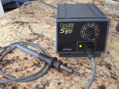

Not quite according to this dude the JBC outperforms the Pace but then I heard the Pace had some issues with its first batch of tips.
Having said that I have owned a Pace PPS-15 and PS/80 and PS/90 handsets for the last two decades and it still keeps up with the JBC and Hakko direct heat irons according to the copper clad tests that Dave has done. Probably attributable to huge thick heating barrel, thick tips and secure grub screw arrangement that keeps the tip tightly in contact with the heater. A great iron that is still going strong. Not sure if it can handle lead free soldering though.

It's hard to draw exact comparisons for those reasons but I would say all things being equal it's closer that it looks. The Pace as of firmware 1.4 now displays and is set in single degrees, they also slightly improved the performance as well.
