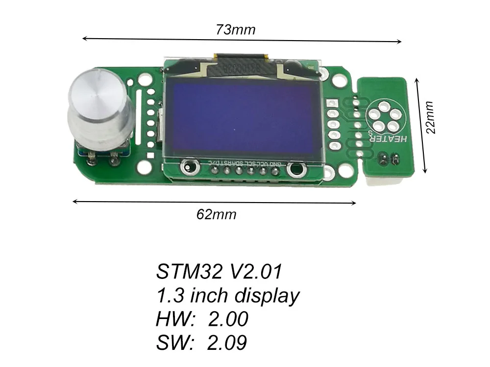

Offline snoopy
  • Posts: 778
    • Analog Precision

Offline snoopy
  • Posts: 778
    • Analog Precision
Re: JBC CD-1BQE
« Reply #92 on: June 13, 2019, 02:17:16 pm »
I bought two units from different ebay sellers but there are several versions from the official KSGER seller on aliexpress
https://www.aliexpress.com/item/32836043839.html
Does anyone know what sort of display module is used on these ? Looks really good ;)
cheers
« Last Edit: June 13, 2019, 02:20:00 pm by snoopy »
Offline Gandalf_SrTopic starter
  • Posts: 1729
Re: JBC CD-1BQE
« Reply #93 on: June 13, 2019, 02:24:33 pm »
Snoopy, that looks like my head unit.  It's an OLED display, do you want the actual part number?
If at first you don't succeed, get a bigger hammer
