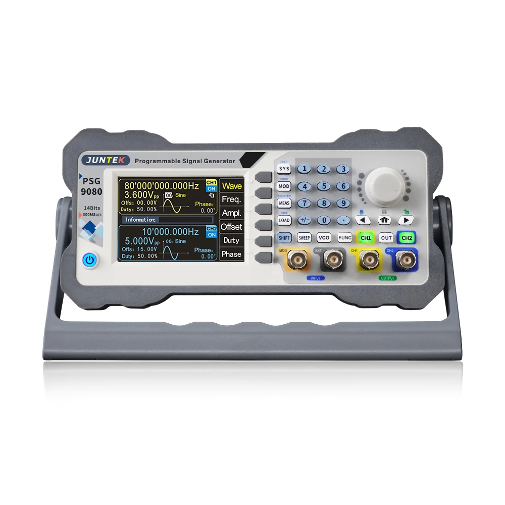

Just got this unit. Front panel is beautiful and convenient in use.
Some buttons have glowing back-light, it looks very cool in the dark :)
Device case has a convenient stand and looks very good.
Output amplitude up to 25 Vpp (12.5 Vpk) below 1 MHz.
1067730-0
Minimum amplitude 1 mVpp (0.5 mVpk).
1067734-1
DC offset can be set from -10V to +14V with 0.01 V resolution.
Here is 11 MHz 6 Vpp with 50 Ohm oscilloscope input:
1067738-2
It has modulation mode from internal or external source.
1067742-3
Also it has a frequency meter and pulse counter mode for external source.According to my tests, the minimum sense voltage for external input is:
- 0.65 Vpk with AC coupling;
- 2.4 Vpk with DC coupling.
Let me know what you want to test :)

Some teardown.
Front panel:
STM32F103RCT6
Crystal 8 МГц
LCD 3.4"
Frontend:
Xilinx Spartan-6 XC6SLX9
FPGA clock oscillator - 50 MHz
Relay HUiKE HK23F-DC5V-SHG
usb-serial CH340
Other IC's marking is scratched.
It looks like it uses R-2R DAC.
The following users thanked this post: thm_w, TurboTom, coromonadalix, mawyatt, electronx

here is fpga oscillator
