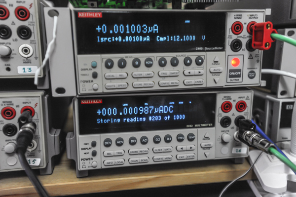

« Reply #36 on: August 11, 2015, 03:18:49 pm »
I tried at my site, 2400+2002, with rather long cable BNC-banana, bounce around 150-200pA.
Update:
2400+2002, StdDev = 50.31pA, Avg = 951pA, Min = 818pA, max 1119pA, 500 samples, 50 NPLC
2400+2001, StdDev = 22.11pA, Avg = 1025pA, Min = 969pA, max 1076pA, 500 samples, 10 NPLC
Measurement steps:
2400 set to source zero current, Vcmpl = 12V. Multimeter set to REL to null offset current. SMU set to 0.001uA, measure 500 samples on DMM.
« Last Edit: August 11, 2015, 03:55:38 pm by TiN »
