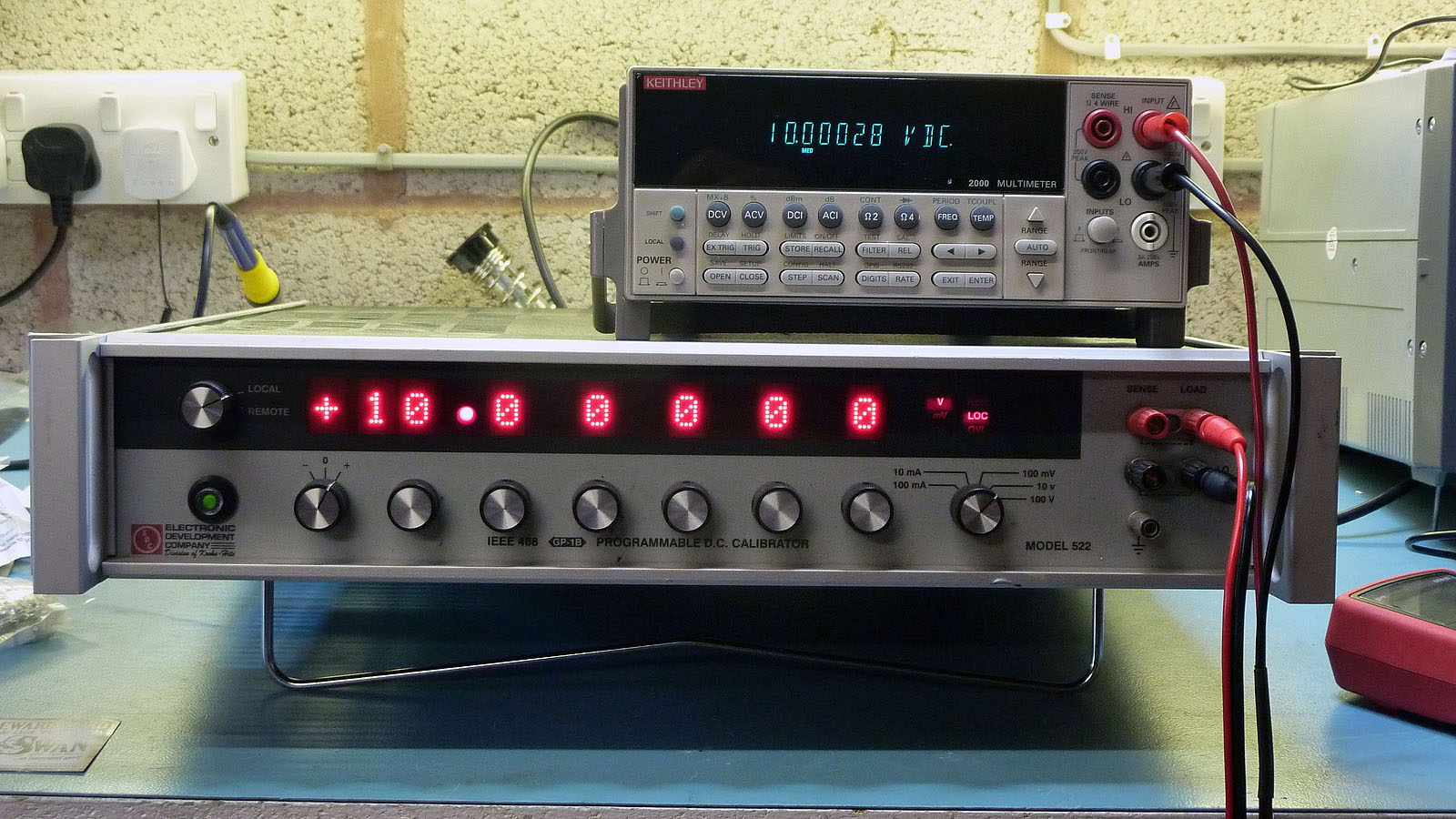

I'm not sure I count this as a "score" - it still cost me £94 (= USD 145 or AUD 186) but I spotted a Krohn-Hite Model 522 calibrator on ebay and (as usual) couldn't resist.
Sold as "doesn't power up" - well, not sure about that, it powered up just fine when I unpacked it. There was no output at the front connectors but that was a simple matter of changing the jumpers from rear panel output to front panel output  >:D
Of course it would be nice if the Keithley read 10.00000V but, in fact the above reading is in spec.
The 522 has an accuracy of ±0.002% of the setting plus ± 0.0005% of range plus ± 0.0005% per oC plus ± 2uV giving, for all intents,  ± 25ppm in total (ignoring tempco and the 2uV which is 0.2ppm on the 10V range)
The Keithley's 1 year accuracy is 50ppm of reading plus 35ppm of range giving 85ppm at 10V (and this one hasn't been calibrated recently) so any reading from about 9.999V to 10.001V would be acceptable. Sadly the 522 is not quite accurate enough to check the Keithley and vice versa.
My 2015 says 10.00022V which agrees pretty closely with the 2000 (just 6ppm difference) so I suspect that the 522 is slightly high and either just within it's spec or just out but I can't really tell.
Tear down pics later.
Does anyone know what the difference is between this model and the 521 - the few pictures and specs I can find on the web don't really seem to show any difference at all.
Finally is there a service manual - the manuals on the web all seem to omit the theory of operation and schematics. There's a 521 manual available, but I'd quite like the correct manual if possible.

Oooohhh.... That's a beautiful oldskool display. ^-^

Wonderful instrument, flat case and just beautiful display!!  :-+ :-+ :-+
Did you already check all ranges, including current vs. your Keithley?

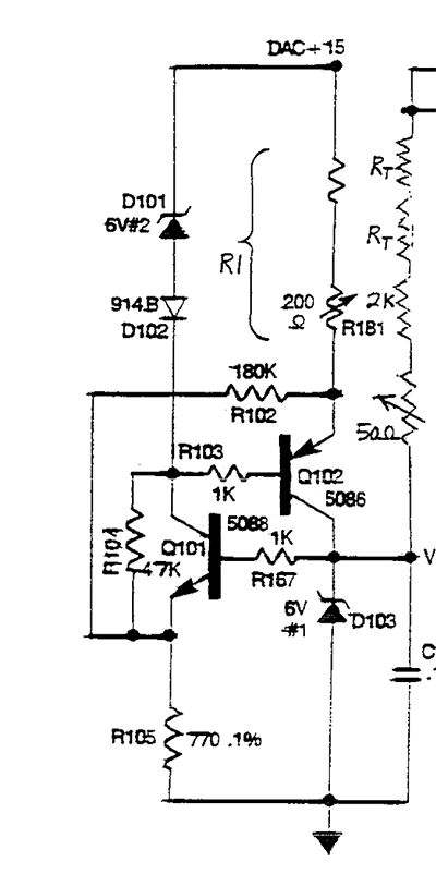

I am looking forward to the teardown.  ;)
Especially the reference.
The reference itself is pretty much identical to the one in the MV106J that Dave had in EEVBlog #210, a low tempco zenner fed from a constant current source, remarkably unremarkable given the spec of the unit which is similar to the MV106J (0.002% of setting rather than 0.003%)
This is the circuit from the 521 manual

A quick go/no go check, but both of the current ranges and the 100mV and 100V ranges seem to work OK as well as the 10V range.

With respect to the tempco of the 1N829 reference zener:  one trick we  used in grad school was to measure a set of reasonable reference zeners in an oven at different current values.  Each individual zener would have 0 tempco at an idiosyncratic current value (while the catalog value was typically at 7.50 mA).
  • Posts: 2931
Re: Krohn-Hite 522 DC calibrator.
« Reply #16 on: March 09, 2015, 03:27:12 pm »
I'm pretty certain that is what is done with all of the EDC voltage standards - if you look there is a small sticker on which is written a specific current/voltage so I think this is the zero tempco current for the diode.
