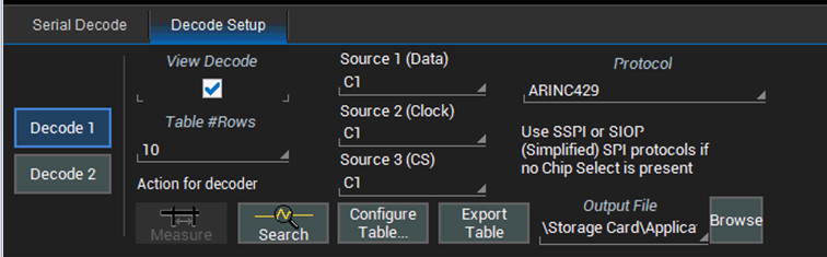

I have the option unlocked, selected in the channel, but no way to get any analysis (1s and 0s :) ) showing up.
Nothing in the manual, either. Some stuff online, but only advertising material. Not showing how to set it up.
ARINC429 has no separate clock or CS. It has two signals which are complementary, so only one of them should be needed, for a scope display.
How is one supposed to set this up?
I know that a couple of years ago this scope was used for SPI decoding, by somebody else. IIRC this required one to set up a zoom region and it would decode data within that region. This doesn't seem to do anything either.
« Last Edit: December 26, 2021, 10:49:02 am by peter-h »

What Martin says is that that scope shouldn't have ARINC429 as an decode option at all.
Avionics family of protocols start at HDO4000A series (and only basic ones for that one).
If that option was enabled by "user generated code" it might be that scope accepted it in license validation part, but since it doesn't have actual decode code for it, it called SPI decoder by mistake. Something is wrong.
For ARINC you need only one signal (A, B, or differential and setup for that choice), and you need to chose word format (data encoding). Threshold, maybe parity and baud rate. That's all.
Your scope is in a weird state.

Do you mean it is not showing required config options?
Offline 2N3055
  • Posts: 7462
  • Country: hr
Re: LeCroy 3034 - how to set up ARINC429 data display?
« Reply #5 on: December 26, 2021, 12:56:55 pm »
Exactly, those are SPI decode setup options...
I would reset scope to factory defaults, try some other protocol (like UART or I2C) and see if they show proper setup dialog.
Then, again, try ARINC, and if it again shows SPI settings dialog, something is wrong.
I already said what I suspect is happening.
Officially there are no avionics protocols available for old WS3000 nor new WS3000Z. Basic (TD) avionics protocols decode start with HDO4000A, and advanced trigger/decode/graph/measure/eye (TDME) start with HDO6000B  and up.
Dr. Richard W. Hamming

I can't get any decoding to work on ARINC429.
Where is the config option for factory defaults?
I went to the update firmware option and it said it needs a BIOS update, so I selected that. The firmware was from March 2021 anyway, which is much later than the date after which this scope was "discontinued" :)
It then showed a very bright colour screen (four rectangles) with a counter which ran for a few mins. It ended with SYS UPDATE DONE. No idea what that was about!
Then it rebooted. Old config preserved.
It is doing "something" because if I tick the Decode On checkbox, the scope really slows down - as if looking for data. I think one of the screens has changed a bit
« Last Edit: December 26, 2021, 06:12:46 pm by peter-h »

Why not first try to decode something the oscilloscope is supposed to support like (I guess) UART, I2C or SPI? Now you are tracking 2 problems at once. You can split that into 2 seperate problems by first getting something to work that should work for sure.

Like I said already, my theory is that someone  used "homemade" key to enable ARINC on a scope that doesn't support that.
Scope is now behaving weirdly..
All LeCroy MAUI scopes use same windows software for PC based platforms.
For embedded platforms like WS3000 some porting was done to WinCE (ARM) and it is possible that license manager was ported in full. And it is known thing that license manager doesn't really check options much for validity for specific platforms.
There are many occasions where users of x86 based scopes had problems after enabling options their particular model didn't support. License manager happily let you do so, and later you had problems with scope.
Normally you don't have that problem because LeCroy wouldn't sell you option that is invalid for your scope.
Your scope never had and never will support ARINC. Even if LeCroy decides to add ARINC (and/or other avionics protocols) to WS3000 class device they will do it for new, current model 3000Z.
