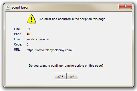

On a related note, does anyone know how to stop this WaveStudio startup error, when it tries to display Teledyne Lecroy News (presumably a dead URL now) at each startup
I can't find a config for it.
It looks like they have implemented a primitive web browser in there and it is out of date. Answering Yes or No produces the same result. Eventually the errors go away.
« Last Edit: December 05, 2025, 06:50:31 pm by peter-h »

« Reply #7 on: December 07, 2025, 04:41:12 pm »
Is the invalid character error from the scope or web file?
Maybe the machine does more of those "secret" connections.
Add your own server, Arduino is just fine.
Find scope's hosts file and add name-address mapping manually.
Then you can answer to all requests, maybe sending a simple html file.
Other channel can report what was requested.

The scope's PC interface software displays that when started.
I am not bothered about these startup errors. A lot of equipment does this after some years, as the URLs which it accesses to "call back the church" go dead, or are changed to serve JS which the equipment doesn't support because it has only a primitive browser.
I can't tell if the "invalid char" is from the scope or from the Lecroy website. I would assume the latter since you get it regardless of whether the scope is running.
Offline m k
  • Posts: 3407
Re: LeCroy 3034 losing ethernet connection
« Reply #9 on: December 09, 2025, 10:37:14 am »
Website is more probable.
I guess you must check scope's network activity.
