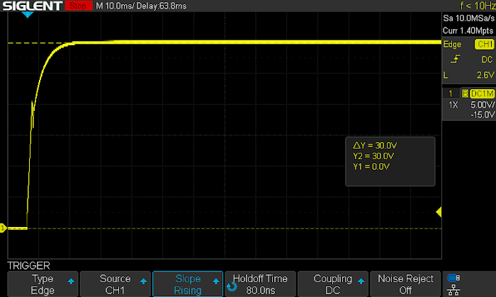

5. Open Circuit Power-up Ramp: BK Precision on Left and Matrix on Right (Note - BK ramps much slower so time base is 10ms vs Matrix 1ms)
Above shows the ramp for a 1V output.
Above shows the ramp for a 5V output.
Above shows the ramp for a 10V output.
Above shows the ramp for a 20V output.
Above shows the ramp for a 30V output.

Overall, I am pretty impressed. There are a few things that I think I could evaluate better. If anyone has any suggestions, I would be happy to experiment further!
