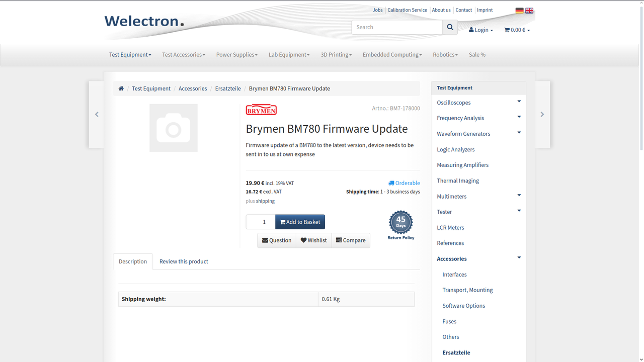

The german dealer "welectron" offers a FW update for the Brymen BM780 series for 20 Euros plus shipping. Maybe you can "persuade" them, not to look at the colour and/or model number...eventually he/she is even part of the EEVBlog-Forum...
bilder hochladen handy
https://www.welectron.com/Brymen-BM780-Firmware-Update_1
Cheers!  ;)
