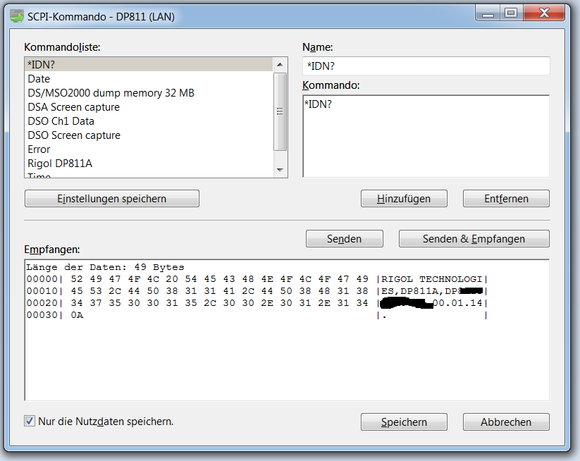

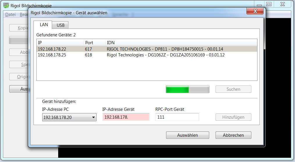

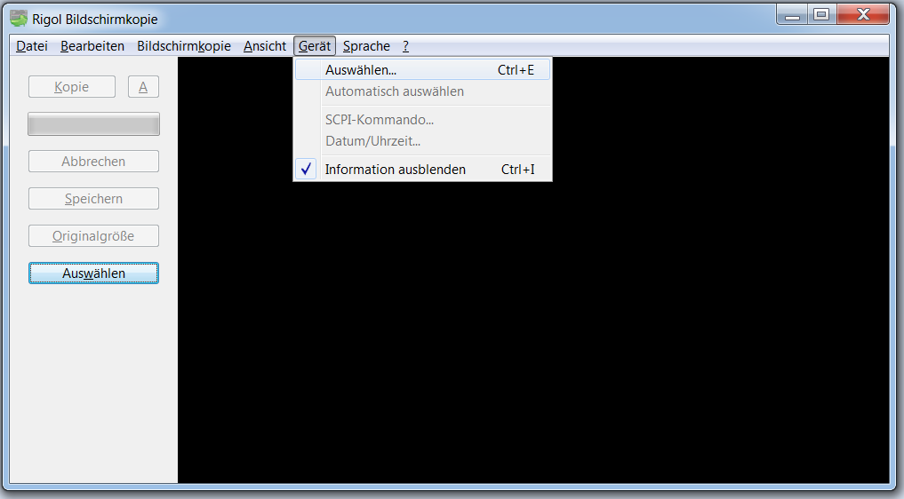

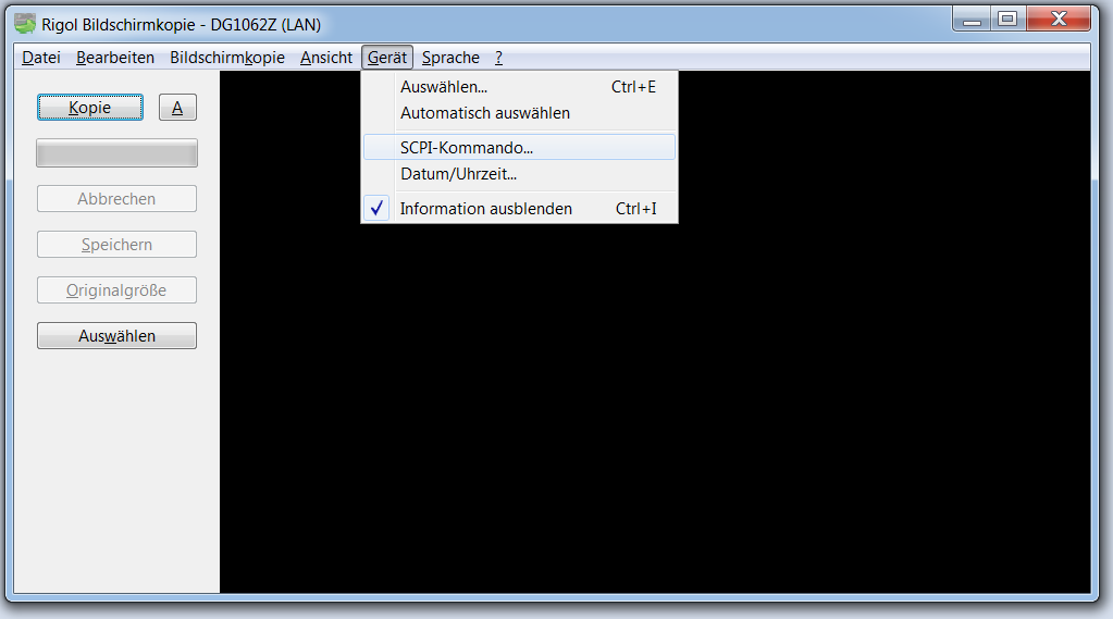

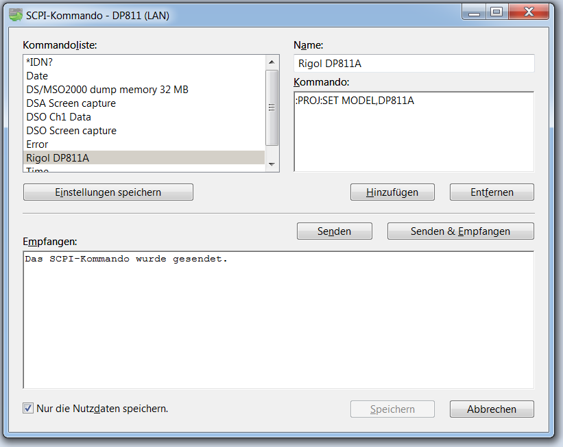

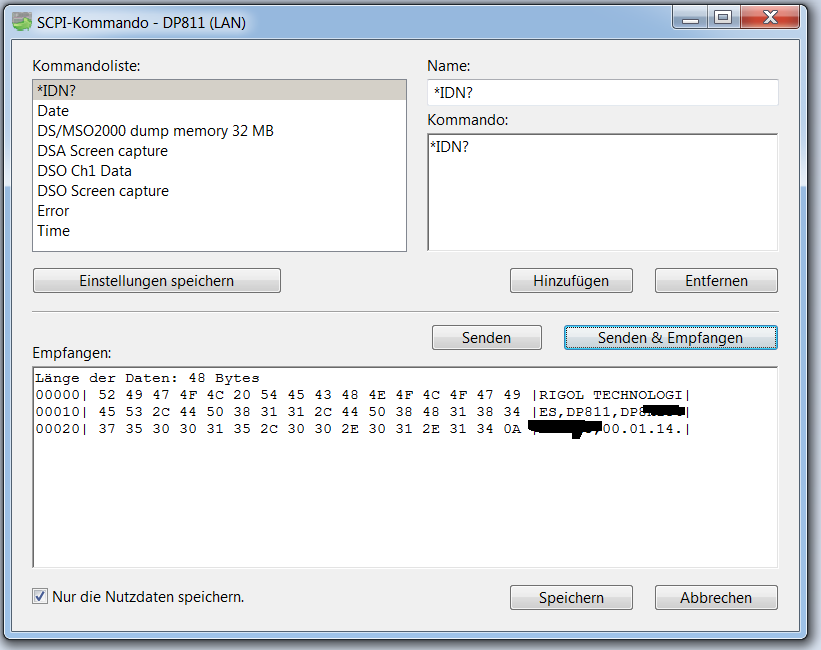

I also used another program to do the hack
I have not tested it but with proper USB drivers you can do it without LAN
I used the Rigol Bildschirmkopie Tool to do so, but CMD works as well with telnet
http://peter.dreisiebner.at/rigol-bildschirmkopie/index.htm
I tried Bildschirmkopie only via Network, maybe someone makes it work with USB, but this needs correct IVI drivers to send commands
Step 1
Activate Telnet in your windows features and restart PC
Step 2
connect the function generator to the network
check if connection is good with ping
also a firewall may cause problems even with ping working, the DG1022Z I could only get sent SCPI commands on a very old standalone PC in my basement shop
step 3
get a FAT formatted USB stick and write the keyfile.bin in the main directory
https://www.eevblog.com/forum/testgear/need-help-hacking-dp832-for-multicolour-option/?action=dlattach;attach=696567
Step 4 with Bildschirmkopie
- start it
- ctrl+E to do a search on the network and connect the Rigol device
- search for devices and choose the one you want to unlock
- open SCPI commands
- check device signature
- send SCPI command with new Model name
- reboot device and check again device signature
