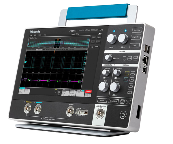

AFAIK Tektronix has VESA mount holes on their oscilloscopes as a standard.
I could be wrong but I got the impression it was only on that new model, and mostly because it's usually screwed to a pretty stand.
Lots of people have commented on it though. Maybe it will become more common.
