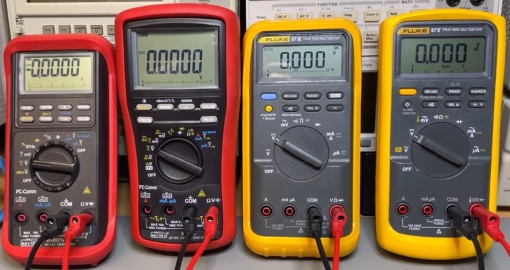

1. What is the functional difference between 850 and 850s series? Words like *s*uperb and *s*wift keep popping up throughout the latter's brochure. But that in itself does not imply that much...
I don't think there's much electrical difference but take a look at the backlight in this video, it's one of the things they changed:
The 's' version of the 857 has a nice even, orange backlight (like the 257 in that video).
(also note the size difference between the 857 and the 869. It's not something to trivialize when your bench is getting crowded)
Dave says the 857 is on the way out in that video but Brymen is still selling it.  :)

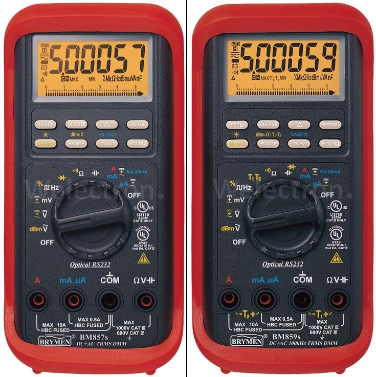

I think you meant another model or it is a typo: It's quite a lot smaller than a BM859s: 869s ?
..., as the 857s (160 Euro) and 859s (200 Euro) are the same in size, but differ in temperature measurement; 0,02% (vs. 0,03%) accuracy and 100kHz (vs. 20kHz) bandwidth.
Here are the pictures of both models:
soon in stock:
https://www.welectron.com/Brymen-BM857s-Multimeter_1
on stock:
https://www.welectron.com/Brymen-BM859s-Multimeter_1
Cheers! ;-)
The following users thanked this post: HAO
Yeah, Typo. I meant the 869s.

soon in stock:
on stock:
Me? If I have to choose between those two I'd get the BM857. I don't need temperature in my multimeter and putting the diode range on a separate position is a good thing.
The only shared range in the BM857 dial is resistance/continuity and it only takes one button press to toggle that. No cycling through three or four functions like on those more "modern" meters.
The BM859s claims higher accuracy than the BM857s but as far as I can tell my BM857s is accurate to within a digit.
The only complaint I have with it is the short backlight time and the stand isn't great (although there's a simple fix for that)
