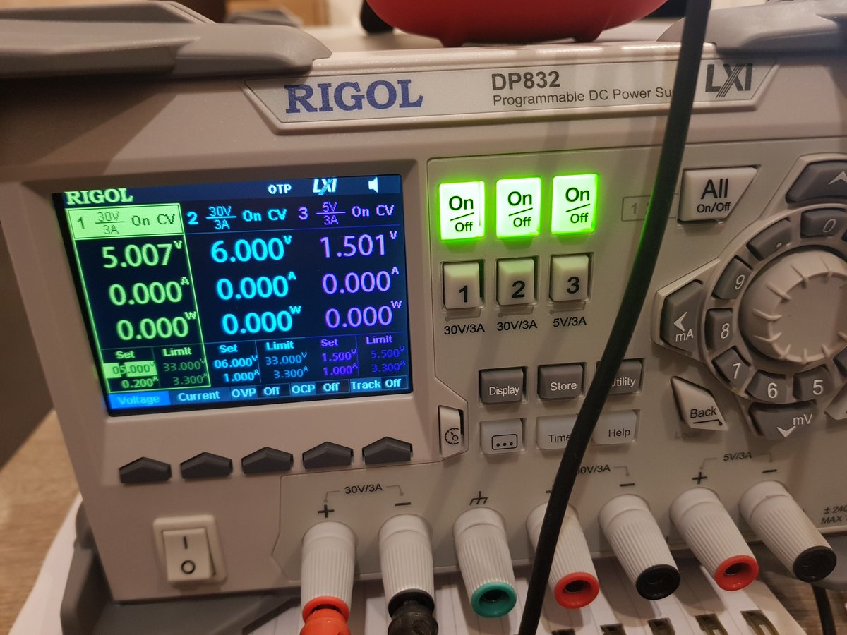

Author Topic: Need help hacking DP832 for multicolour option.  (Read 223637 times)
Offline marshalljmp
  • Posts: 2
Re: Need help hacking DP832 for multicolour option.
« Reply #325 on: September 13, 2019, 03:41:22 pm »

Is there any way to set the DP832 to be DP832A while keeping the 7-segment display as is?
I only need to try the hi-res option to be honest and kind of like the 7-segment display better than the smooth fonts..
So would it be better just to enter the riglol code for "accuracy" instead instead of performing the model change?
Only reason I considered the model change is that it's reversible.
« Last Edit: May 30, 2020, 03:17:52 pm by belzrebuth »
Offline RoGeorge
  • Posts: 7960
« Reply #342 on: May 30, 2020, 04:55:08 pm »
You can not have DP832A with 7 segments font, but you can unlock the high resolution option (or any other, or all options) for the DP832, without turning the instrument into a DP832A.  Unlocking the options is different from the method used here.  Search for "Riglol" to find the key generator.
As a side note, the 7 segments font is very hard to read when compared with the fonts of DP832A.  I used to think those 7 segments digits were cool, but the DP832A normal font is so much easier to read that I wouldn't want to go back to seven segments font, ever!

I'll check both options when my replacement DP832 arrives (I've had a bit of adventure getting a defective unit so I'm in the process of getting a replacement).
I could first try changing the model to DP832A to check the smooth font color screen,if I decide to keep the "A" version I would effectively have a "new" screen and only the high-res option enabled but not the LAN and RS232, correct?
I would then need to unlock the other options within the riglol generator right?
BTW what is the accuracy option "MWTB" for the DP832A?
Isn't this default to all "A" units?
Offline RoGeorge
  • Posts: 7960
« Reply #344 on: May 30, 2020, 06:38:32 pm »
AFAIK DP832A have all the options enabled by default, including LAN and RS232, so no matter what options were installed before on a DP832, when you turn it into DP832A it will also unlock all the options.
« Reply #345 on: May 30, 2020, 07:01:43 pm »
I know the fonts are nicer on the DP832A but it does have a display mode that looks like the single-color display on the DP832 (you can choose the single color on the DP832) but, on the DP832A, the 3 sections are color-coded to each supply plus the fonts are cleaner.

Online PA0PBZ
  • Posts: 5381
« Reply #346 on: May 30, 2020, 07:19:10 pm »
I use this setting:
« Reply #347 on: May 30, 2020, 07:59:01 pm »
Okay you've convinced me. ^-^
So no Riglol at all with this unit..
Just a model change and we're done. (all the options plus the clearer screen)
I know it's been said before but since the DP832 doesn't come with the LAN I guess the SCPI command is to be executed via the UltraSigma software, yes?
If so I need to be on a Windows PC to do it.
Offline RoGeorge
  • Posts: 7960
« Reply #348 on: May 30, 2020, 08:24:04 pm »
No.  All the hardware is present in all units.  DP832 or DP832A are identical in hardware no matter what options they had at the buying moment.  You will have both LAN and RS232, and LXI and everything, and in either case you won't need ultra sigma anyway.  Nobody uses that.   ;D
The only difference between a DP832 and DP832A is the front panel that is painted in many colors for the DP832A version.
You'll have everything possible like it would be with the most expensive DP832A.
Stop warring and in the meantime read the user manual and the programming manual, or even better before the manuals (if you plan to control the power source remotely) search online for introductory info about the SCPI standard.

« Reply #349 on: May 30, 2020, 08:30:00 pm »
No, I mean in order to initially get my DP832 to change to the "A" model wouldn't I need to connect it w/USB in order to send the command?
Since it won't come with the LAN option enabled I can't just insert the USB drive, connect it to my LAN and nc or telnet the command into it..
