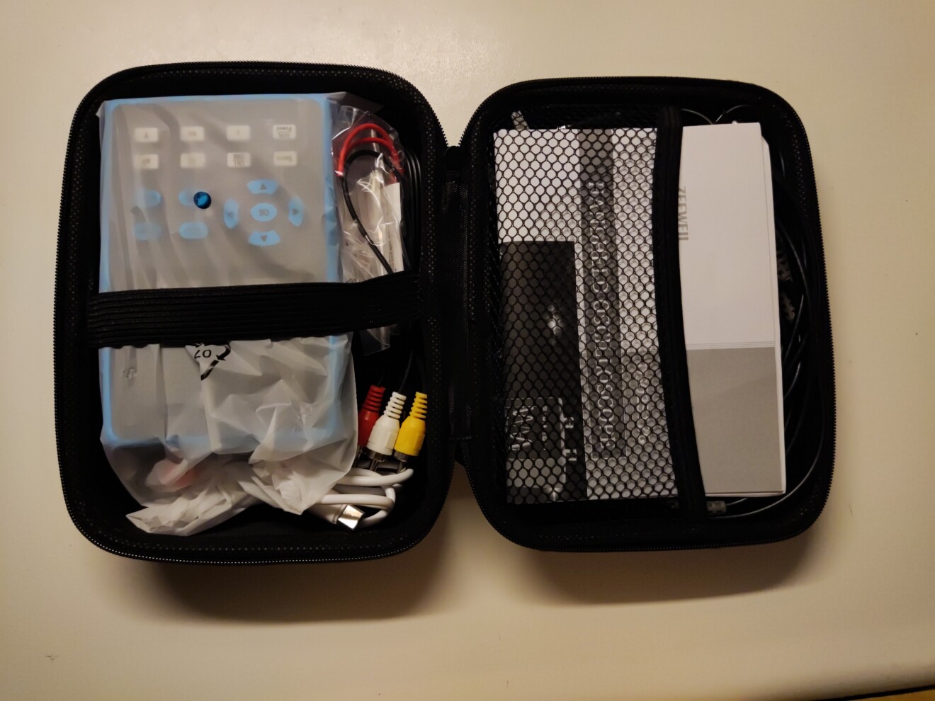

It arrived to the NL in 10 days instead of the estimated one month! Good :-)
Some pictures:

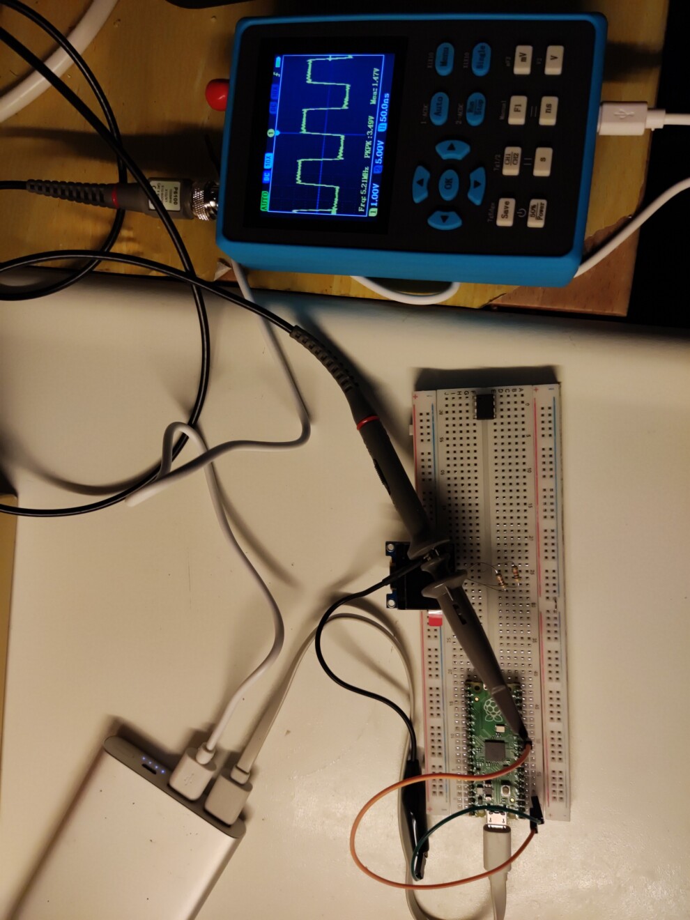

Since I don't have a signal generator, I programmed a Raspberry PI PICO's HW state machines (using the pio_blink example) to emit 5.2MHz on GPIO0 ...
...and then, 21MHz:
I doubt I will need to go that high in my tinkering, but it's good to know I can see something from a 21MHz signal.
I plan to use more GPIO pins and an R/2R ladder to generate an analog custom waveform driven with the very nice Pico's HW state machines.
Will update here when I do.
