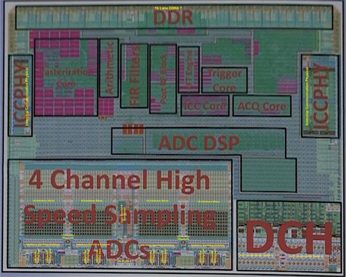

Tek049 Chip: 4ADCs, 8 AnalogChannels, 18 DigtalChannel ???
« Reply #675 on: June 21, 2017, 09:22:41 pm »
I take a closer look at the chip plot. It show some layers below the top-metal which contain the pads for the high pincount ball array.
The board photo indicate one chip for each channel. But from the plot 8 differential analog inputs could be identified and 4 ADCs groups each with a possible interleave factor of 16. In addition each chip contain 18 complementary digital inputs.
My guess is that this Tek049 chip is designed to be applied also for low-cost instruments where each Tek049 could serve minimum 4 analog channels and 16+2 digital channels. So the Tek049 seems to be a platform chip for the 5-series and everything below.
What is your thought?

Re: Tek049 Chip: 4ADCs, 8 AnalogChannels, 18 DigtalChannel ???
« Reply #676 on: June 22, 2017, 05:19:54 am »
Yep, I noticed that too.
A 12bit 4 channel muxed 500MHz MSO based on this would be nice.
