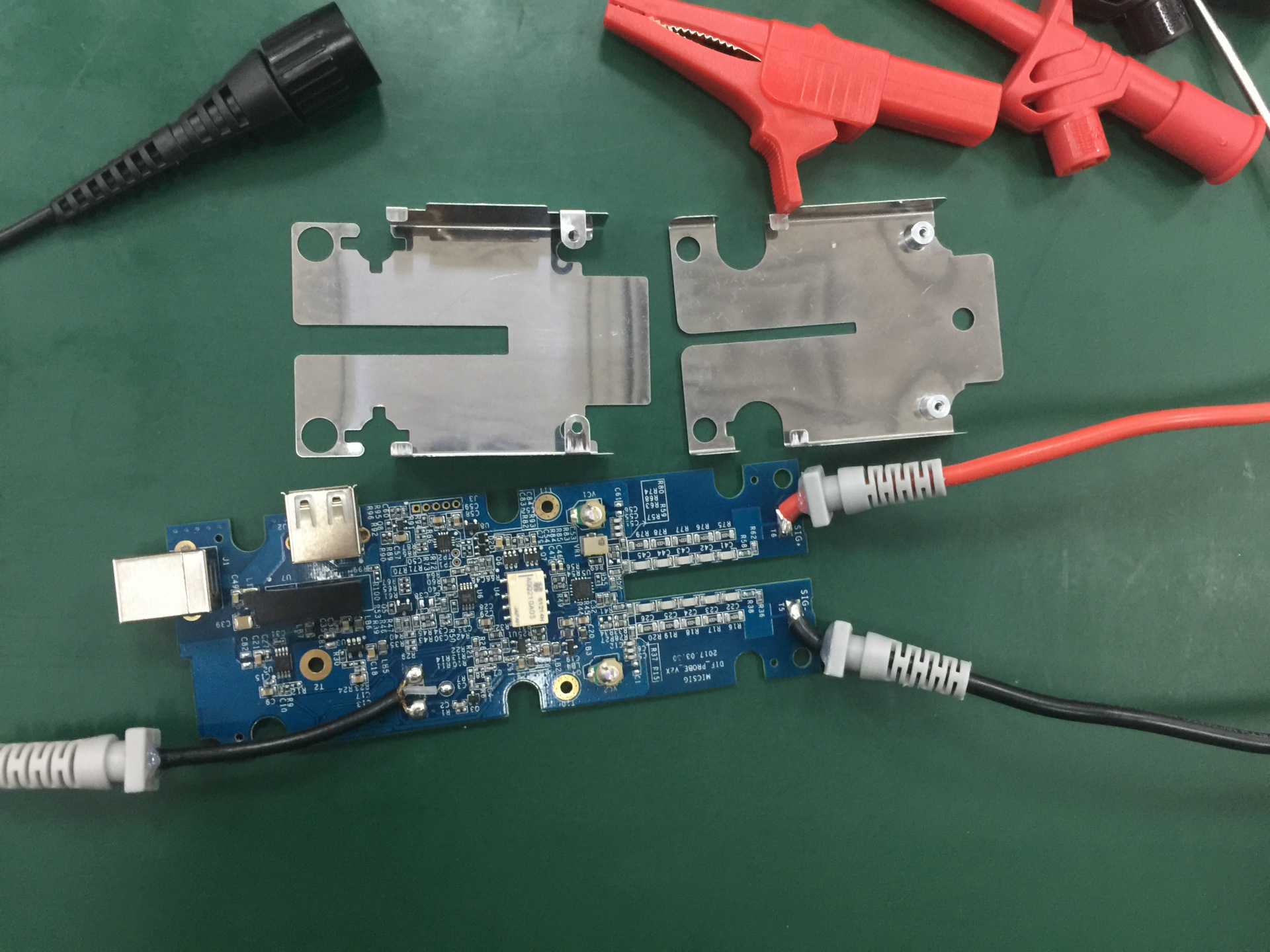

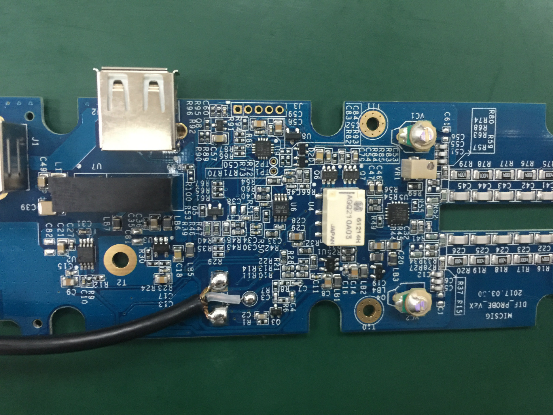

From the pics it looks like the front end is handled by one of these:
http://www.analog.com/media/en/technical-documentation/data-sheets/ADA4817-1_4817-2.pdf
Won't be able to confirm until better pics come along or mine arrives though.

The USB jack on the side is labeled power output but do they feed both power and data thru to that jack so that you can plug your thumb drive into it when the scopes USB jack is occupied by the probes "power cable"?

@Jacklee: do you have a picture of the solder side of the board? I'm wondering whether the USB interface is fully routed so you can plug a USB stick into the probe.

From looking at the PCB picture there are a few things which might make changing the gain of these difficult:
- The input divider is only 5x SMD resistors/capacitors. This will be difficult to run at higher voltages than 1.3kV (look at voltage ratings of SMD resistors - even special HV ones do not have high voltage ratings)
- The gain change appears to be done after the input stage. If the input of the ADA4817 is at the limit of it's common mode input rating at 1300Vin then the input divider ratio would have to be changed, rather than just the gain resistors for the range you want to modify.
- Other than the trimcaps/pot on the the input (for CMRR) all other trimming (for offset etc) seems to be done digitally, probably during production. If this varies with different ranges then it could be tricky to get right if you change the gain of one range.
That said, hopefully it doesn't end up too hard to mod these - personally I'd be interested in changing at least one to 20/500X for (hopefully giving lower noise on small signals)
I'm a bit confused myself as to how the gain switching is being done - there appear to be 2 different sets of series resistors between the input and output amplifier stages (switched via the relay) but this would be a nightmare to match for correct CMRR, so I'm not sure how it's being managed or if I'm completely wrong in my analysis. Has anyone got any ideas? I second the request for solder-side.

Request:
Please identify U7.
Online nctnico
  • Posts: 28196
    • NCT Developments
Re: New low-cost ($170) 100MHz Differential scope probe from Micsig
« Reply #71 on: July 18, 2017, 07:49:20 pm »
Request:
Please identify U7.
Looks like an isolated DC-DC converter.
Offline Floyo
  • Posts: 90
« Reply #72 on: July 18, 2017, 07:50:41 pm »
For the price/introduction deal they seem pretty good. I like the USB power option, the supplies are just so ubiquitous, there are probably at least five sockets around the bench at any time. I have the Pintek DP25 with its center negative 9V barrel jack, and that is slightly less than ideal for a few reasons.
It looks to me like they used an isolated DC-DC brick for powering the probe, there seems to be a lack of traces between both sides of U7,
possibly indicating isolation. But then the data traces of the "host" USB-A port seem to sneak off to R99/R100 right close to the "secondary" circuitry, so that contradicts the isolated theory.

The input resistors shouldn't be a problem, both the voltage rating and power have to be considered. There are hv smd resistors, easy to buy 3kv ones at 2512 size, 1kV @1210 . At 2500V input however 5 1Meg resistors in series will dissipate 250mW each and those in the picture don't seem big enough. The input compensating ceramic caps would need to be upped in voltage rating too
The gain setting is another story of course that will have to be studied. I hope that it is not fixed before the diff amplifier as you mentioned, that would be weird.
The frequency compensation that goes along these dividers will get affected too and a before/after comparison in a network analyzer will come in handy.
This is something Ill look into as I'm very interested in having the input limit raised to about 2500V
