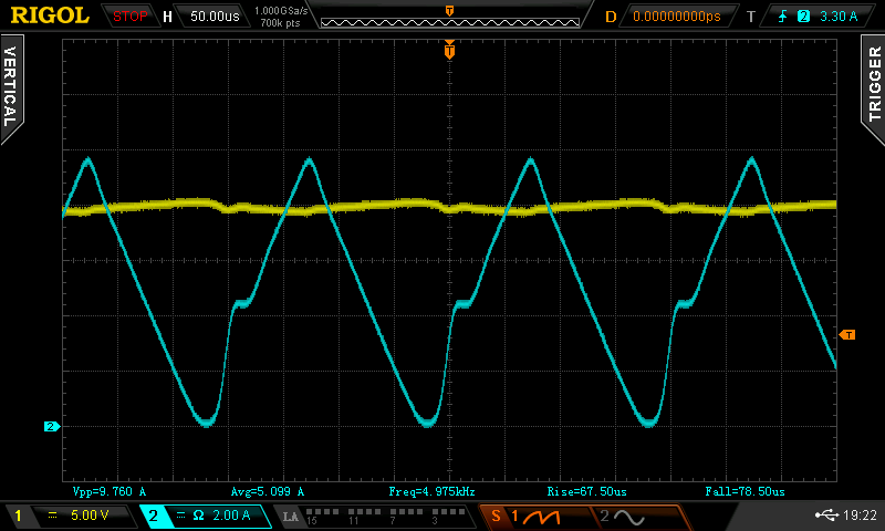

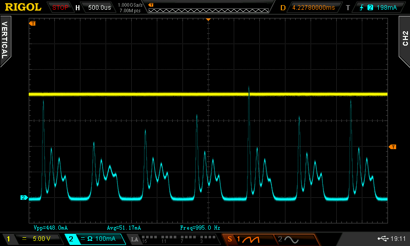

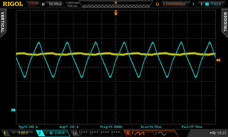

...did some more testing of the DL3021 last weekend and as MotoDan reported, the instrument should probably have undergone some more testing at Rigol´s labs before being released to the public.

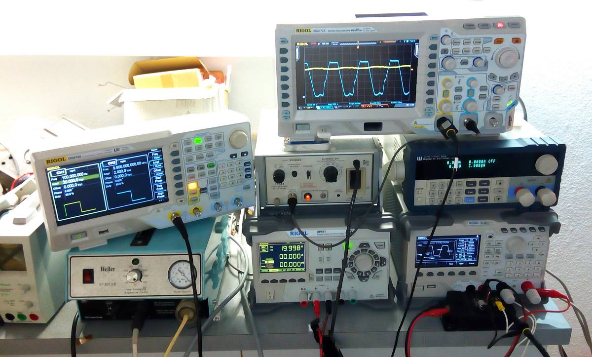

Here´s the setup I used:
Basically I stacked a lot of Rigol gear on the bench (Power supply @ 20V / 10.5A, Oscilloscope, MOSFET switch, function generator to provide a square wave gate drive to the MOSFET @ 2kHz) and added my Maynuo load as a "spacer" to compensate for my venerable Tek P6042 current probe.
The current probe is connected to trace 2 (the cyan one) of the scope while trace 1 (yellow) displays voltage at the load terminals or across the MOSFET (as shown in the video further down).

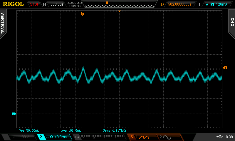

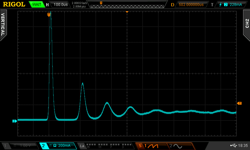

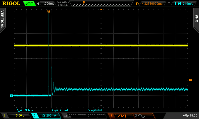

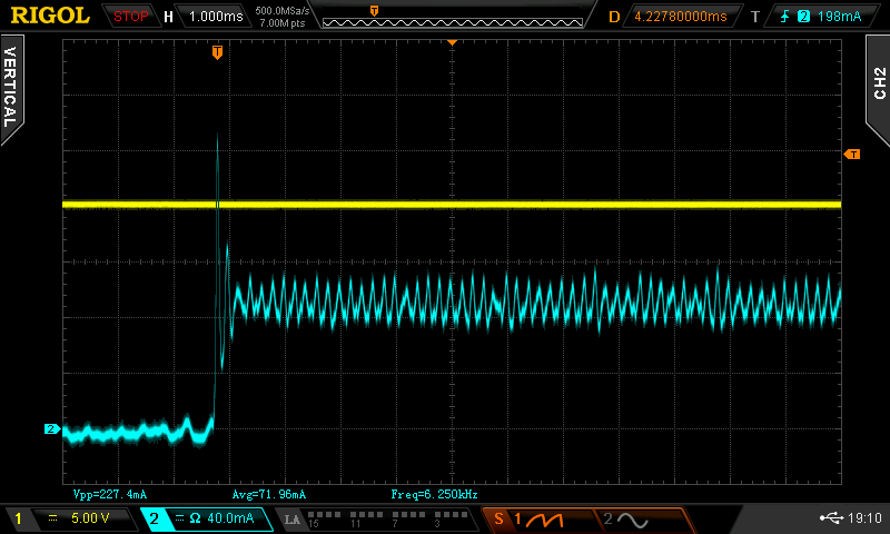

I started testing the load at low currents and especially kept an eye on manual on/off behavior and automatic toggling. Here´s what I found:
Manual on @ 100mA - a lot of "bouncing" and quite high initial current @ almost 1.4A. See below with a different time base.
Once the average current has stabilized, there´s a residual oscillatioin of 50mApp @ 4.7kHz:
If the load is toggling the current internally, the overshoot gets  a little better but the oscillation is still there. Once again CC 100mA , first toggle frequency 100Hz and directly below 1kHz:
After this, I checked the performance of the constant voltage mode (CV), adjusted the load to 10V and the PSU to 12v and connected an 18Ohms resistor in between (like a classic zener diode circuit). The speed the DL3021 needed to settle is more than disappointing. It appears the load is emulation this mode with the passbank still in current mode while the digital circuitry slowly adjusts the current to provide the proper voltage drop. It takes round about 2.5 seconds for the voltage to finally settle. Unfortunately i forgot to cross-check this with the Maynuo load:

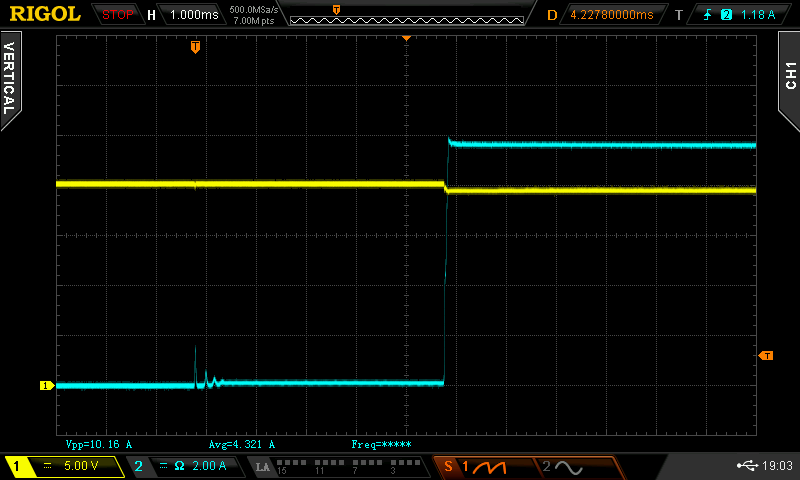

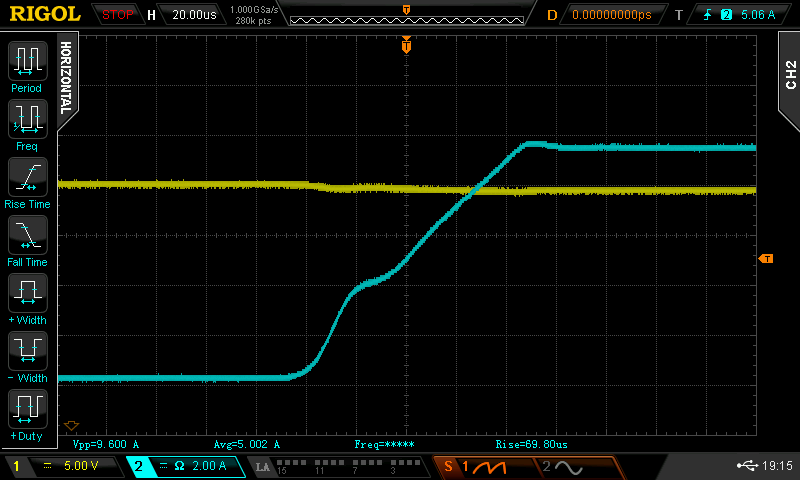

After that some more constant current testing at higher settings was due. 10A CC manual on:
The small spikes that start approx. 5ms before the current rises indicate the instance I pressed the "Load On" button. Rigol, WHY??!  ::)

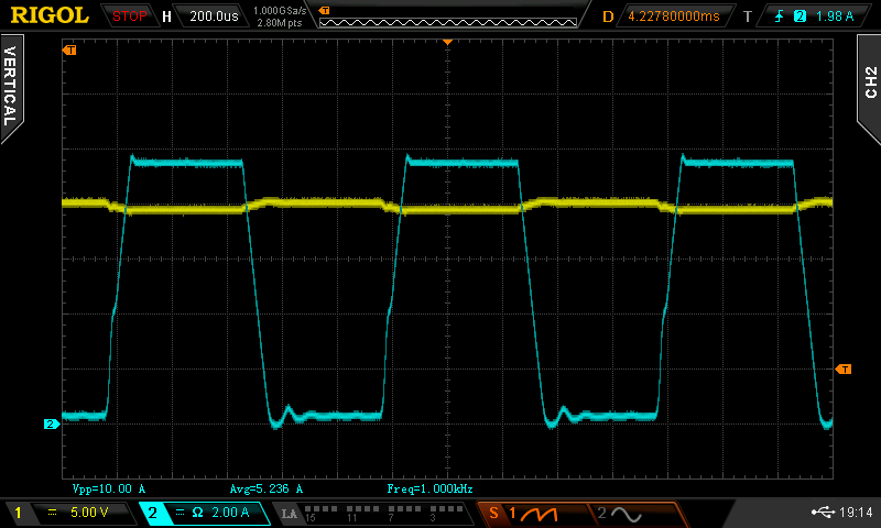

Now I tested some fast internal toggling @ 10A, frequencies in sequence 1kHz, 5kHz and 10kHz:
The optimist´s comment would be "at 1kHz it looks half-way okay..."  ;)

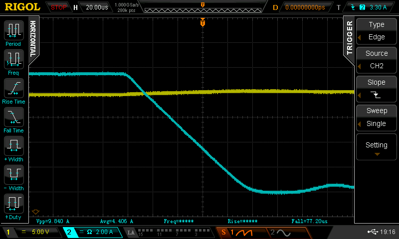

Rising and falling edges @ 10A and 100Hz internal toggling:

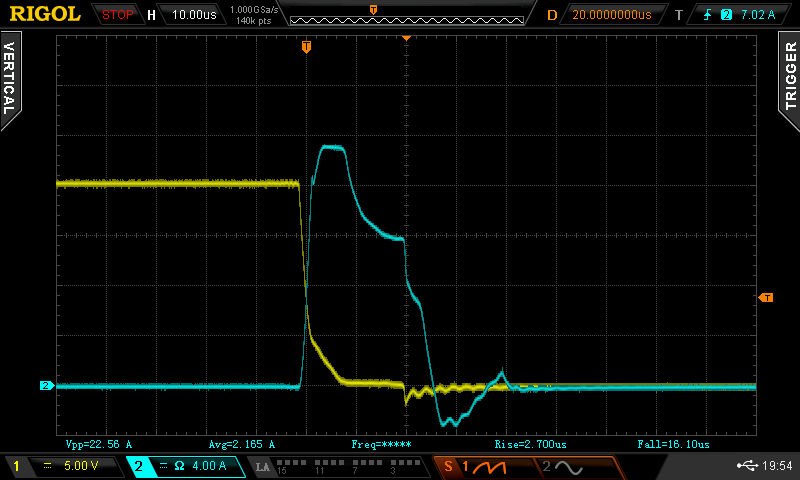

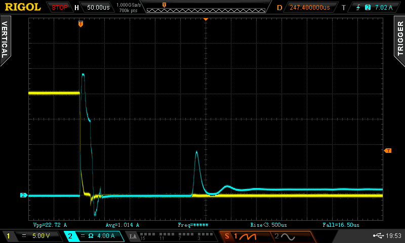

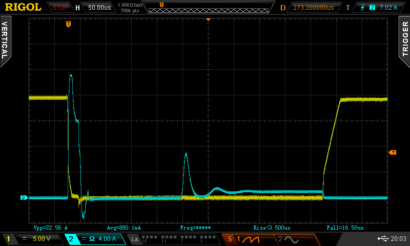

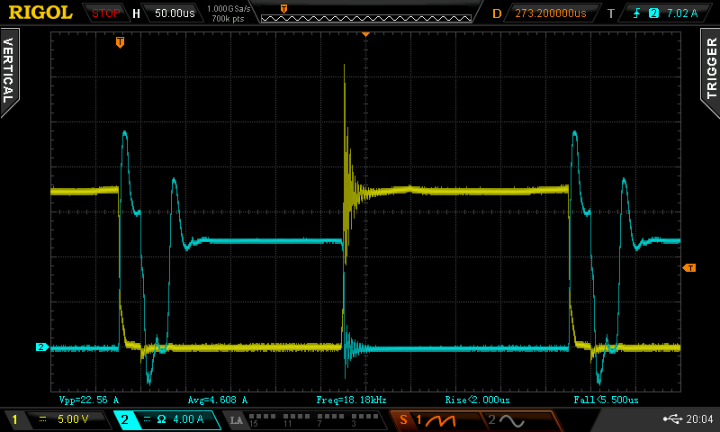

After that, I started what I expected to get ugly: Switching the current to the load externally with the MOSFET. Since the source of the MOSFET had to be ground-referenced via the square wave generator, I couldn´t probe the voltage across the load anymore (actually I could have by wiring the load at the FET´s source and probing at its negative terminal and inverting the channel on the scope but I didn´t consider this at the time...was somewhat in a hurry) so the voltage across the MOSFET is displayed. Setting was 1A CC, low frequency (about 10Hz) recorded at two different time bases
I guess the inrush current is much higher than the 23A displayed here due to saturation effects of the TEK current probe.
BTW, the Maynuo load doesn´t perform much better in this test (no screenshots available).

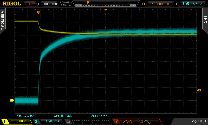

After these tests, the DL3021 was due, and what should I say -- in some cases, I cannot even interpret my findings. In general it seems that Rigol ATTEMPTED some "adaptive" parameter matching but I would say there´s still a considerable distance of road for Rigol to travel in order to come up with a useful result. I tried to duplicate the tests I did with the Maynuo M9712 load before but it turned out that in most cases, the frequency setting of the externally applied power that I used for the Maynuo was just too much for the DL3021. So here we go, first test CV mode @ 10V, 18Ohms in series, 1Hz at two timebase settings:
The load needs some 200ms to settle within 5% of the selected voltage. It´s quite curious that the slope doesn´t seem to be an expenential decay but it rather seems to take much longer in the end to actually reach the preset voltage level. The 1Hz period of the externally applied signal doesn´t suffice to achieve that.
